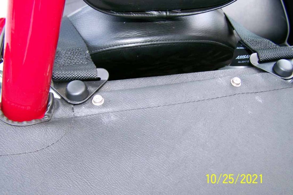

mrmustang Posted October 24, 2021 Share Posted October 24, 2021 (edited) I have five male snaps, equally spaced, screwed down to install mine, but I did have to carefully notch it so the bolts for the shoulder straps (not shown installed in picture) could stay in place. The front snaps are for the rear of the tonneau cockpit cover. I can take detailed pictures for you next weekend if you need them so you can get a better understanding of how it is mounted. Hope you find this helpful. Bill S. Edited October 24, 2021 by mrmustang missed part of description Link to comment Share on other sites More sharing options...

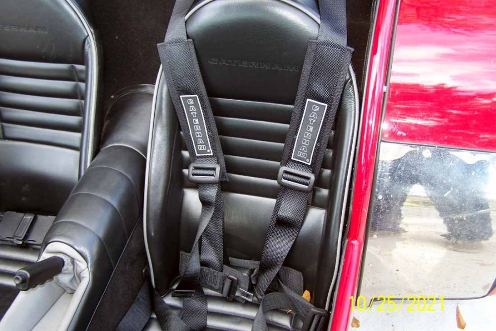

mrmustang Posted October 25, 2021 Share Posted October 25, 2021 Here are two pics I took this AM after a nice 30 mile ride in the sun. In picture number 2, the right shoulder bolt mount leather needs to be re-stretched-glued again, noticed that this AM. Oh well, not difficult to remove, just take the 5 stud screws out and loosen the 2 bolts holding the should harnesses to the chassis. Any questions, just let me know. Bill S. Link to comment Share on other sites More sharing options...

mrmustang Posted October 25, 2021 Share Posted October 25, 2021 22 minutes ago, ukchris said: So it’s screwed to the bar, correct? i.e. If you wanted to completely remove the boot cover you’d need a screwdriver to do so? That is correct, there is an aluminum bar located within the front of the boot cover as a stiffener. Could you uses snaps like you see to hold them to the body, I do not see why not, but they will not be a weather tight seal either at that point in time as the boot cover does not overlap towards the rear bulkhead/firewall area. Not in the self built cars, not on the factory built cars, both for a reason.The shoulder harness bolts loosen so the bar and the finish material can slide under the spacer for them. They can then be tightened to hold the bar and material tight as well, if you want to remove the mount spacer so they do not swivel like I have them. Bill S Link to comment Share on other sites More sharing options...
