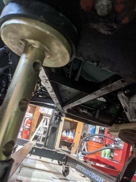

Whit Posted November 25, 2021 Author Posted November 25, 2021 Thanks for the info, I believe the structure is very similar, though a little wider and longer. There's lots of structure around the front suspension and a couple spots that could possibly be used to place the stands but the rear structure is hidden by aluminum panels. I crawled around last night looking for signs of previous jack stand locations, found nothing obvious, except for the bottom of the differential looks like it was the lifting point...
fastg Posted November 25, 2021 Posted November 25, 2021 Mine is a solid axle Locost. I life the rear by the diff housing.
Whit Posted November 25, 2021 Author Posted November 25, 2021 That saved a thousand words! Do you lift the front or rear first? Or work your way up to what looks like full lift on those stands? I appreciate the assistance.
fastg Posted November 25, 2021 Posted November 25, 2021 Front, rear, front. Front up about 2/3 of required height. Back all the way up, back to front to finish the deal. I normally put the fronts by the front suspension suspension mounts, but I have taken the engine out and needed extra room for the cherry picker. Graham
