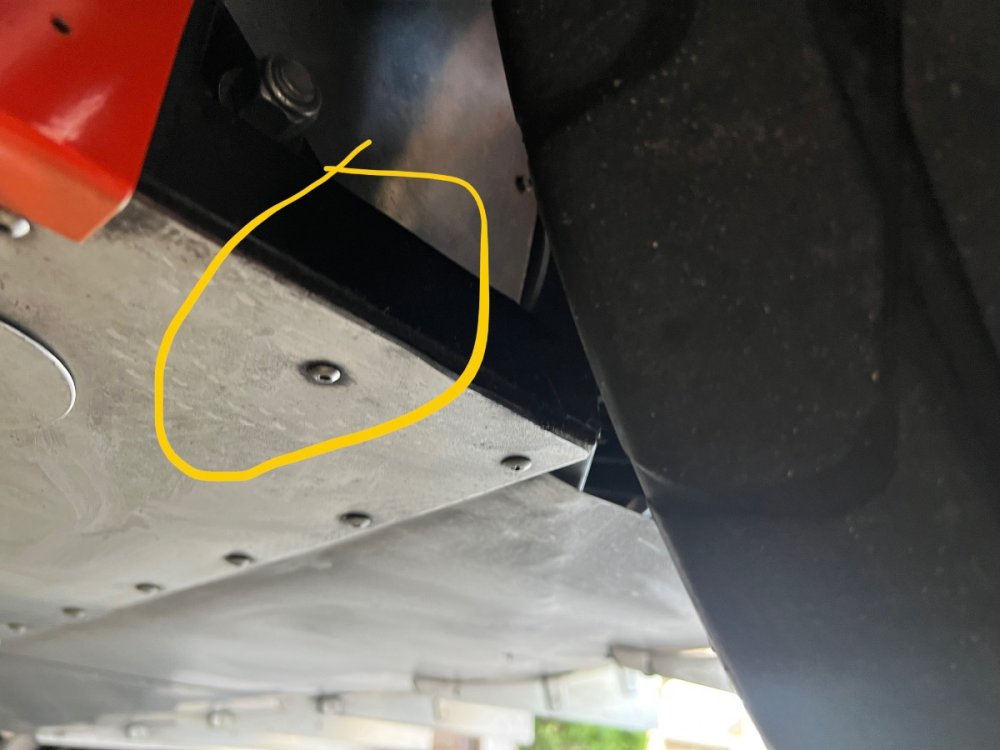

BruntonStalker Posted June 3, 2023 Author Posted June 3, 2023 (edited) Thanks @MV8. Should I be able to put a piece of wood in this corner and Jack it up or do I have to remove the sheet metal pan? Edited June 3, 2023 by BruntonStalker
MV8 Posted June 3, 2023 Posted June 3, 2023 Yes. No need to remove the skin if you use a block of wood across the corner that will lift on the rocker rail and the cross rail.
