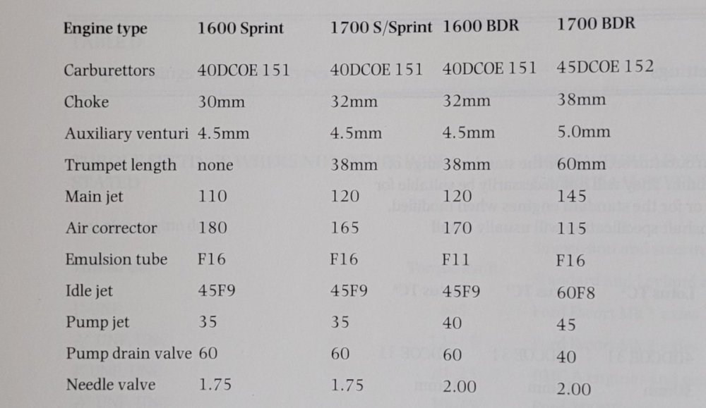

IamScotticus Posted September 3, 2023 Posted September 3, 2023 See this from Tony Weale's excellent 7 Bible
John Lehnen Posted September 3, 2023 Author Posted September 3, 2023 It's great when things work out... The 1700 S/Sprint is exactly what I had decided for Test 1. I ordered the 45F9's earlier today from Pegasus! Thanks for the chart... J
IamScotticus Posted September 4, 2023 Posted September 4, 2023 (edited) I have to renig on my 151 numbers, I never got into my 151s. I got into my (was a) 32DFM. I can get my 151s numbers in a while, but I suspect they will be the same as Tony's chart. Edited September 4, 2023 by IamScotticus
