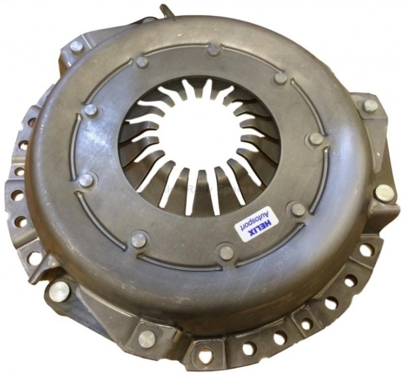

7.5" clutch.  I am looking to get a fresh clutch cover, or pressure plate. I understand (it took a long time to learn this) cable operated and hydraulic operated clutch require different clutch covers. Or more specifically,  the thrust bearings do.
The cable clutch will typically have a flat faced thrust bearing on curly spring fingers or platen topped fingers, and the hydraulic will have a donut faced bearing on flat faced fingers.
Mixing these should be avoided,  but staying with cable,  I have the two options, curly finger or platen.
Which is better?
Curly
Platen
Pics from QED and west wales rally spares
