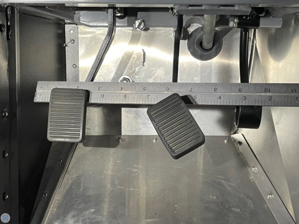

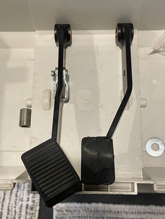

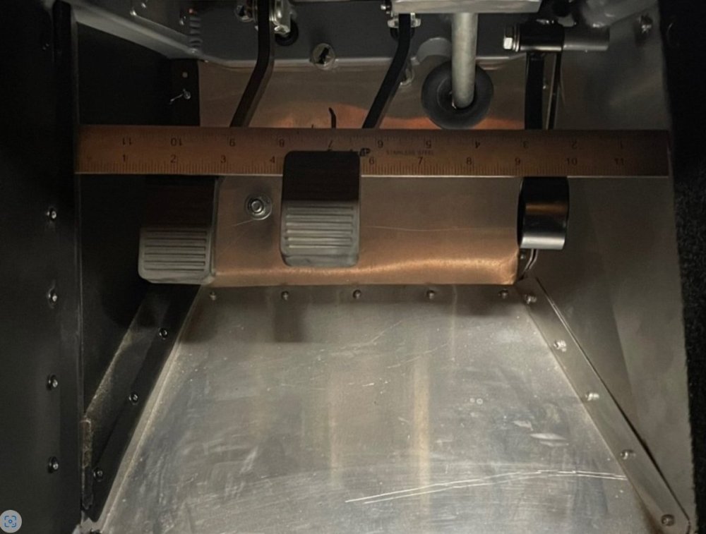

Hi, I’m not sure how widely this applies, but I figured I would share. Ever since building my CSR I found the pedal spacing to be terrible. I could barely fit my shoe between clutch and brake, and this made heal/toe impossible. Frankly I don’t understand why Caterham would do this. My best guess is there is some regulation somewhere about the distance between brake and throttle pedals, but how could that apply to a kit? Anyway, my solution was to bend the brake pedal back to nearly straight. I believe Caterham sells straight pedals, but it was easier to source a factor pedal and bend it. I took my first drive with this over the weekend and it is definitely better. I’ll need some more time to perfect my shifting, but at least my right foot can finally reach both pedals. Daniel

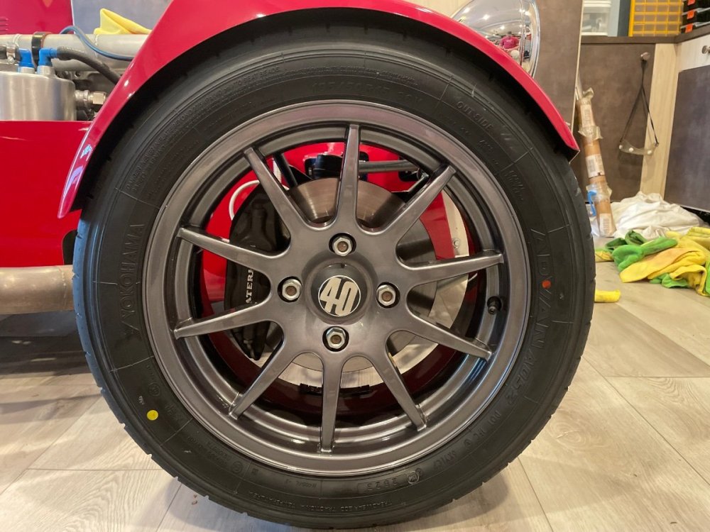

Coming back to this as I finally changed the tires. I decided to try tires that are more widely available than Avons. Details below. The negative of this is I did have to use different front and rear compounds, but I don’t think it’s crazy. My wear rates on the rear are clearly higher than the front and the front tire I chose should be a little softer. The other change from the CR500’s was front tire size. I think this change was also true for Avon ZZS/R options. I was happily surprised that the bigger tire fit without modification to the fenders (albeit it’s close). I took my first blat around the canyons over the weekend and first impressions are positive. For sure the new rubber is doing a better job than worn out old CR500’s. That said, I wasn’t able to induce understeer (thankfully). The balance was quite neutral, but I did over cook a corner a bit and was braking more aggressively into the corner than I would have like. This did cause some rotation on the rear, but it was very manageable. So far so good, only thing left to do is put more miles on them! -245/40/15 bfg rival s1.5 -195/50/15 Yokohama a052 Daniel
