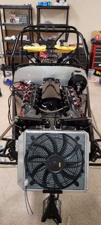

Vipergeek, I am using a Maradyne High Performance Fans M142K Champion Low Profile Series Fan that is 14" and reversible in front of a custom radiator sourced by Stalker Cars. Since I will be using this for autocross, I will be installing a 160 degree thermostat to get my engine warmed up quickly for autox duties. I am not sure what your EcoBoost needs for cooling? The nose area of a Stalker is fairly small and cooling is a bit challenging because the radiator has to be tilted backward for hood clearance. IIRC, your EcoBoost engine is mounted significantly differently than any M-Spec Stalker that I have seen or owned and so my setup may not be helpful for you? I know when I run LS3's in the Stalkers, the engines are designed to run hotter (about 200-215) than the older school engines. On this build, I am including an overflow tank (2.5L Universal Aluminum Coolant Radiator Overflow Expansion Tank Reservoir Recovery Water Tank Bottle) that you can get on Amazon.

G'day Croc! The AXR is currently being reassembled. Most of the suspension, foot controls are back on and I will finish installing brake lines by the end of this Memorial Day! I will also finish mounting the center console to accommodate the 5-point seat belt harnesses today. Then, reinstall the floors and rear cockpit aluminum sheet metal. At that point, the LS1 engine, GForce transmission and drive shaft will be installed and coupled to the 8.8 Ford 3.73 LSD rear end. Then the task of wiring and connecting up the engine accessories, fuel tank, etc. will commence. The body work (bright red) is at the painter's shop and should be completed in the next week or two which coincides (hopefully) with my ability to install them. I have the tires (Avons) but am waiting on the front/rear wheels and that should come in the next couple of weeks. Hope to have a trackable car by early July. Already have the Aluma 14" tilt trailer with brakes in my neighbor's garage. Thankfully, my neighbors only occupy this second home for the Winter golf season. -

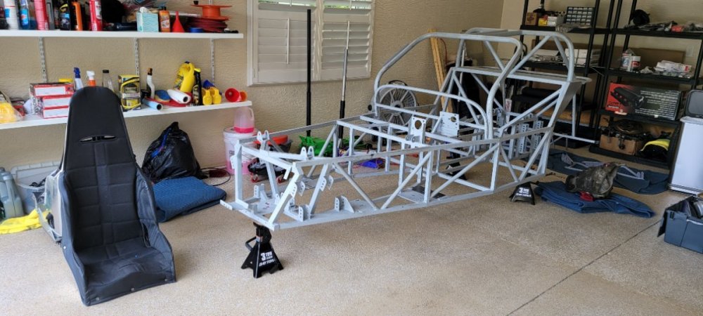

With a lot of help from my racing buddy and a bunch of sweat and calculating, we finished the fitment of the AXR body panels, pedals, etc. and began the deconstruction yesterday and completed it today. The chassis and body panels will be going to the painter later this week. If it were not for my friend, I am afraid that I might have drowned in the deep end not really knowing the proper way to do things even though Stalker Cars provides excellent sequential step-by-step videos developed and presenting Scott Minehart as he explains the compartmentalized tasks. I have realized that there are many gaps in my limited automotive assembly capabilities and it is very helpful to get assistance from someone who is quite versed in construction techniques, especially with Stalkers and Miatas. I think if I had the opportunity to build several of these that the tasks would be significantly less daunting. Having owned a number of prior built Stalkers, I am extremely impressed with the quality of the chassis construction and how precisely things fit with each other.

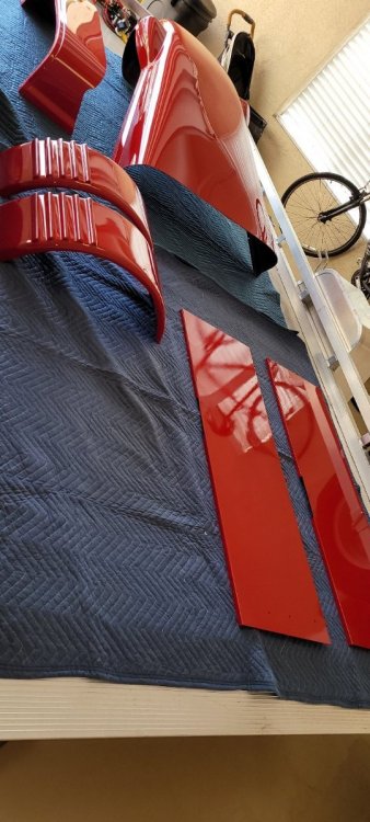

The rear deck lid and side panels atop the rear clip were cut and fitted today which took a surprising amount of test fitting and trimming. With patience and some great tools, the job was completed. We removed the racing tires, put the car back on the roller wheels and will do a complete deconstruction of all the loosely assembled parts to get the car back to its native chassis and ready for paint. I will be very interested to see how challenging it is to remove the engine/transmission. It feels like the second phase of the build will be behind us when the components requiring paint go out the door. I am also pumped that my Aluma tilt trailer that I ordered a couple of months ago will be ready to bring home sometime late next week. I had planned to use that trailer to transport the chassis to the coater but may have to rent a trailer for a few hours to get it to the painter's shop. I have elected to not worry about scheduling a powder coat for the chassis because it would likely significantly delay the build/coordination toward completion and the paint shop will be using special hard automotive coatings that should withstand most of the potential abuse thrown at it with the reconstruction of all the component parts. Being that it is an open cockpit race car, it will not be subjected to rainy days if they can be avoided. I do not have any interest in learning how to drive with great precision on slick surfaces or with rain tires. That level of competition does not seem appealing to my old bones.
The AXR Stalker has the rear axle moved up 5" putting the weight of the driver more over the rear wheels. It is also designed to accept 13" wide rear racing slicks on the back and 10" slicks on the front. I will be running Avons front and back likely with Keizer 3-piece lightweight aluminum wheels.
