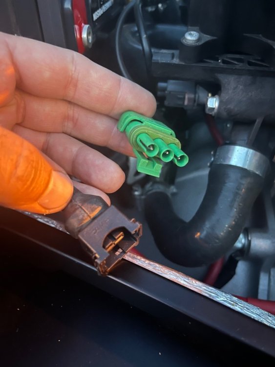

I don't see any MAP sensor anywhere so I don't think there is a MAP sensor on this sigma and its a dead plug they leave on the harness. found this info on another forum "The Focus MK2/MK2.5 with 1.4 and 1.6 Duratec (Sigma) engine do not have an Idle Air Control (IAC) valve or Mass Air Flow (MAF) sensor. The amount of air going into the engine is calculated by the PCM using a Manifold Absolute Pressure (MAP) sensor which is mounted at the intake manifold. This MAP sensor measures the air density. Combined with outside air temperature and engine RPM the PCM calculates the amount of air going into the engine. The idle control of this engine type is fully controlled by the PCM. The throtlle plate of the electronic throttle body can not fully close because it touches a springloaded adjustment screw. When idling the throttle plate is continuesly corrected by the electric throttle motor to obtain the correct RPM"
Need help identifying loose connectors on 310R sigma
Deman USA replied to Deman USA's topic in General Tech
I was hoping it was the issue when i cam across the same post last night but I do not see anywhere for the life of me a module or plug for this to connect to -
Hi gents im looking to see if these two connectors are needed and if so where they plug into online shows green connector plugging into an ecu but don’t see ok ein my engine bay
Thanks again to both you and Greg. You gents have been very nice to work with.
Good day fellow members and hope all is well. I recently purchased a 2020 310R with 1300 miles and in very good condition from Rick & Greg at Time Machine Motorsports, very polite, professional & awesome guys to deal with. Everything looked/looks great on it but I haven't been able to drive it since it was delivered and finally got a chance to last night,,,,,but returned it back to the garage 2 miles later. At full throttle (does not matter which gear) it starts cutting off power as if your hitting the rev limiter and sputters/flutters like a turbo setup when an intercooler pipe comes loose. Being this is my actual first Caterham I wanted to see if any of you have had or heard of this issue. I was searching in the middle of the night last night and came across that an immobilizer or TPS can be the issue here. Was told to disconnect the battery and touch the leads together to clear any faults. We only have 91 octane here in Arizona so was thinking of adding 100 octane to it to clean it possibly Any info would be appreciated so I can experience the joy in this beauty Any local Phoenix area members feel free to chime in with a good service center in the area Cheers, Dino
