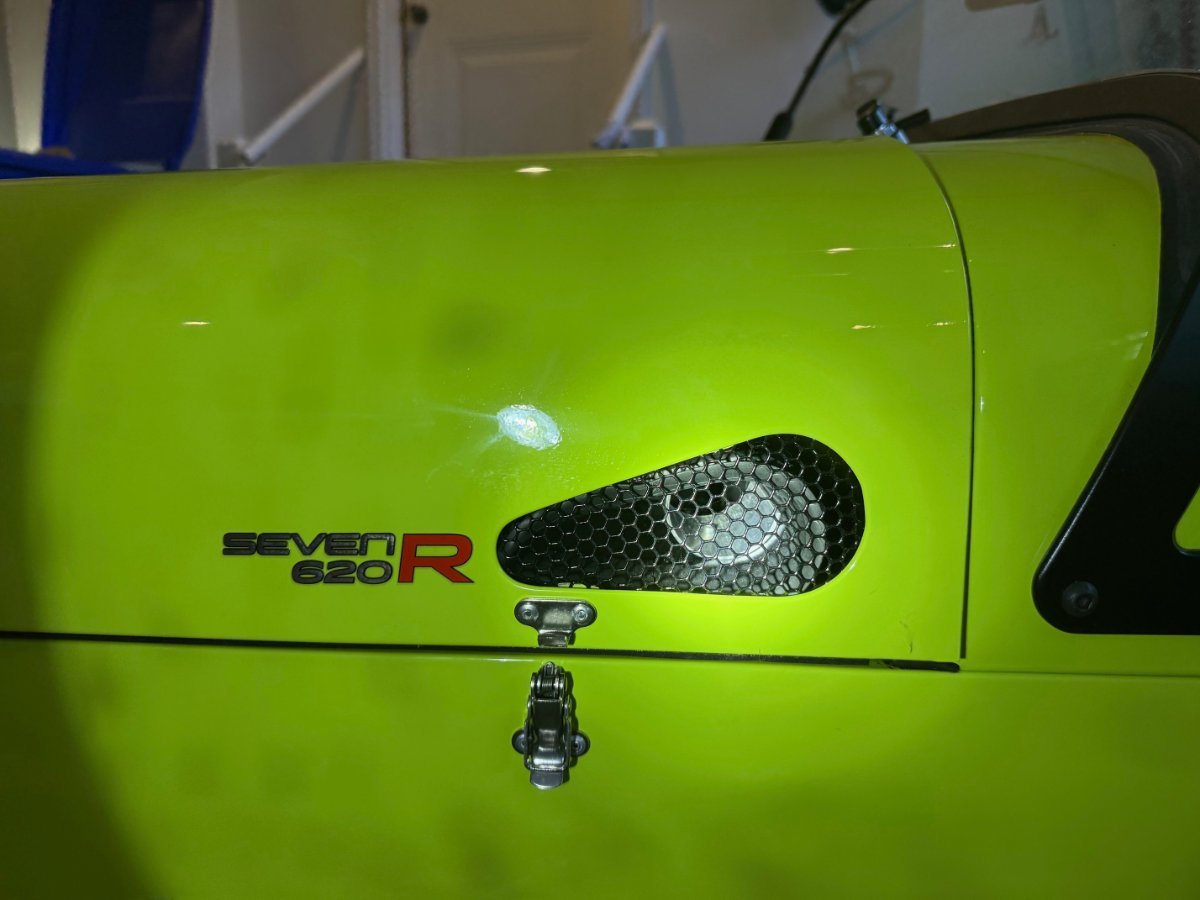

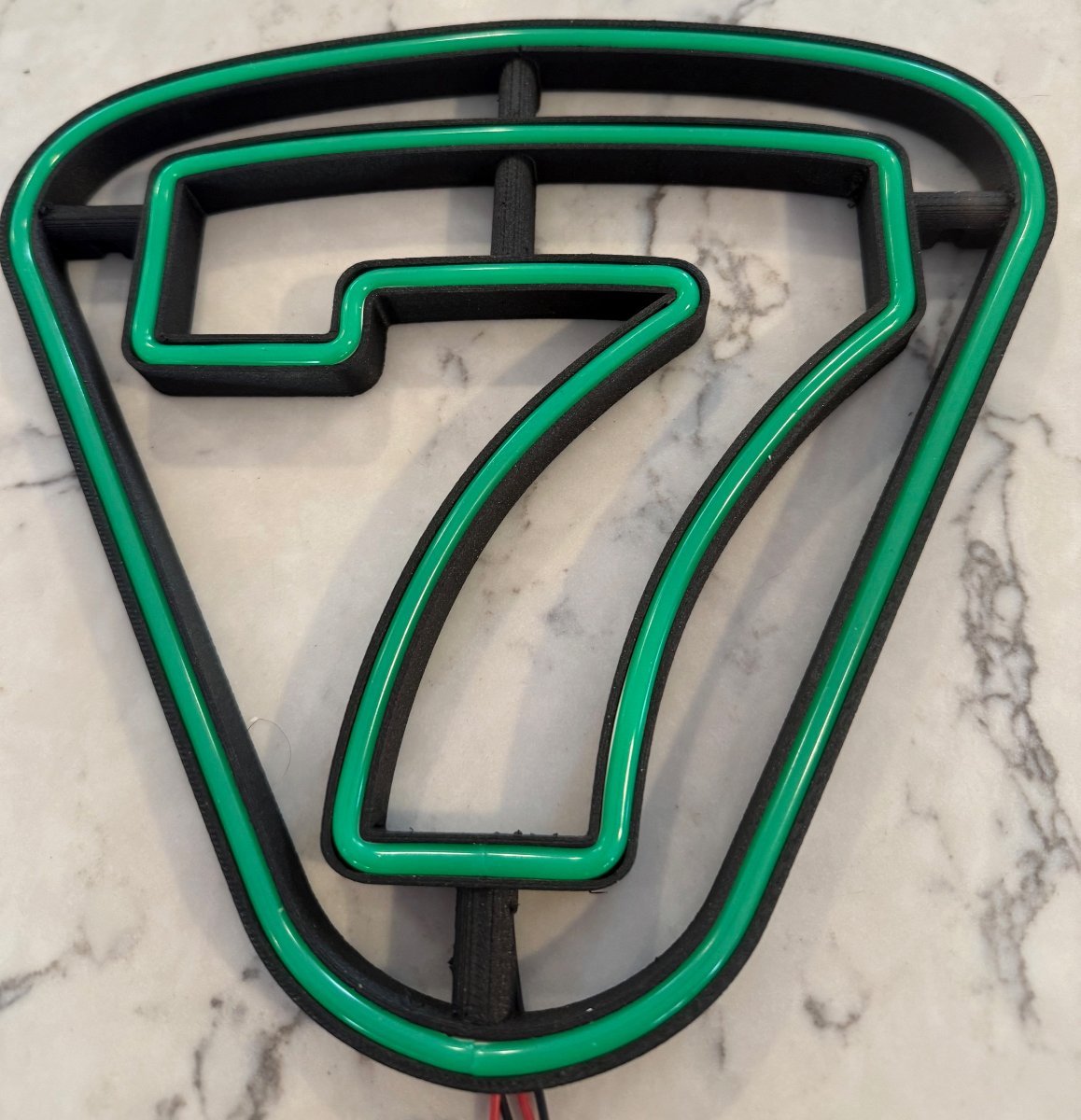

Oh My God!! Caterham 7 Front LED light ... we all need one!
pickles replied to pickles's topic in General Tech
OK ... I came across the YouTube video from James at ACaterhamCalledFern ... the link/email to the maker is in the YouTube summary. I contacted them and got the light in about 5 days. Have not fitted it but it looks good! -
Hi Just had to share this, it came via DHL about 10 mins back. Will Post further details once I finish a few tasks. Here's a couple of photos. Cheers Pickles

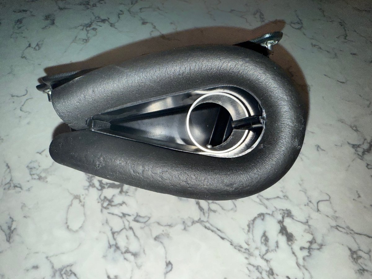

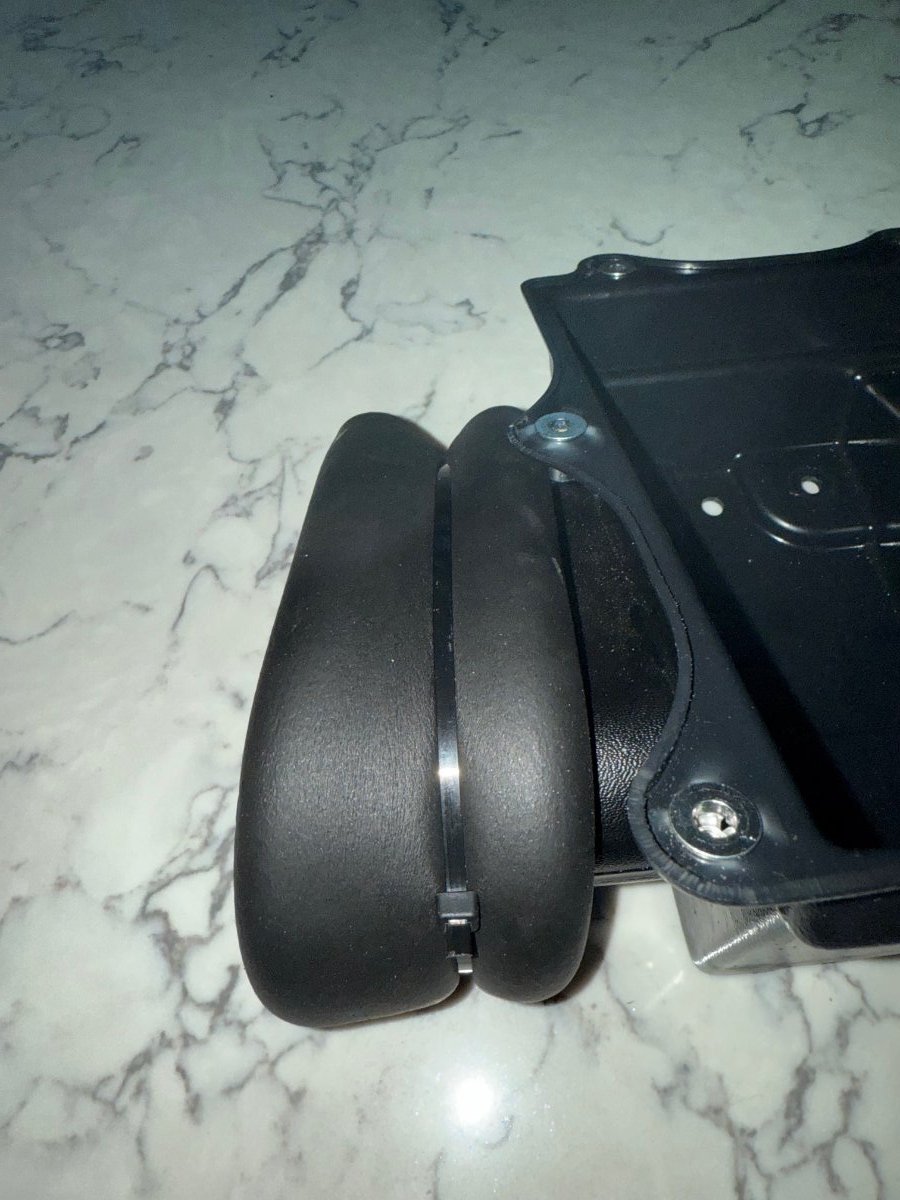

OK don't laugh, this is version 0.1(beta) Got rid of existing piece of rubber on the air-box, which was really not doing much. I went to Home Depot and got 1in. x 6ft Rubber Self-Seal Pipe Wrap. Grabbed a few cable-ties, and this what I got. Is it perfect, not yet! But is a better than previously? I would argue yes. It does make putting the hood back on a little more difficult but not by much. I think for version 0.2(beta) I will enlarge the 3 screw holes in the bottom of the air box where it attaches to the car, install some rubber grommets. May also play with some extra rubber washes to change the height/angle the box sites out for a better fit. (Plus, I have another 5ft of rubber tube to play with ) Pickles

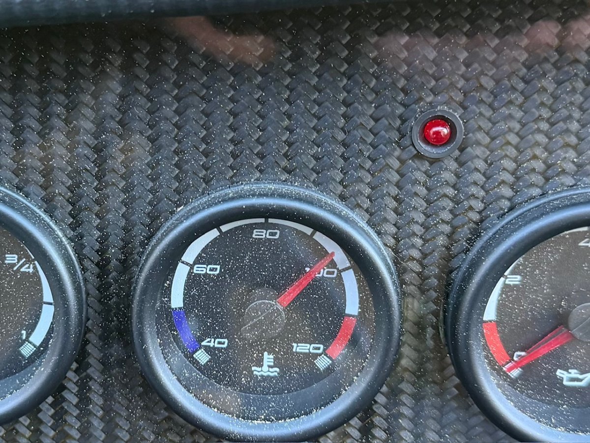

So have had running issues, sometimes the car would start and idle fine. And then for some reason it would be 'off to the races', jumping to 2K RPM and then hunting up and down. This would happen even if I were not in the car, so no change in throttle input (Well at least by me) Went over CarYenta's build post and followed his direction to play about with idle setting. Initially via Easimap, Throttle Site was reading 0.1 and the Voltage at 0.54V, would out the idle screw probably 1/4 of a turn, now sat 0.0 / 0.52V. After this have not seen the previous issue. Will need to monitor this, as I am only playing with car at the moment in my garage and driveway, and it is 34F out side, can't get it on the road until I do the dreaded CT DMV inspection. But onto the next issue ... a sticky Water Temp gauge! The two images below are taken with the ignition off. Also when idling the car and checking the cooling fan kicks in correctly I looked at the gauge and it was only reading 60C, turn the ignition off then on the gauge jumped close to 100C, which is where it should be for the fan to kick in.

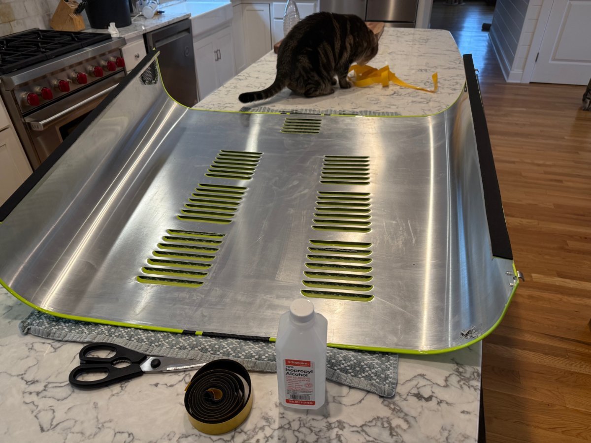

A little bit more effort, It is quite dense but will I expect squish down over time I used this:- Yotache Weather Stripping 2 Rolls 1" W X 1/8" T (New Adhesive Craft), Neoprene Foam Weatherstrip Tape for Automotive, 33 Ft Length (2 X 16.5 Ft Each) - Amazon.com It's about 3mm thick, I actually used it on another project and had some left over. For the PPF film on my 360, I did this: The nose cone, I took the original foam strip off, wrapped the PPF, over the lip where the hood meets it, and put a new bit of foam over the PPF to match the original. The Hood I did in 2 pieces, but did not do the louvres. My skills with PPF are not good enough! Will see this time as am sure PPF has moved on in the last 8 years. The sides back to the rear fenders. The front half of the cycle wings and half the rear. I put on the CF Bow protectors. (Bruce sells these) Also put foam on the possible contact areas where the nose cone mates with the main chassis. Lastly a small square of PPF under the gas tank fill. Cheers Pickles

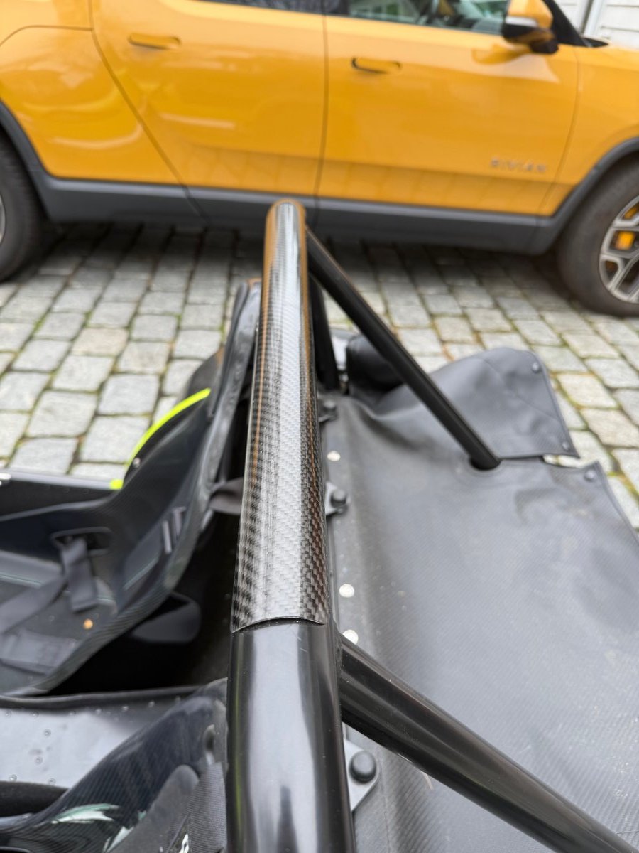

OK ... now finally have the car running. Moving on to Pickle proof the car, I am notorious for scratching and denting things, so I need protect the car from myself! First off, the rear roll bar, noticed on previous 360, passengers (Those mad enough to get into my 'Orange Coffin') would instinctively grab the roll bar and if they were wearing rings they would scratch it. So, a handy-dandy bit of carbon fiber with double sided tape (Because this car really does not have enough CF already ) And then some additional self-adhesive foam to the hood. (And to keep the cat engaged) Next will be adding some PPF in certain places.
