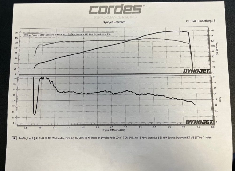

Yep. I found a dynojet As long as it's safe, I am fine at least for now, I am not too worried about powerrrrrrrrrrrrrr...
Update changed the spark plugs and went to a dynojet shop for dyno. This time numbers seems much reasonable. 160 who 130 wtq. But the shop is concerned about AFR seems to be very lean at lower rpm. Do you guys see the same? I see @SK400has similar AFR but that’s on roller barrel. Ideas? Thanks.
Plan to change spark plugs and redo a dyno on a dynojet with AFR. Any other idea on starting point for troubleshooting? The issue here is I don't have any shop who is familiar with Caterhams...
Hello @sf4018, thanks for the information! I am wondering if the dyno is the reason. Will try with some other type of dynos. Thanks!
May I know what kind of Dyno did you use? I am thinking to use another Dyno to verify now... Thanks.
