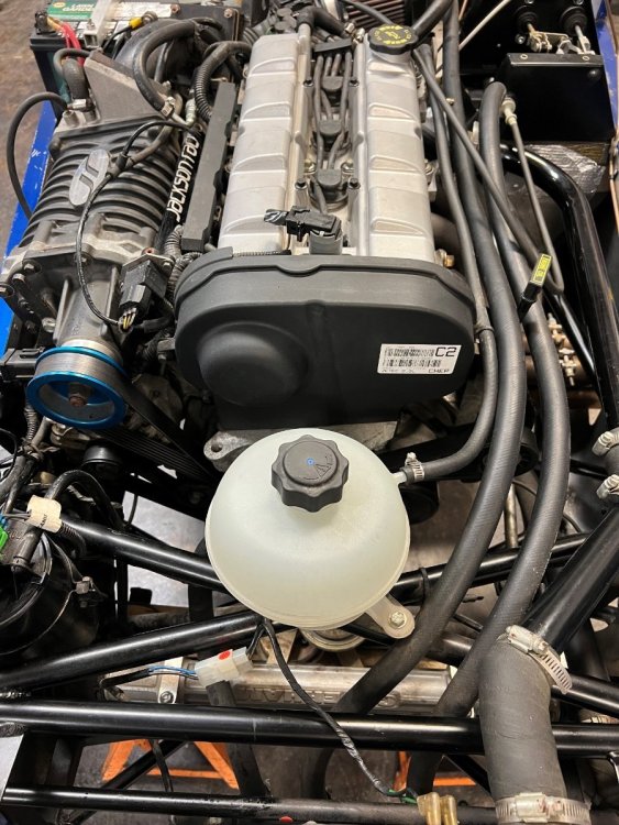

  6. @Vovchandr, here is the sound... I don't recall about the pully, but I'll check.

  8. I haven't dyno'ed it, but the PO/builder said 200hp at the rear wheels. It's a Zetec SVT (185hp), so with the SC (and based on feel), I suspect that is a conservative number.
  9. Yep. An SC setup fits into my Zetec SV.

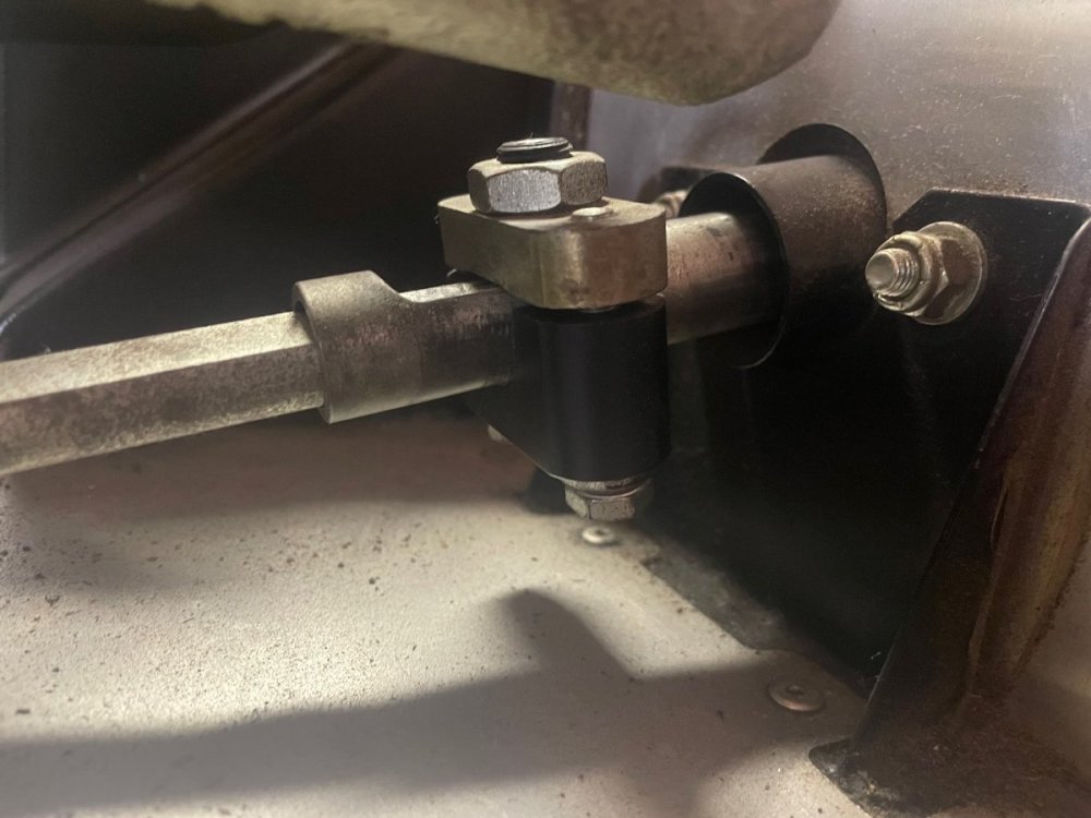

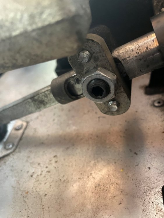

  18. Good question. That's the before photo. Here's the after, although not the best angle for your point. But, if you zoom in you can see that the two halves of the clamp now meet. The before photo was intended to show how loose it was. I loosened the grub screw/nut first, then torgued the clamp, then retightened the grub screw/nut. Let me know if you see anything suspicious in the after photo. Happy to take better ones. Thanks for your feedback.
  19. Reporting back on this topic... Many thanks to @CarlB, @jbcollier and @theDreamer for the feedback and to @JohnCh for the helpful build link. Indeed, the issue was the clamp connecting the upper and lower columns. The securing bolts were still tight enough to turn the column and wheels, but loose enough to cause the play I was feeling. They were loose enough that it took some time alternating between the two to get them to 14 Nm. I made sure the grub screw and securing bolt were also tight. This totally resolved the play and it's back to the feel I'm used to after test driving. I was surprised that the two securing bolts don't have nuts (although there is not much thread coming out of the clamp to put a nut on anyway). I checked the assembly manual and photos, and this is as it should be. Someone outside this forum suggested that I disassemble it and use blue loctite on the entire length of the securing bolts. I'm not sure that's a good idea for a clamp that might need regular tweaking. Alternatively, I considered getting two longer blots and use nuts. But, I sure don't want to end up with a cross threading issue. I plan to just keep a close eye on it, and if it gets loose again in a short amount of time, I'll consider how to make it more stable. Anyone here had an issue with that clamp frequently getting loose? Of course, correcting my bad habits of yanking on the steering wheel will likely help! To be safe, I got under it and checked the entire steering mechanism using the assembly manual and torque tables as a guide. Splines are all good. The only other thing I found was that the rack clamps needed to be torqued ever so slightly. So slightly that I really doubt that was causing any steering issue, but they are to spec now. Thank you very much!
