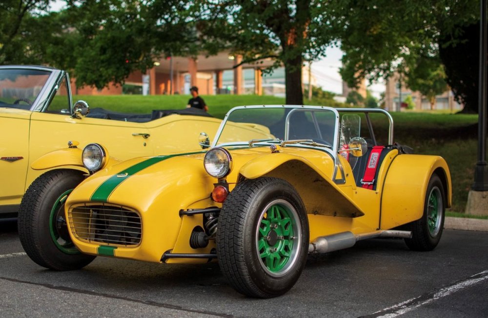

  9. Recently picked this up this little fella. Didn't know much about the history of Lotus and Caterham, I just liked the car! It's been a blast to take to Cars & Coffee, etc. It's something different so it always gets a lot of looks. I've also learned that Lotus people are a tight knit group! One note related to the car... many of the previous owners seemed to have been meticulous pack rats and kept all the paperwork, manuals, receipts, etc. It's like a time capsule for the car and its been much appreciated for background information. I love driving the care and looking forward to meeting fellow 7-ers!
