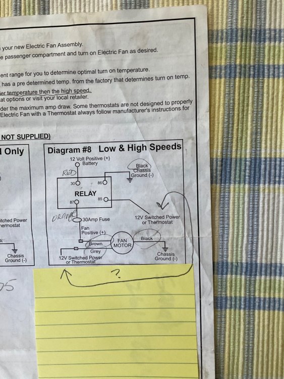

  3. I’m also attaching a picture of Derale wiring instructions (diagram #8) for comment. This diagram indicates only one relay. There are TWO 12V Switch Power or Thermostat connections, can both of these be connected to the heater fan switch?

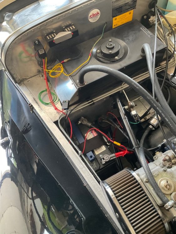

  4. MV8, I should be paying you a consulting fee! I am attaching a picture of my installation which has only one relay, I’m sensing from your diagrams that I might need two?.
  5. MV8, Auto electric is not my forte’. So are you thinking I don’t need the relay and I can just plug into heater power source?
  6. Steve, you must be a pro! Thanks very much the wiring diagram, my own installation does have a relay, a 30 amp fuse and a manual switch (I used the wiring and switch for the heater fan as an expedient). With everything wired I can turn the fan on low speed then high speed, but when I turn the ignition off the fan keeps running? It must be something simple so I’ll keep trying different things. Thanks again for your help!
  7. Andy, Your name appears when you respond to my post? This is a 2 speed fan, but when I connect the red wire to power I do get both low and high speed cooling, but the fan continues to run after I turn the ignition off? Obviously auto electricity is not my strong suit!

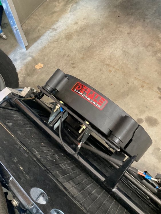

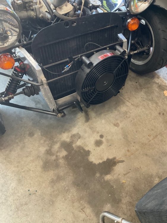

  8. Andy, A picture of the fan and radiator, this fan has 10 blades and generates 1450 CFM.
  9. Andy, I do have an IR thermometer so I’ll try that tomorrow. The radiator is not leaking or hissing so it could be a faulty gauge. Brilliant!
  10. Andy, The temperature gauge is in Celsius, there’s a 90, then a hash mark (not quite half way to 140) then 140 Celsius. It warms to 90 C then creeps up to the hash mark, that’s when I head home. There are several things that might contribute to the problem such as air in the cooling system, bad water pump or old Marston radiator. I’m open to suggestions and recommendations. I am not a professional mechanic! Thanks
