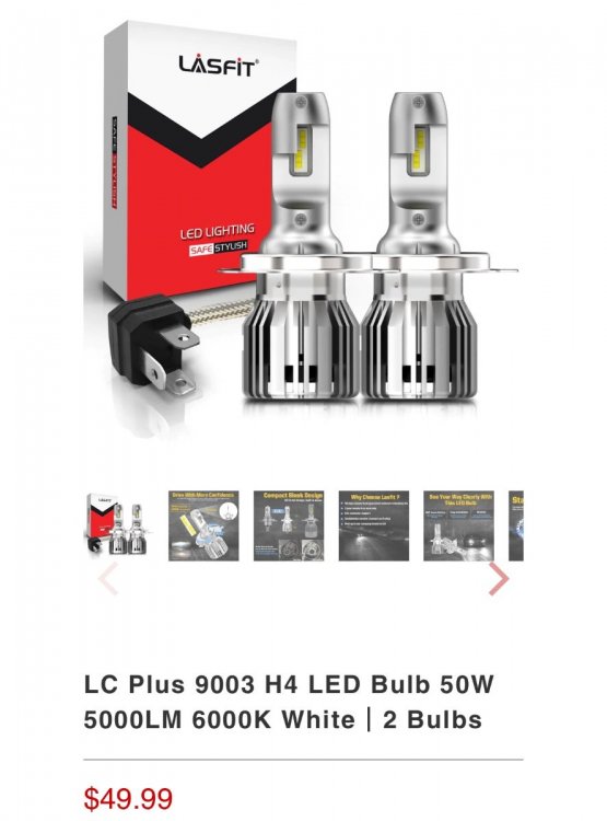

For anyone looking at LED options. I used these bulbs as a direct replacement, and I replaced/will replace with clear lenses. I also used these for the headlights: Getting on the dust covers required a little bit of effort, but direct plug and play for Halogen 9003.

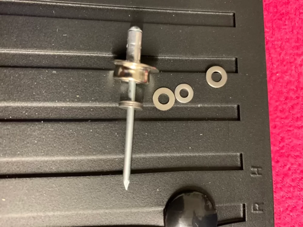

In the “detailed 420R build blog,” the guy used some tiny washers inside the female snap so that his rivet gun could apply pressure (makes it possible to use any rivet gun for those things- handy tip for anyone reading). More discussion can be found on the section about fitting mats. Here is a pic taken from that blog: Congrats on being done!
