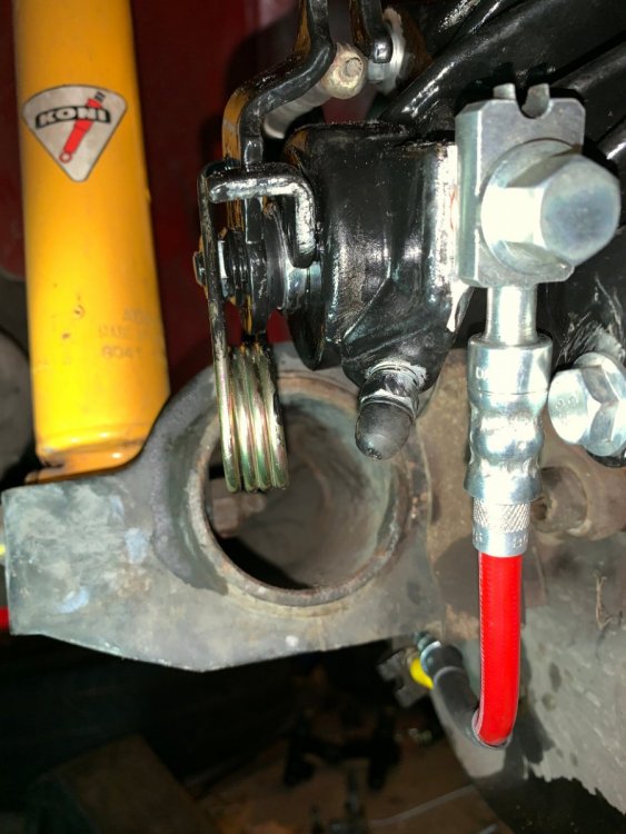

In case anyone is wondering what this looks like, because you're thinking hmmm, aluminum calipers, add lightness! I tried both directions for the banjo fitting. It just didn't work. A different softline to the caliper would anyhow be required for a Caterham so maybe someone could figure out a way to make this work so you can use lighter, more reliable Mk4 calipers. It can be done, the OE Mk4 flex line has a very specific angle to the line coming off the banjo bolt fitting. Something like that is required to make this work. -

The parking brake self adjusters on the Mk2 Golf rear brake calipers are notoriously problematic. The tip in the VW community is to replace them with the Mk4 aluminum rear calipers, 1J0615424 and 1J0615423. They bolt right up, but the brake line routing is slightly different. Mk4 calipers also use a banjo bolt fitting, instead of a thread in fitting. I could never get the Mk4 brake calipers to work on my Mk2 because the banjo bolt fitting trapped the caliper mounting bolt. Meaning, you'd have to disconnect the lines to replace the pads. Maybe the mounting/routing is different on a Caterham so the lighter Mk4 calipers with improved parking brake self-adjusters would work on a Caterham? -
