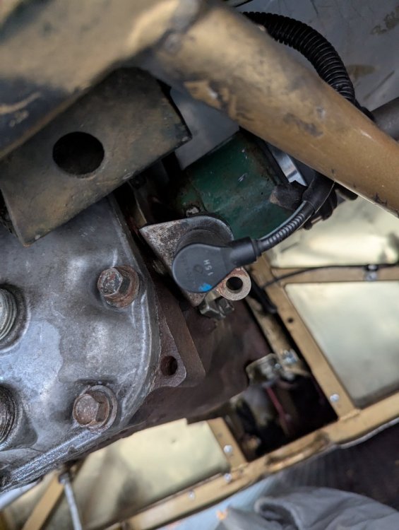

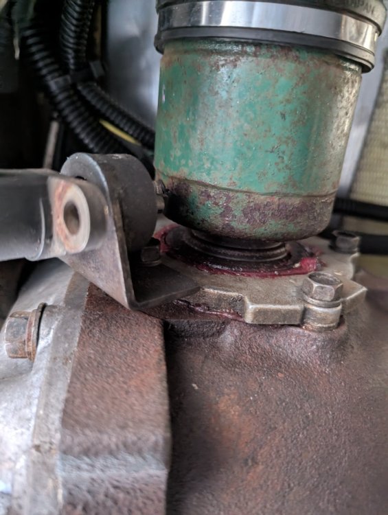

  5. Those gearbox mounts are not something I have even inspected on my car. I will crawl under there and see if I can get some images of it....

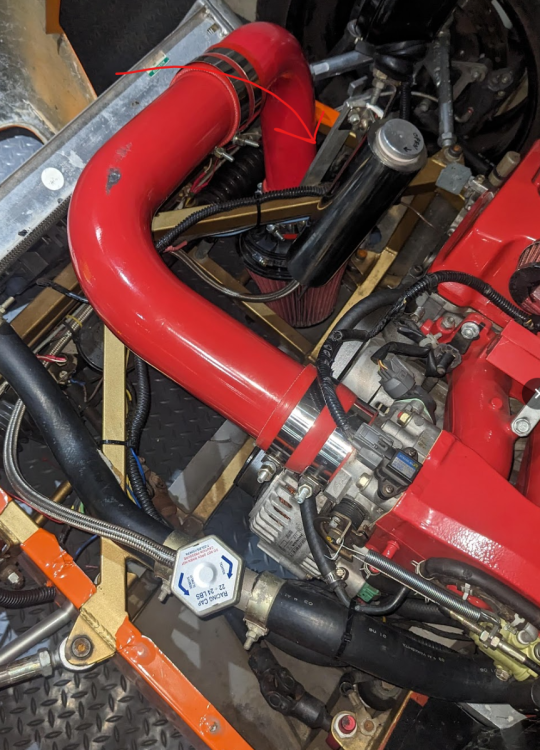

  12. Fantastic. That start up is immediate. For your muffler, is that a glass pack? It's going to be extremely loud if so. May have some problems at race tracks that have noise limits.

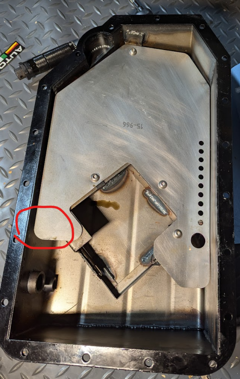

  14. Did you remove the windage tray before fitting it?
  15. I had to trim this part of the baffle then the holes lined up. Also, you have to remove the stock windage tray. I spoke to Canton about this because I was also not happy. In the end they confirmed that the modification is necessary for AP1 engines. Canton said they would address the issue for subsequent purchasers, but it seems that didn't happen.
