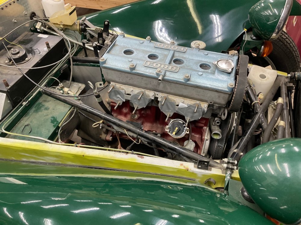

I am curious about the color of the engine block in my 86 Caterham with a BDR 1600. I have no reason to believe this is the wrong color or a repaint but I have to admit the blue cam cover and the maroon engine block and the raw aluminum on the sides of the head are a weird color combination. I’m sure some of you experts out there know if this is correct. I plan to repaint the block to freshen it up before the engine goes back in the car.
