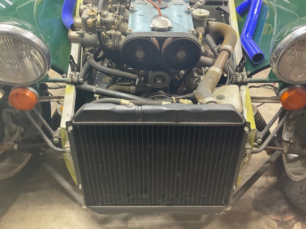

  5. The engine is ready to pull. I don’t have my engine hoist in my garage so I need to bring it home and I’ll be really to pull it. Today I helped the son of the friend who originally owned my Caterham, clean out the storage unit the Caterham was in. I got really lucky. We thought we found all the Caterham parts last weekend but we were wrong. We found two Weber boxes each with new 40 DCOE carburettors in them. I haven’t studied them yet and I have no idea why he had an extra set. The tubes on these two are longer (I think) but other than that they look the same. I haven’t even started studying Weber DCOEs yet but with two new pairs surely I can get the car running. I have new silicone upper and lower radiator hoses to put on when I go back in with the engine. I’m going to replace all the heater hoses with silicone hoses so I hopefully won’t have to do it again. I’m a believer in stainless braided AN hose and plan to get the fittings for the carbs so I can use AN hose to plumb them. I don’t have an extra fuel pump and even if I did I would trust it not knowing its age. I’ll have to purchase a new one. When I removed the clutch cable I found it to be smooth and very free. Even bent around at 180 degrees the cable was still loose and smooth. I’m under the impression that maybe the pressure plate and clutch have rusted themselves together. As I mentioned earlier, the clutch pedal was extremely hard to push. Engine and transmission separation will be one of the first thing I do when the engine hits the floor. Does anyone know if the color on the engine block is the correct and original color for a BDR 1.6? I have attached a picture to show the color. It reminds me of the color of my MGA/MGB engines I have worked on in the past.

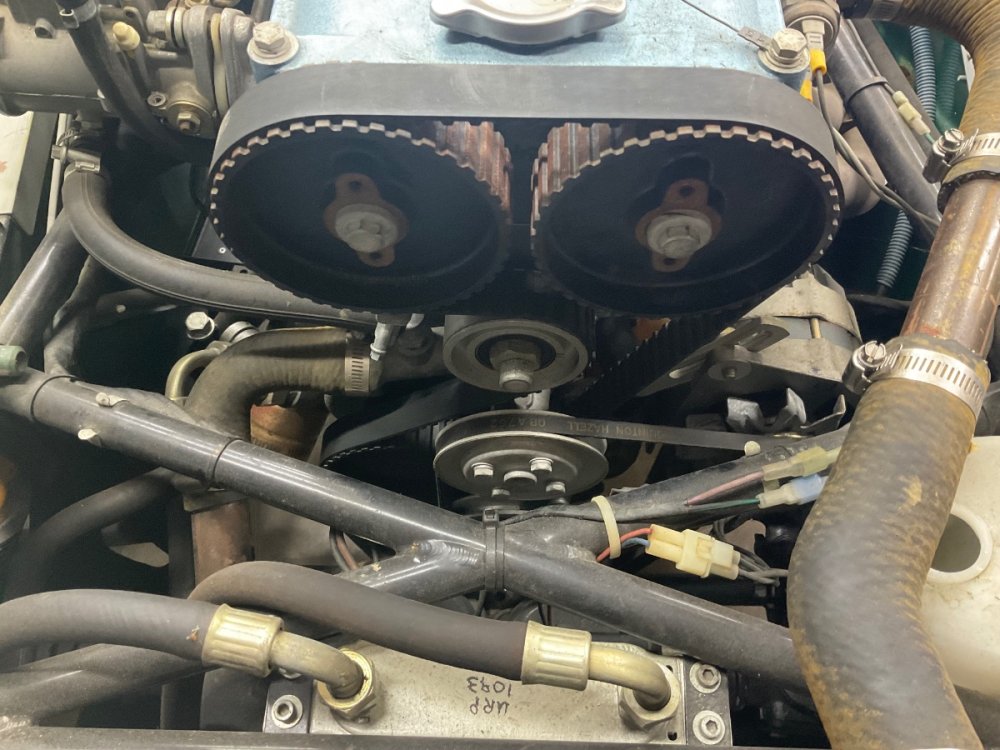

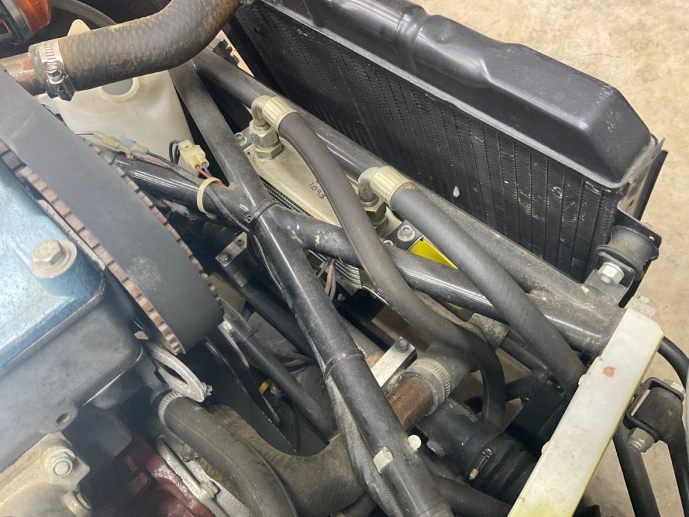

  7. This afternoon I started preparing the engine for removal. This is the first time I ever worked on a car this age with no grease and grime. It is truly like a new car. Even the exhaust nuts unscrewed with my fingers after the initial breaking loose with a wrench. It’s a pleasure to work on. Things get a little tight but never was a problem. I did notice the probably 20 pound Lucas starter. The starters I have been using in LS and small block Chevys are half the weight of this Lucas. Surely there are some better options out there. You can see what I have gotten done today and tomorrow I’ll continue and remove the alternator the oil and filter, hoses to the oil cooler, clutch cable, etc. I hope to lift it out tomorrow afternoon.

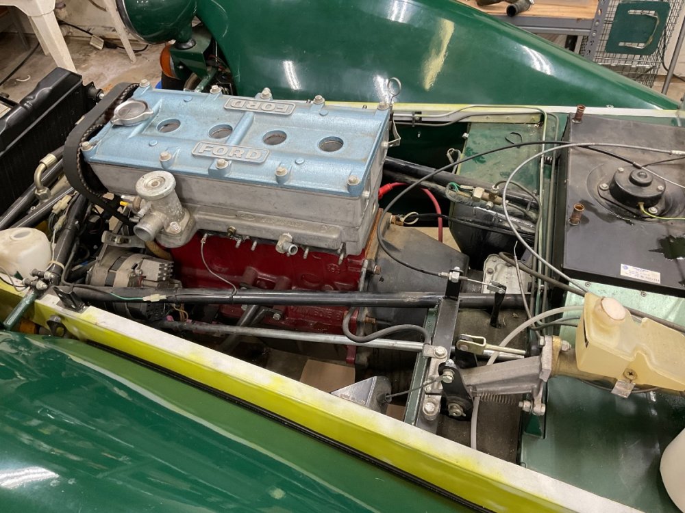

  20. After sleeping on it last night, given the fact that the shifter is stuck in neutral, the clutch pedal takes the power of a gorilla to push in, the timing belt and all the hoses need to be replaced, the fuel pump should probably be replaced and on and on and on. I think it may be best to pull the engine and transmission to proceed wlith my work. Remembering that this car has accumlated less than 40 miles in 37 years really concerns me especially anything made of rubber. Anyone with an opinion on this please speak up. Even if the car cranks up and runs it’s not going anywhere until the transmission is free. I don’t like to jump to conclusions but I feel that this is the right thing to do. If anyone thinks there are other things to do first before removal please let me know.

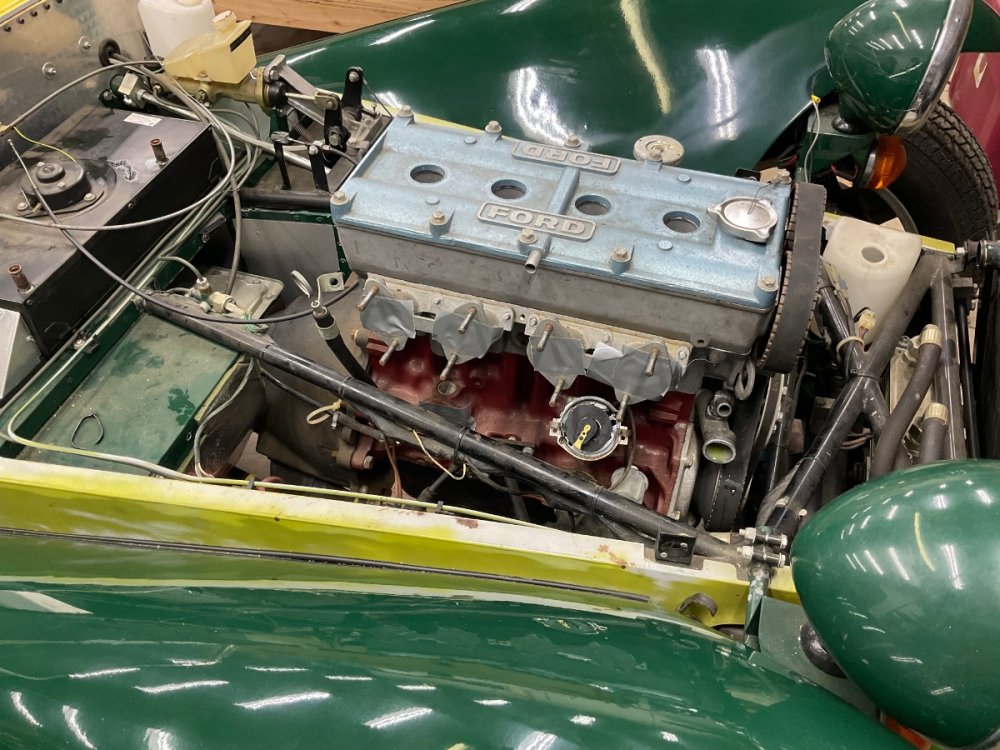

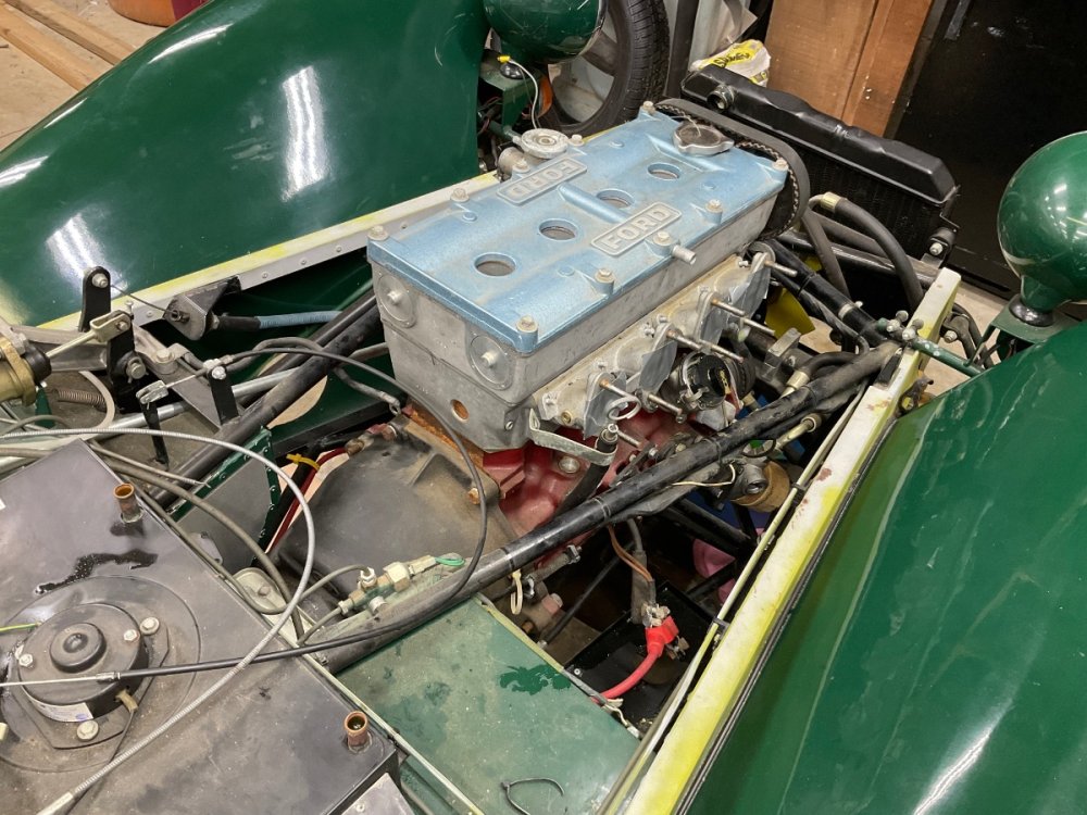

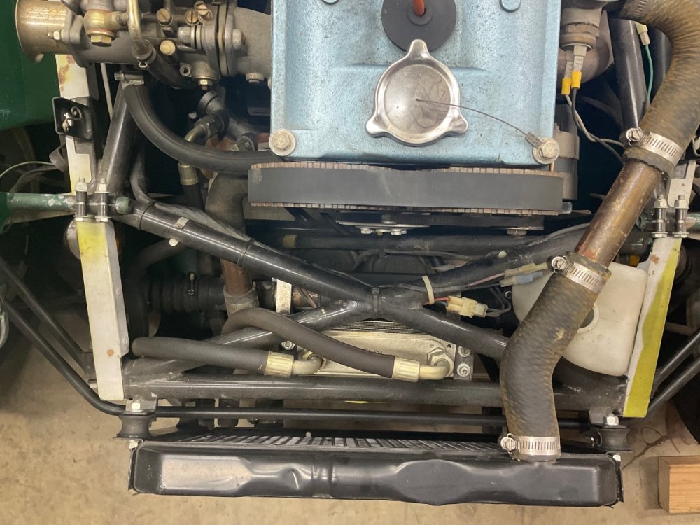

  23. Someone asked for pictures with the nose removed and I have attach a few. Tonight I jacked the car up and put it on stands. When I saw how the floor pans were installed by pull rivets I quickly understood how the floor area could be lowered. I took the seat out of the car and jumped in with no seat. I needed about two and a half inches behind my back which is probably about the thickness of the seat’s backrest. Obviously I sat about 3” lower due to no seat cushion and no adjusting rails. This position totally relieved the interference between my left knee an the steering wheel. I jumped back out and took my boots off and got back in the car. It was much easier to feel the pedals and to be sure I wasn’t pushing the brake while I was trying to push the clutch. With only my socks on I pushed the clutch pedal to the floor. It takes a lot of pressure to push the clutch down. Matter of fact it hurt my left foot so bad I could only push it down 3 times. This is a cable clutch and not hydraulic. Is this standard on all Caterhams? If this clutch is as good as it gets I’m going to have to install a steel plate in my left shoe in order to drive it.
