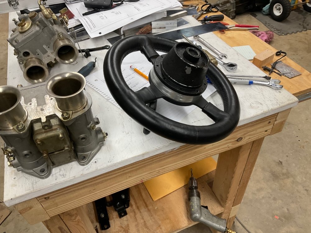

As you can see, the bolt circle has 9 holes. This is the bolt pattern Motolita uses. How do you think they came up with the idea of 9 holes? I had previosly only seen 6 or 3 holes. Strange engineering, I guess it limits the competion from being able to put their steering wheels on the Motolita hub. -

Honestly I still like the quick release the best although I needed this extra 1”behind the wheel. Hopefully the steering wheel will be off my thigh now. I will test fit tonight and if it works out okay I’ll take it back apart and have it anodized black. Considering the money I’m spending on this thing the quick release will have to wait a little while. -

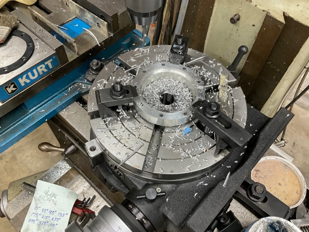

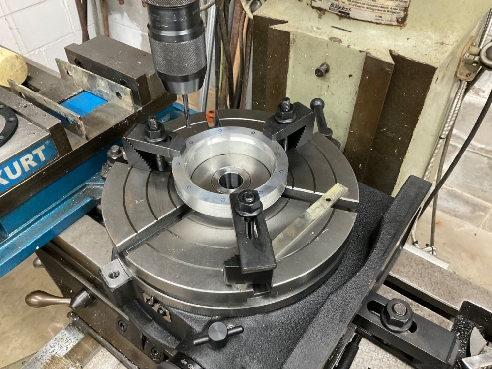

Tonight I finished up th spacer. Here are a few pictures. I don’t have the availabilty of CNC machine tools any more but conventional stuff still gets the job done. -

Started the steering wheel spacer this afternoon. It will give me an inch more length. I didn't want to over do it. I finished the ring but didn't get the bolt circle drilled. I will do that tomorrow. If it feels right I'll have it black anodized at the machine shop I where I used to work. I get somewhat special treatment there. No minimum charge on anodizing. -

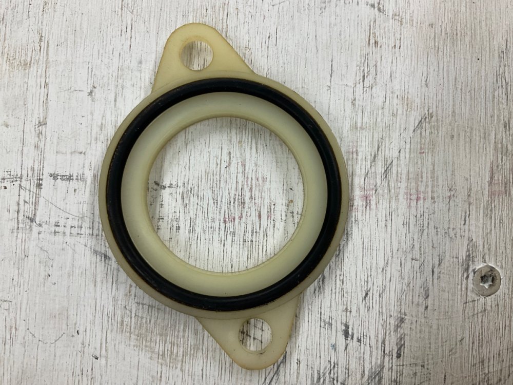

Earlier in this thread there was mention of whether the engine had Misab plates between the carbs and the intake or whether the carbs were bolted directly to the intake. There was a nylon looking plate about 3/16” thick with an oring on both sides located in grooves on both sides of the plate. Should I get new oring for this set up or buy different plates? I notice there seems to be multiple types. -

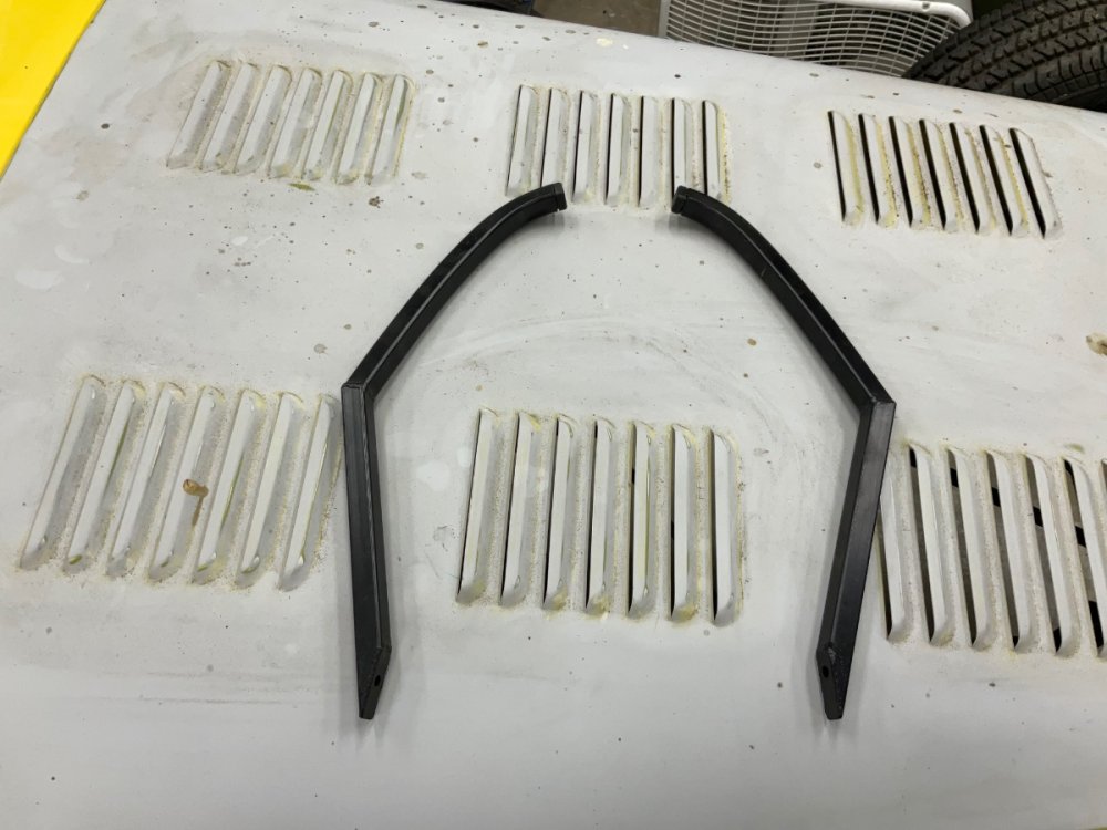

I believe I solved the mystery of the rear wing braces. I remembered seeing these two parts when loading up the car and the pieces that went with it. These braces are undrilled so I assume you were supposed to fit and drill to fit. -

Thats great! Before I order them I’m going to go through the extra parts and see I they may be here. Since I think the braces are here, it stands to reason the bolts may be here too. -

I think I saw a couple of brackets made from maybe 1/2” square tubing. I didn’t know what they were for but these brackets my be the rear front wing brackets. Neither of the front wings are drilled outboard for the 1/4” galvanized bolts for attachment to the front and rear brackets. This is just more evidence that the car was hardly driven. At speed the front wings would have surely lifted off the braces. -
