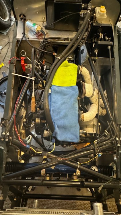

The steering column on my LHD S3, 1700 Xflow runs in between No3 and No4 exhaust pipe. The clearance to either one of them is minimal. Minimal as in .5mm (.020 in) territory. I tried rotating the steering rack in it's mounts, but despite changing the location/angle of the column ever so slightly, I don't seem to be finding the sweet spot in between both stacks. At around 1500 RPM and then again at around 5000RPM the column reaches some sort of resonance and starts creating this awful sound while hitting the exhaust. Does anybody have a fix for that? Others must have a similar problem. I am thinking about having a slightly smaller diameter steering column machined from Titanium rod or getting my exhaust modified.

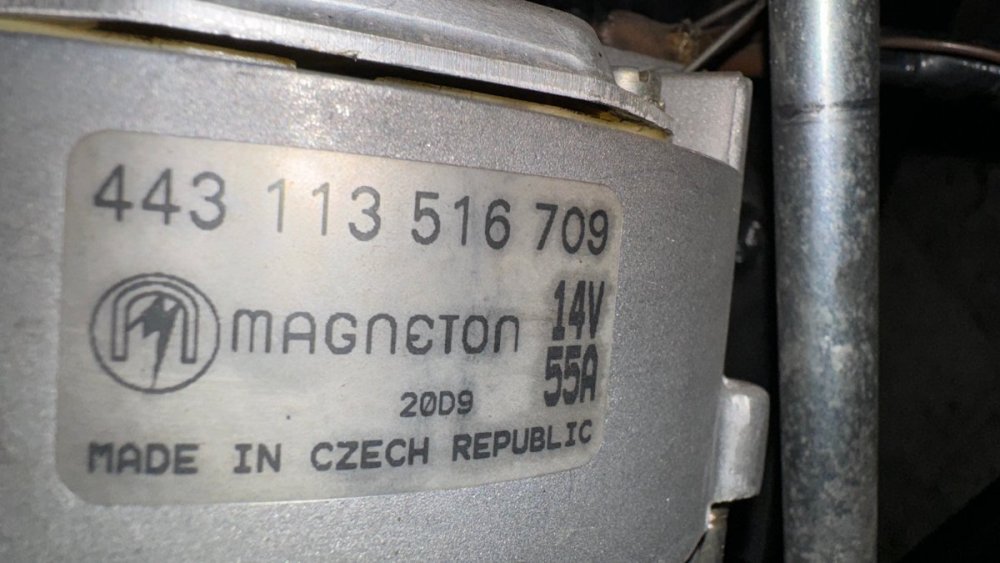

Bingo! That's the regulator! Nobody seems to be selling them, though. I shot IAT a mail and will report back. Thank you! No1 exhaust is running about 2 inches away from the regulator. I wonder whether it was fried, quite literally.
Is there some kind of data tag on your alternator? Thanks for the advice!
I hope I can find a repairs hop in the CO wilderness. Good advice! Thank you!! My alternator is also a huge chunk of metal which has very little up and down space to adjust the belt. I still would love to know what the original (Lucas??) unit on my S3 was. Cheers
The alternator on my 1700 xflow is developing a strange fault. It charges for a while, then starts dropping the charge voltage very slowly to about 5 Volts and ramps it up to about 13.5Volts. I monitored this behavior for about 6 hours today an am quite sure that the unit is dying a slow death. An annoying side effect is also that the oil pressure starts getting less and less, because there is improper voltage going to the gauge. The alternator which is fitted utilizes only 3 wires (one of them is tied back) It's mounted with 2 bolts on the bottom and 1 bolt up top. I am quite sure it is some aftermarket unit, but I also have no idea what the proper Alternator part number and manufacturer for my Kent Crossflow would be. Any help is highly appreciated. I attached a picture of tag I found on the alternator.

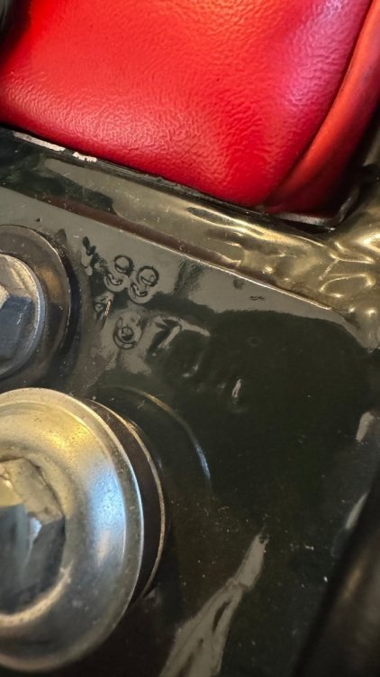

It's an Imperial frame (AM99), at least from what I could research. Arch Manufacturing >>> AM 99; cant really decipher the chassis number underneath. There are long diagonal support tubes in the engine bay and I couldn't find a single tube in the back which transitions from a square profile to a round one.

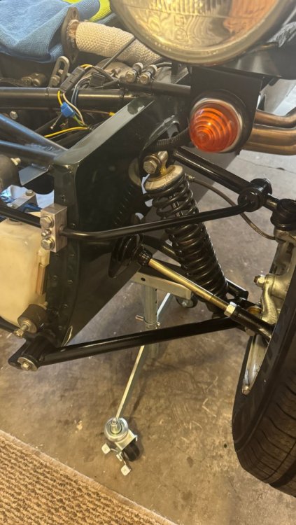

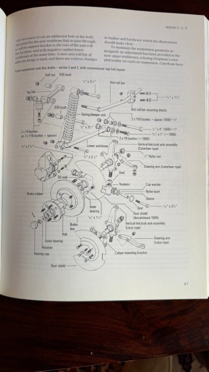

Thanks for the link!! The inserts of my trunnions are completely removable, but have a setscrew which arrests the inner metal sleeve. I have the L/H front suspension apart and will attach pictures as soon as I am back at my shop. The picture out of Tony Weale's Seven book perfectly resembles my front suspension
