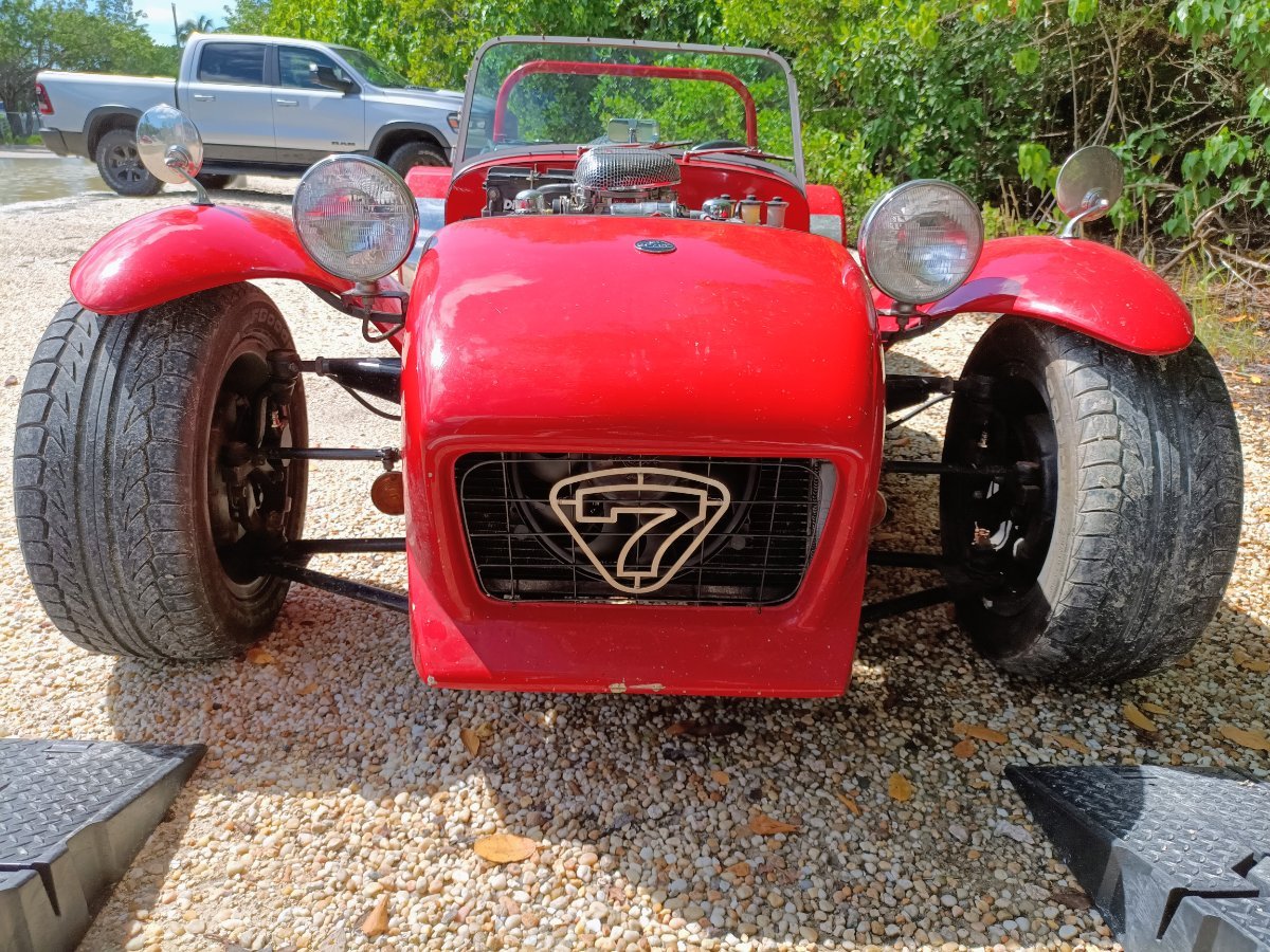

  1. That looks like mine, except I have the simple single hoop rollbar.
  2. I was just under the changing diff oil. BTW, the T-5 transmission was a little tough.
  3. Sorry, I got the file from someone else and don't have the software. There might be free stuff on the net to do it, or you could ask Send Cut Send.
  4. Yes, I provided the EPS file attached. You get a choice of material, I chose 316. I safety wired it to my existing grille. I'm very happy with their service. Lotus 7 Logo.eps
  5. I just got mine from sendcutsend.com

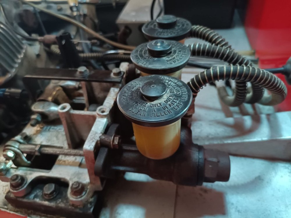

  8. Reviving an old thread with me info. On my Rotus Eight the clutch slave appears to be a 300ZX part, but I had to drill the mounting holes out to 7/16". Be aware there is a stack of washers underneath for spacers. The clutch master looks for all the world like Land Cruiser FJ40 part, but alas, the output thread size is different. A new banjo adapter should fix that.

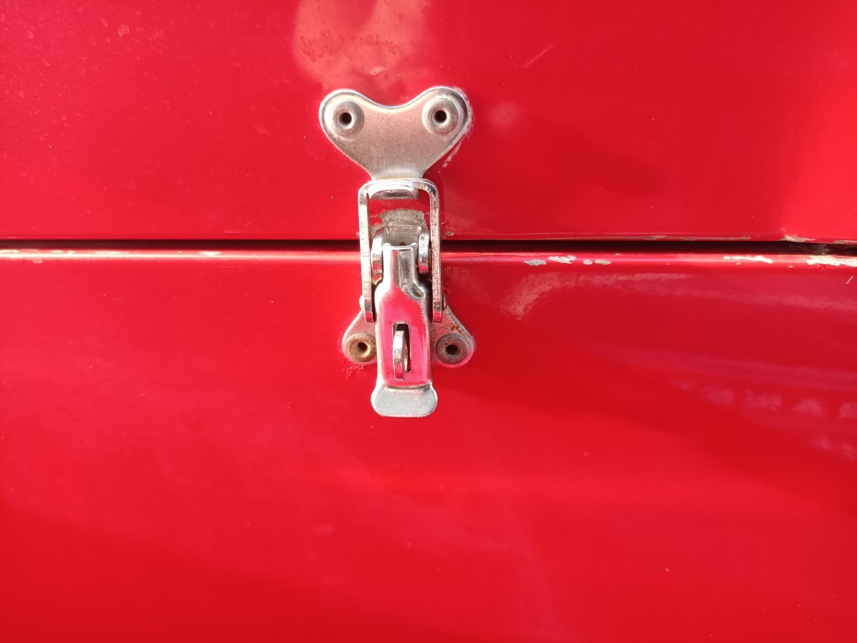

  12. My new-to-me Rotus Eight has one broken bonnet hold down. Does anyone know what these are called, or better, where I can get them?
