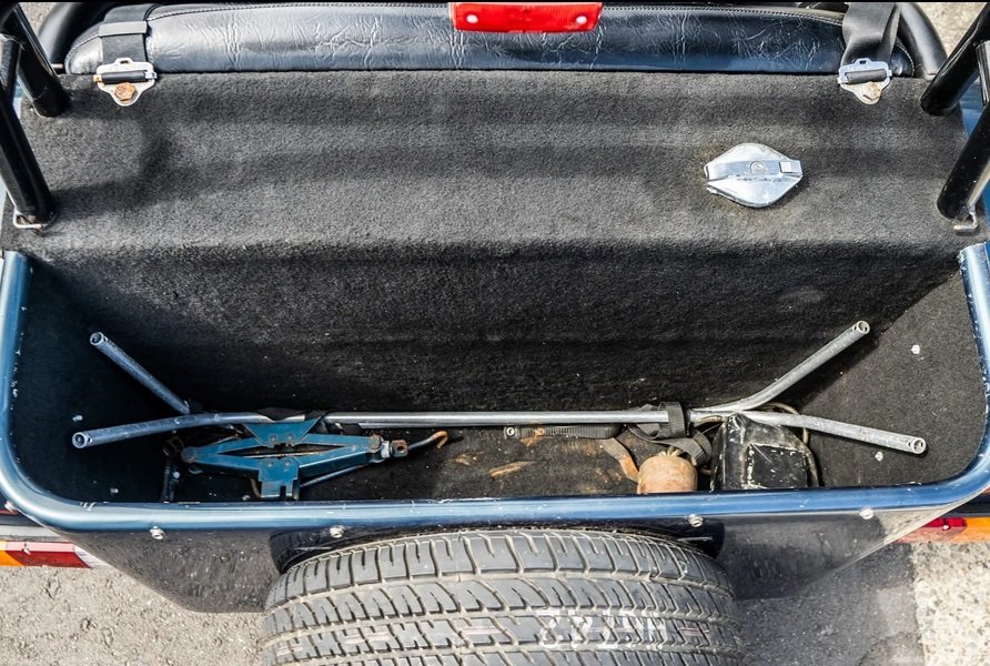

As the Rotus tank is directly behind the seat back, the pump, sender, and filler are readily accessible under a vinyl cover (not shown here). The vinyl is fixed with an aluminum trim attached with screws.
Marek, for comparison, here is his tank cover with carpet. Perhaps there is rubber underneath?
Edited by MV8
Yes, that car has an original roll bar and is a simpler trim using carpet.  But remove that carpet and the sender and pump will be mounted from the top.

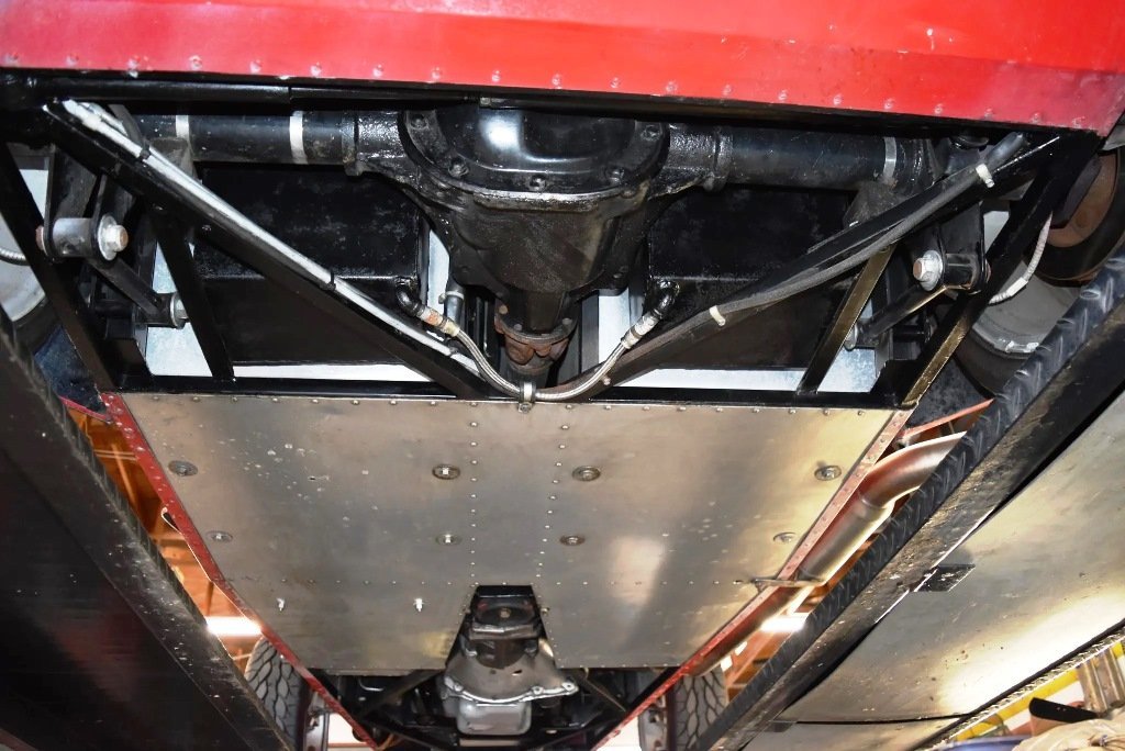

The 16.5 gallon tank is horseshoe shaped where the arms tilt towards the front of the car; so that the tank sits above and straddles the rear axle but the ends of the arms extend in front of the axle.  There is a balance tube running under the driveshaft to connect the two arms and the pump reaches down into one arm.  Unfortunately I don't seem to have taken a picture of the tank when mine was out of the car.  But the sender looks like this:

I found a good pic of the bottom of the tank with the balance tube.
That looks like mine, except I have the simple single hoop rollbar.
