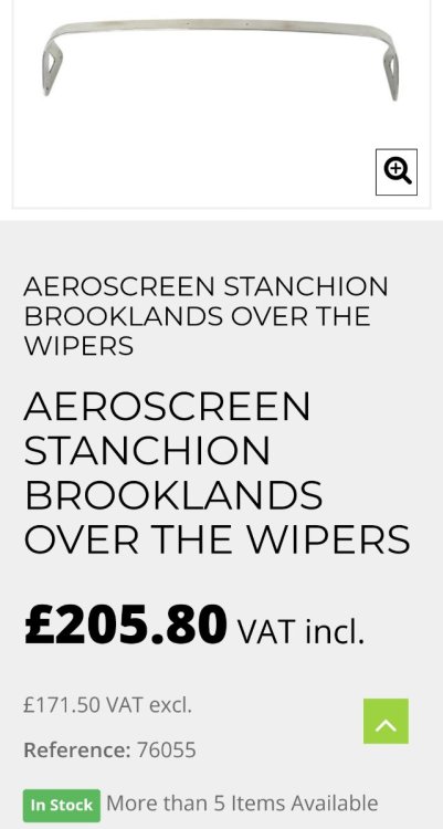

Lostin complexity Posted December 28, 2022 Author Share Posted December 28, 2022 Further update on the car. Put it on the street for a brief run to continue the shakedown phase. Ended up taking a 60 mile trip on the back country roads between St George Utah and Mesquite Nevada. Lots of twists, few cars and no houses or businesses. What a great time. Couldn’t stop laughing. Car ran great. Tracked cleanly. Wonderful power. So happy car is back with the genius mechanic for fine tuning and to work out a windshield. The standard upright wall of glass creates to much turbulence, the carbon fiber channels the air directly to my face as it is to low. Going to try the old tilting one from my MG. If that doesn’t work than I’ll have something fabricated out of aluminum. what a great time. Link to comment Share on other sites More sharing options...
IamScotticus Posted December 28, 2022 Share Posted December 28, 2022 I have read good things about a half (7"?) height windshield. I never made one myself. Many do like the aeroscreens and the aeroscreen stanchion mount made for them finishes the assembly nicely. There are plenty lying around. Link to comment Share on other sites More sharing options...
