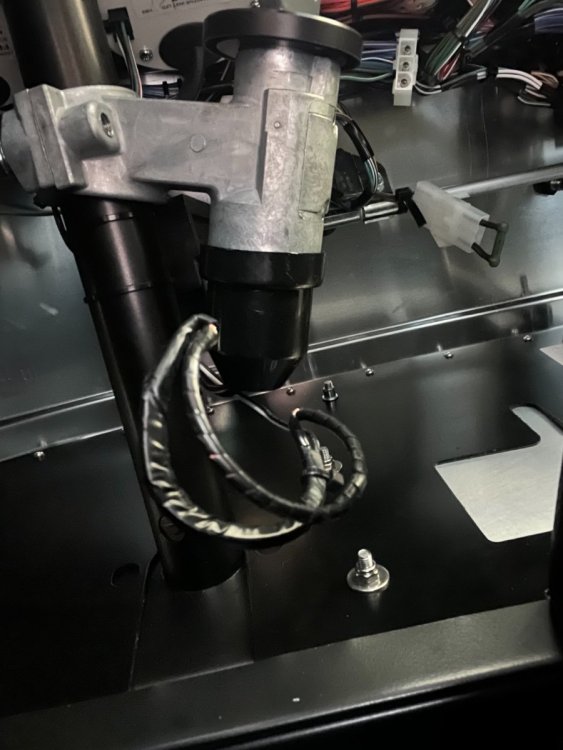

Right after/due to the tach fix, I encountered one of the more annoying conditions to date - no start.  It first started fine right after the fix when the tach was still dangling off the dash.  Then, after I tucked everything back in and installed back the steering wheel the car wouldn't start - no response at all from the red button.
Long story short (and another Josh R correct guess) - while futzing behind the dash I dislodged the Immobilizer antenna.
I now have it secured back with a zip tie around the ignition switch near its face, but there are times I need to shove the little Sterling fob backwards towards the antenna for the system to acknowledge it.
I already deeply hate the Immobilizer and want to remove it altogether or at least disable it permanently.
Saw some posts on the forum on the topic from about a year ago and also shared my sentiments with Josh R.  He is acutely aware and lobbying Caterham to eliminate it from future US spec cars.
Planning to revisit once I get through most of the rest of the To Do list.

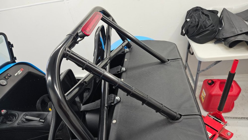

For builders in CA (I have no clue about SC DMV/reg rules), apparently the law has changed and you are *required* to have a 3rd brake light (top of roll bar being the logical location for it).  I can't say this was even mentioned in any of the in-person or photo-based "inspections" of my car, but apparently, that's the expectation now (and it would be nice if CC updated the kits for it).
I got a relatively cheap LED bar, mounted it via barrel bolts via existing holes in the roll bar and zip-tied the wires down through the boot to splice them into the left rear taillight -- pretty simple.  Regardless where it's a legal requirement, it does seem like a prudent step to avoid being too invisible out there...

59 minutes ago, ianashdown said:
Could you mount that as a 3rd brake light on the Roll Cage?
Ian
Yes, but I want it to be higher.  Again, my biggest concern is being completely hidden in front of one of those jacked up (or even not jacked up) "personal" trucks.  I am a bit less concerned about being visible from a distance with lights on and my yellow wings...So it will need to be some kind of a rod or pole sticking above the roll bar.  I was thinking of mounting a pole/whip at the unused LH shoulder harness point.
Thanks!
Good tips about splicing into the rear lights!  Did you run the wires inside the roll bar or zip tied to it?
My car does not have a center brake light at this stage nor side mirrors yet.
I have submitted the paperwork for titling and registration last week and don't know how this process will play out.  Generally SC is quite lax but I definitely plan on having a center brake light and side mirrors, regardless.
Just in case, I ran a spare double wire through the tunnel before covering it up and have the front few feet bundled up under the dash and the rear few feet bundled under the trunk floor -- if I decide to tap into the power supply to the relays and fuses and use a relay (like for trailer lights) or such.

I just zip-tied the wires down the roll bar; the zip ties don't really stand out now because I hung a small fire extinguisher on the same rail.  I got a light that was wide enough to mount to the existing holes in the bar.  The light I got really doesn't want to be installed in pieces (light is secured to the case with screws that are only accessible from the back of the case, which is up against the bar.  To mount it in assembled form, I used barrel-nuts with square-head bolts on the inside of the light case (since you can't get a wrench on those to tighten -- with the square head flush up against the edge of the case, the bolts won't turn, and you can just pop an allen key in the barrel-nut side to secure them).
Running a wire all the way to the fuse block is probably overkill -- LEDs are pretty low-Watt things that can operate without issue by tapping into one of the existing brake light wire pairs.  I don't have pics of the splice for power, but you can use parallel or t-type tap splicers pretty easily -- just have to find the right wires with a multimeter.  I chose the parallel type as they are more compact.  You can use that wire you ran through the tunnel to put a 139dB Stebel Nautilus air-horn aimed out the back as a retaliatory implement; I mean, that's what *I* would do with that wire...
RE: side mirrors, the standard ones that ship with the kit are garbage -- they block more forward view (larger), and show less rearward view (flat, not convex); plus you can't secure them without removing the glass which has about a 2% success rate...the manual might as well say "unpack mirrors, smash with hammer".  Get a pair of the convex ones used with the aero screen.  As you can see below, they can mount to the windscreen fine, you just lose the ability to swing the doors all the way open unless you get a pair of eccles mounts (which effectively makes the mirror part of the door); I don't mind not swinging the doors all the way open, and prefer the stability of the windscreen frame mount.
Awesome info, Ralph!  Thanks a bunch.
Re high brake light, I looked more closely and there is no practical way to run the wires through the bar, which renders my first question moot.  I am familiar with identifying and splicing into existing wires.  The barrel nuts are a great idea!
