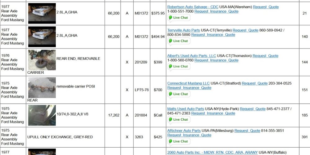

Vinman1 Posted February 8, 2023 Author Share Posted February 8, 2023 MV8, Hope all is good. I got parts for the brake set up off the Capri in your listing. Going w/ 9" brakes from Capri, which is as close as I can get to the Cortina. Although rare, there are a lot more Capri's in the US than Cortinas. The rear was gone from the Mustang II. How did you do that search? The format and locating is very good, I have not been able to find any of those in my google searches? Thanks again. Vin Link to comment Share on other sites More sharing options...
MV8 Posted February 8, 2023 Share Posted February 8, 2023 Most major auto salvage yards subscribe and list parts on the site. The nice part is they sometimes list prices, though they sometimes gouge for a "core fee". I always respond Oh, I didn't know you guys rebuild (insert whatever it is). They usually drop it but I don't actually argue about it. They decide what to charge. https://car-part.com/ Link to comment Share on other sites More sharing options...

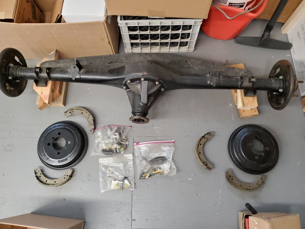

Vinman1 Posted February 12, 2023 Author Share Posted February 12, 2023 Just refitted rear with the radius arm / shock weld bracket relocated to the 12 O clock position, and Capri 9" drum brake set in place of disc conversion kit. Huge difference in tire clearance! Tunnel clearance is tight as is expected, but looks to be ok. Can't wait to drive It! 1 Link to comment Share on other sites More sharing options...
