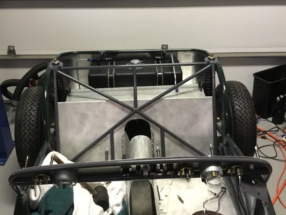

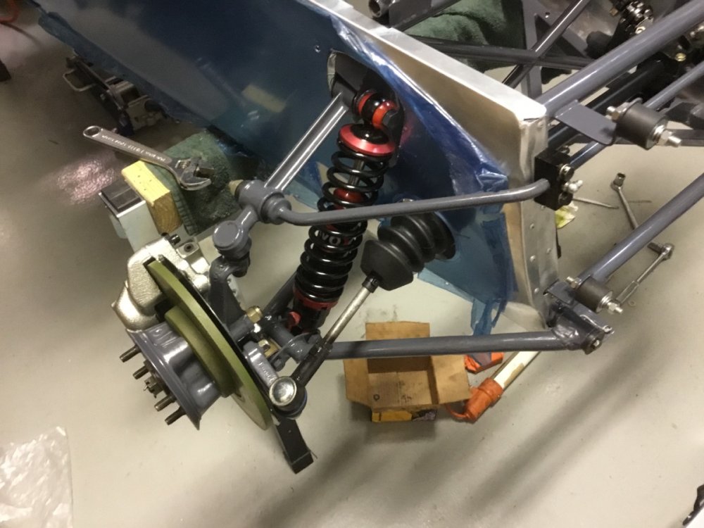

Bought this 7 as a derelict race car with a full cage. I stripped it down to the frame and cut the cage off and replaced some of the square tubing. I retained some of the cage tubing to fabricate a street style roll bar. I had the frame sand blasted and powder coated along with the front and rear suspension components. I had a Triumph 7 rear axle and .363 differential shortened and Lotus 7 fittings welded on.
I fitted the Triumph 10 rear drum brakes, studs and backing plate to the new axle so all 4 corners had the same bolt pattern and studs. I bought new aluminum body panels from ARCH in the UK, wings from Tony Ingram in the US and fitted them myself. Tough job in the boot top tubing/panel interface.
The motor is a pre-crossflow 1500 Ford. Tony Ingram provided the forged parts and cam for the twin DCOE spec fast road version. Dave Hayden built the motor and OH the transmission. I wired the car using the same components I use when wiring aircraft (lots more fuses) I had the car painted by a local restoration shop.

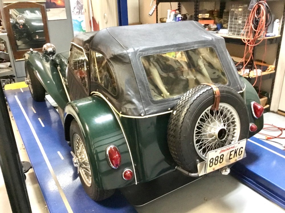

My wife insisted on wire wheels and calls the 7 our “ice cream car”. It’s great fun to drive even in cold weather as I found a S2 top and doors on ebay.
Cheers, Bill Stevenson04C2115A-6CB0-4792-A16B-C8AAC20DCE20.thumb.jpeg.1277b97adfa3857a99ba6e3ef7aec7d0.jpegE4482144-E9CF-48A2-B633-5C05F755632C.thumb.jpeg.d14c6071eb78f3900f6450c2d63d6c4f.jpegAB24A5E1-00C6-4EF1-B203-7CDB44E39513.jpeg.7c9c53849a02d037b98c476ca765ba4a.jpeg938CD148-3731-4885-A5ED-16D2215015FE.jpeg.d4d2c3f1155c3cfc2f4a84f682fb5193.jpegC1262C39-0506-4CB1-9BDF-C463BF34EC2F.thumb.jpeg.f3dae7e93ab145477de16f5a7f40ed53.jpegDCC84B3B-387E-4DD9-87C0-FD90BD5CA9FC.thumb.jpeg.6727927da48be9e7a4acbad560274178.jpeg0DDE97F9-72F2-4FA2-8032-DBC2DFB566E5.thumb.jpeg.fc9c5ffc71e21ecc9f11d38329b63352.jpeg0FE268AF-ACFF-453B-B5F5-28F85979C7B2.thumb.jpeg.b91e5a208e4cb029a63d7ec03b5a9079.jpeg
