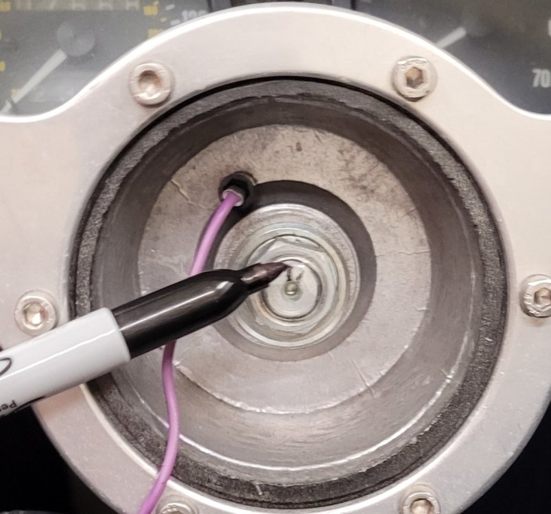

For those with the ubiquitous Mountney GT wheeel, here is how I pulled mine and believe it or not, I didn't break anything!
I don't think this needs much explanation but heres a few points to keep in mind:
* Be aware of the location of the horn contact on the back, if you care about it, it could get damaged.
*  My claw was a very tight fit next to the speedo bezel.  Too much of an angle and it could get damaged.  Ensure the claw is fully seated  don't let it ride out as you tighten the puller.
*  Precautionary stuff:  SAFETY!  Save your coils, DISCONNECT BATTERY.  You will want to release the steering lock to do this, thus engaging the electrics.  If your horn button is live, you could short something in the removal of the centre plate.
*  Tape is your friend.  use it everywhere.
*  Sharpie marker to record the index location of the wheel.  This may change after alignment so consider how tight you put this back together before alignment.
*  Once turning the puller, the hub loosened in about a half turn, easy.
*  The collumn nut is a lock nut that took a 3/4" socket.
NEVER REUSE A LOCK NUT.
I measured the thread at 1/2x20 SAE.  But I haven't been able to chase with a regular nut to confirm it.
No, I didn't use any lube.
IMPORTANT:
Always replace a lock nut with a new one, don't reuse a lock nut.
I had previously removed my horn contact ring so that wasn't in the way.  I got out my horn ring and I believe there is enough clearance for the claws to grip the rim.
