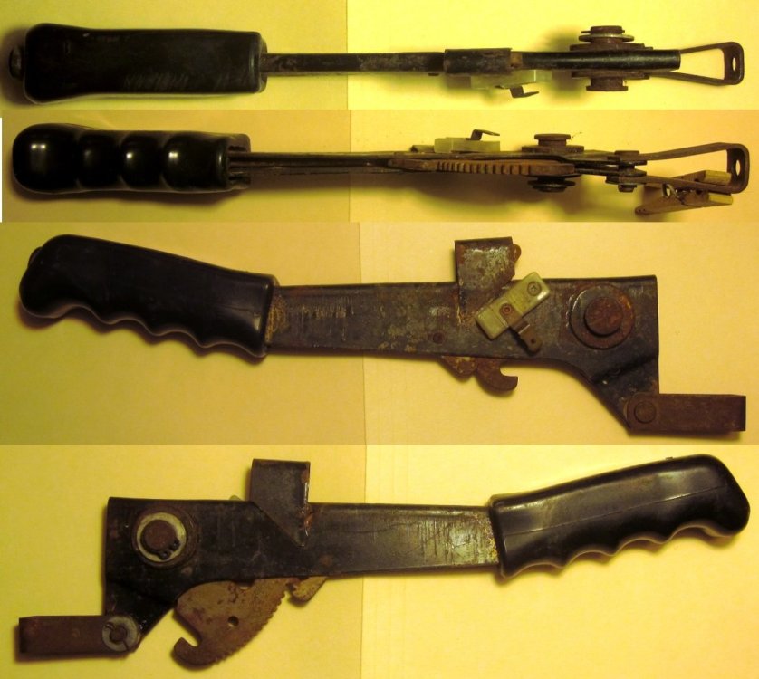

ianashdown Posted July 4, 2023 Author Posted July 4, 2023 1 hour ago, MV8 said: I have a 1500 spitfire and the handle looks identical to the tr250 unit in the last link. What do you want to know? It's push-button to release, the loop around the top is a travel stop for the quadrant that is free to rotate unless hooked by the bottom slot, and there is a switch for an idiot light. Distance to the lever that engages the clevis is about two inches, and the overall length is about 11 inches. Hmmm . . . Any chance of a picture or two? Thanks Ian
