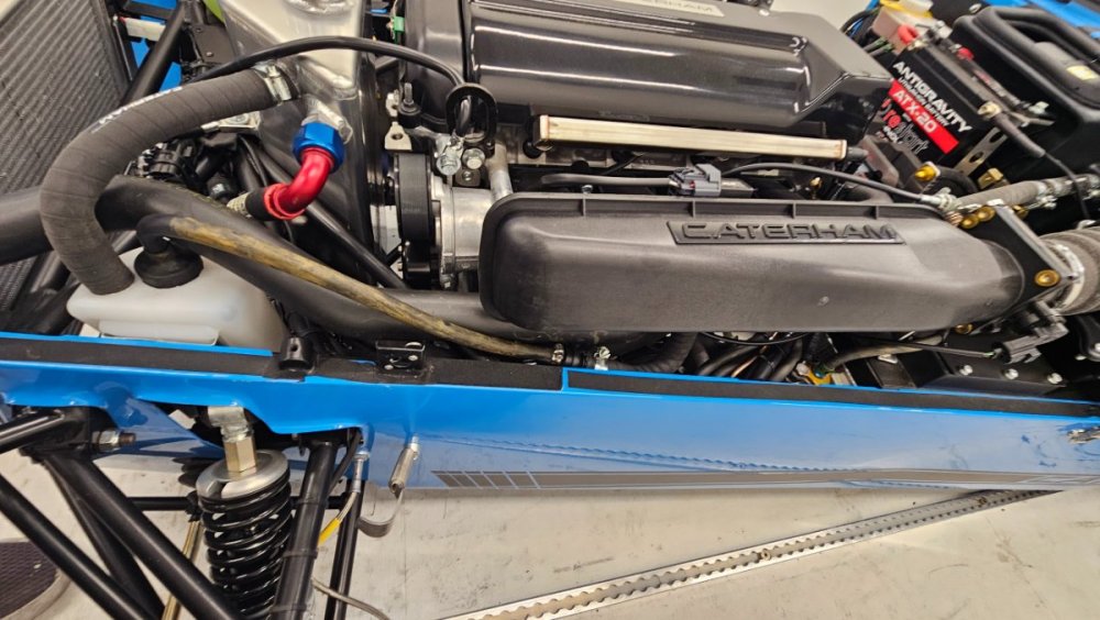

ralph Posted August 18, 2023 Posted August 18, 2023 @KillerB (and anyone else with opinions), I put a PCV on and my idle is way higher now. Theories?... No ill effects to power or rev-ability so far (if anything, it requires less clutch finesse off the line now). Will throw the stupidly-overpriced ECU cable on it and see what the numbers are, maybe back the idle screw down a bit since I raised it above the target TPS voltage before. Related: is it possible that US cars get an ECU with mapping appropriate to having a PCV present?

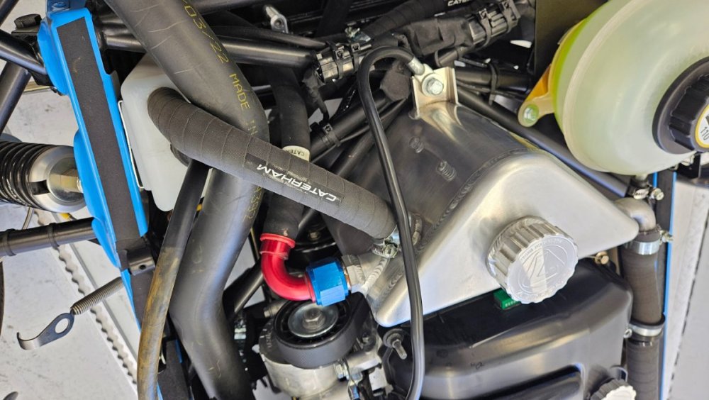

ralph Posted August 18, 2023 Author Posted August 18, 2023 The PCV itself is one of these (cheapest I could find): https://www.summitracing.com/parts/URO-016453 ...and working left to right in the admittedly subpar photo here, you've got the stock catch-tank cap and hose, with the hose pulled through so an inch or two is still in the bottle (definitely keep the end away from the bottom so the vacuum doesn't draw spillover oil into the plenum), the other end hose-clamped onto the inlet of the PCV (which has directional markings) just under the plenum on the left, and since the outlet barb is small, there's a section of smaller hose to allow the stock caterham hose (spare bit unused in build) to be cinched down over both, while the other end fits snugly to the hole in the plenum that comes with a blanking hose cap of sorts clamped onto it. As with most of my build, this is solid B- quality work. Modesty prevents me from showing pics of the other side where I wrapped the headers in fiberglass jackets with all the finesse and aesthetic sensibility of a 2yr old putting their toys to bed in a blankie. In my defense, both these mods are function-before-form, so, style points are inapplicable, IMO... The fiberglass header wrap lets off a bit of smoke at first (I assume they use some kind of light oil during manufacture to get it through whatever sort of loom weaves the stuff), so I had some words with the CHP this morning about why I was driving a car with no license plate that had smoke drifting out from the bonnet gills. After inspecting the paperwork, the officer asked to see the VIN on the chassis, and I will admit to being more than a little apprehensive about pulling the bonnet off, but all was good. He agreed that the car was better off at Laguna, and thanked me for following the process by the numbers. BAR ref (virtual) appt on 8/23...

MV8 Posted August 20, 2023 Posted August 20, 2023 It looks like Ralph has it inverted compared to Killerb. No idea how it is oriented on a merc. With it idling, rotate the pcv so the arrow points up and see if it has any effect on idle rpm. Take a pic of the side of the block below the intake manifold.
ralph Posted August 23, 2023 Author Posted August 23, 2023 Mine's pointed the same direction (arrows point to plenum, which is the desired flow direction). Pinching the hose on the catch tank side of the PCV restored normal idle pointing to a vacuum leak upstream (catch tank cap has a hole in it -- plugged the hole, so now the system is more "closed" than previously, but I haven't tested it yet). @MV8 re:pressure/vacuum I thought positive crankcase pressure and negative intake pressure (vacuum) would both push/pull against the PCV spring to open the valve...so, I'm confused there as to why intake vacuum would need to exceed crankcase pressure -- they're both opening the valve, no? Also, if there is a breather/inlet on my crankcase, I'm not finding it...looks like it's just one line from the rearward part of the crankcase to the sump tank.

ralph Posted September 2, 2023 Author Posted September 2, 2023 (disclaimer: I'm not technical either) @rider Yes, PCV = Positive Crankcase Vent, and you may not have one on your car (420R kit doesn't come with one, and your state doesn't require it -- CA does). If you do have one, I'd suggest you remove it. Follow the oil hose out of the crankcase on the top/right/rear of the engine, and you should see it terminate at the sump tank; in the same general direction, you'll see a hose exit the top of the sump tank and go into a plastic catch bottle; from there the cap of the plastic catch bottle has a hose in it that, in the standard set up, goes nowhere (i.e. vents vapor to ambient air, fluids (oil) to ground -- though the latter shouldn't generally happen unless you have way too much oil in the engine and/or the cap hose is too low in the bottle). In the setup that will support getting your car registered in CA, that cap hose has to connect to a one-way pressure actuated check valve (the PCV) which connects to the port in the bottom of the plenum. This 'circuit' is intended to take any crankcase blow-by vapors and feed them back into the engine where they can be burned completely, thus reducing emissions. In other engines, this can work well. In our dry sump Duratecs, on the other hand, it can confuse the ECU (increasing idle, which means more emissions), and can make the engine run rough (also increasing emissions with incomplete burn), and in extreme cases (as in mine, as it happens), can even feed a bit of oil into the air intake, which is most definitely not good for emissions. You could say that the PCV circuit itself is a metaphor for the regulations that mandate it: excess tax revenue (blow-by) is routed through regulatory apparatus (PCV) in a manner that makes the economy run rough and smell bad while more than defeating the intended purpose. You can tack this whole thing onto the epically long list of well-intentioned but hopelessly confused CA environmental regulatory claptrap, but if you want a legit registered car in CA, the PCV has to be there.
