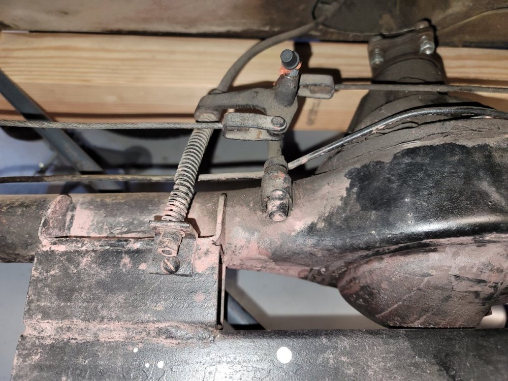

TEM Posted September 24, 2023 Author Posted September 24, 2023 More picture of the axle. I don't see a breather. Also that E-brake Christmas tree looks kludged with two zerk fittings. Hopefully someone can help identify it by the numbers stamped on it - sorry for the blurry one, no matter how many times or how many directions I took the picture, it came out the same.

IamScotticus Posted September 24, 2023 Posted September 24, 2023 That looks like a well built axle. If you're lucky, you might have some slosh baffles in there.

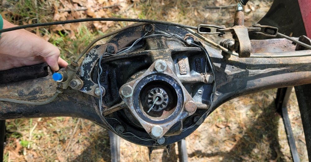

SENC Posted September 25, 2023 Posted September 25, 2023 I can't positively identify yours, but here are a couple pictures of the S10 axle from my 65 when I had it out for cleanup. You should be able to zoom in for markings, but I don't see any similar to yours. The 2nd pic is of the handbrake tree arrangement.
