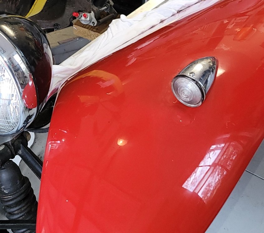

TEM Posted November 26, 2023 Posted November 26, 2023 Working through the electrical system while waiting for other restoration parts. The car is fitter with the L1130 side lamps but during troubleshooting I found not only are there no wires connected to the bulb holder but there are no holes in the fenders for the wires to exit the side lamp. Were these side lamps and turn signals optional? Is it common that no hole would be drilled for the wires? The car is fitted with the direction indicator switch so I can't imagine why there is a switch but no wires (or holes) to the lamps.
SENC Posted November 26, 2023 Posted November 26, 2023 Here is a picture I took when disassembling my wings to polish the alu. Securing the light to the wing required 1 hole/bolt, electricity through the other hole. I know some cars had separate indicators mounted below the headlights, but not sure when that started.
TEM Posted November 26, 2023 Author Posted November 26, 2023 SENC, your side light looks like mine and your under wing picture is what I was expecting in terms of the hole for the wires. I don't have the separate indicators under the headlight, I think they were introduced with the S3. I believe my front wings are original to the car but the acorn nuts don't look right. It looks like your side light is doing double duty, also acting as the nut for the wing stay, how very Chapman of you.
SENC Posted November 26, 2023 Posted November 26, 2023 Now that you say that, I think that is my recollection - I'd forgotten. My wings have been repainted, but to my knowledge they are also the originals.

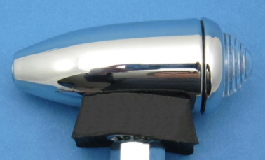

IamScotticus Posted November 30, 2023 Posted November 30, 2023 (edited) I believe the front wing mounted markers/flashers were a European mandatory item but optional in most USA jurisdictions. The headlamp flashers would serve for both functions. It depends on the DMV rules in your jurisdiction, not what Lotus or Caterham had done. BUT, if you want them on your car, there's nothing wrong with that. Im partial to the Lucas L516 torpedo types. Dave Bean had a set available last year. Edited November 30, 2023 by IamScotticus
TEM Posted December 1, 2023 Author Posted December 1, 2023 The headlamp flashers would work as turn signals? Can't say that I have ever seen that. I can understand turn signals and running lamps being optional back n the 60's but why add the lamps to the fenders and the big switch to the dash and not add the wires. It's usually the other way around; wire harness has all the options and just don't add the lamps and switches if they don't buy the option.
IamScotticus Posted December 1, 2023 Posted December 1, 2023 38 minutes ago, TEM said: The headlamp flashers would work as turn signals? Can't say that I have ever seen that. OK, I see you don't have the headlamp mounted flashers. I refer to these:
SENC Posted December 1, 2023 Posted December 1, 2023 @TEM looking at your pictures again, I see someone added side view mirrors to the wings. I can't see exactly where those are mounted, but look to be pretty close to in line with the lights. Is it possible that whomever installed the mirrors used one or more of the original holes for the lights and just moved the lights? Either to minimize drilling or to effect the location of the mirrors to their liking? Then never got around to rewiring, or decided the functionality wasn't worth another hole?
