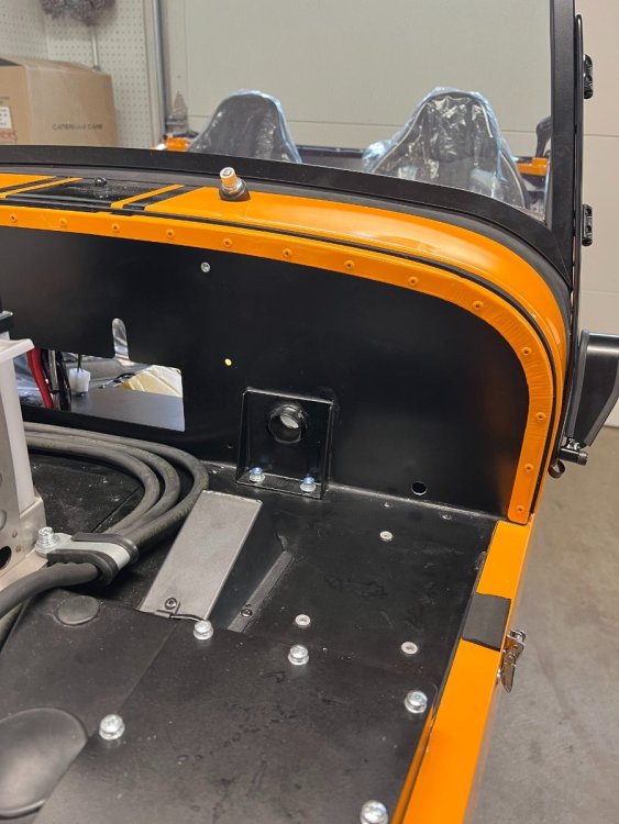

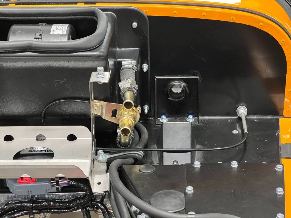

empti Posted January 9, 2025 Posted January 9, 2025 @Geowiz Here is how I did it. In my case the pre-drilled hole for the control cable is on the left side of the steering column. I think the air box mounting bolts have spacers and may allow the cable to tuck underneath it. I'll update you once I have reached that far into the build. Before/After:
