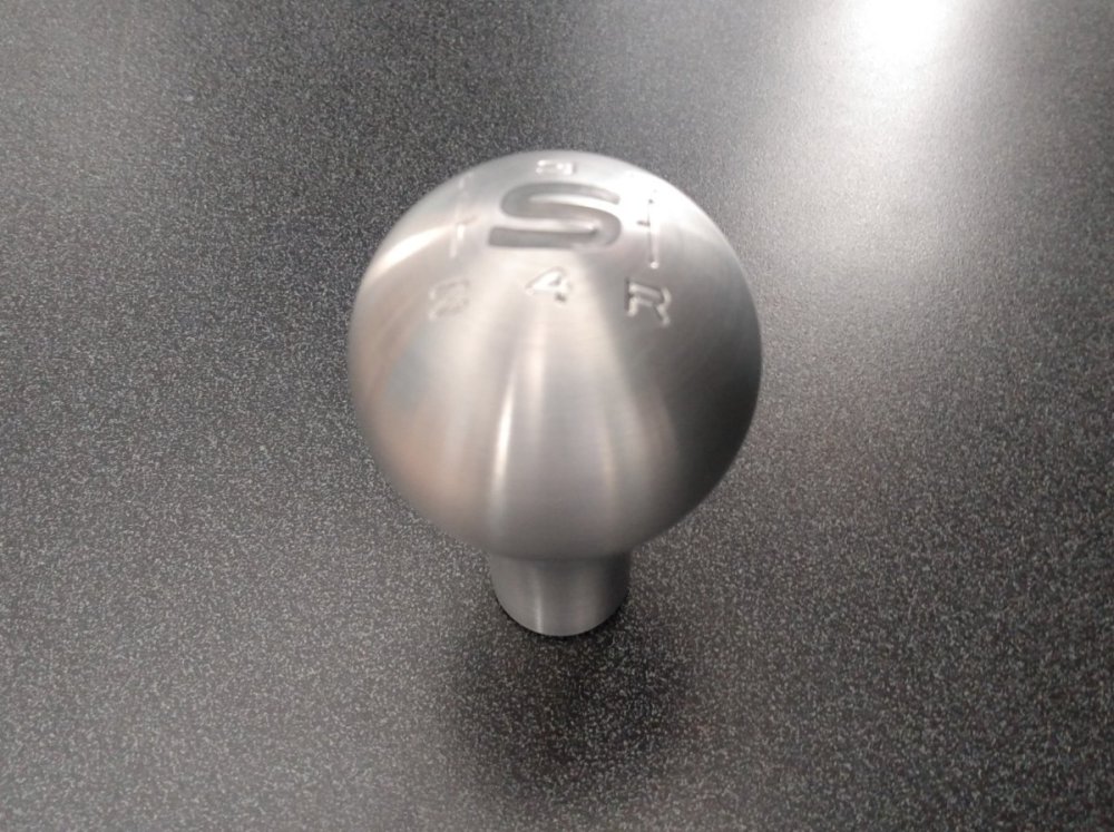

11Budlite Posted Monday at 06:38 PM Posted Monday at 06:38 PM (edited) One of the things on my 310S that I never really liked the appearance of is the gear knob that comes stock in grey paint. The 'R' models had a much better looking black painted finish. To me the grey finish of the gear knob and gauges looked like they belonged on a 80-90's Nissan Sentra. I liked the weight and feel of the stock knob so decided to see what I could do to change the look. Since it came from Caterham with a small nick in the knob I didn't have much to lose. So I cut off the head of a bolt (M10x1.5 IIRC) and chucked it up in a drill press. About 15-20 minutes later after using various grits of emery cloth and red scotchbrite, I had a nice brushed aluminum gear knob. And the nick was gone too. I'm not sure if I'm going to paint the shift pattern again but to me it looks so much better than before. Edited Monday at 06:39 PM by 11Budlite 2 1
