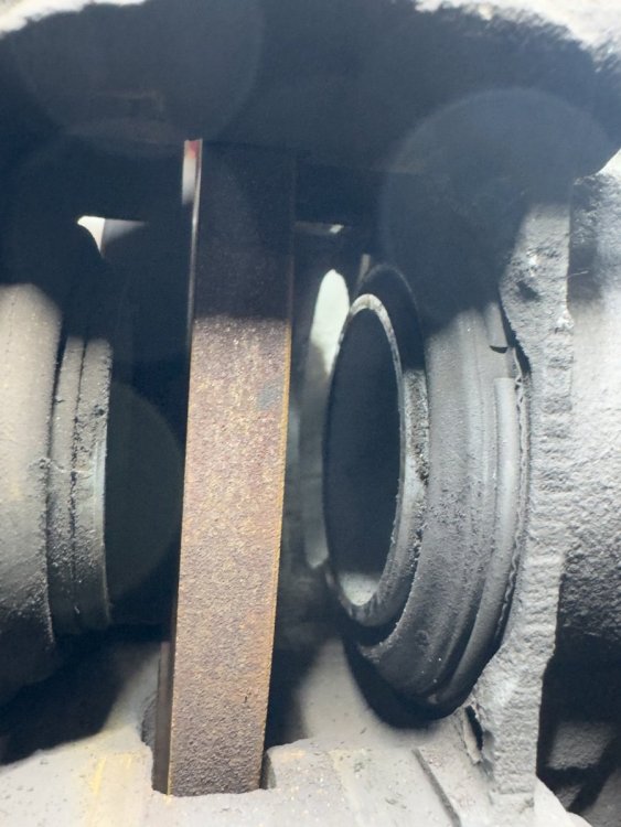

  5. In the sate of CT (which is a difficult state for registration) I was able to register my car as a Lotus 7 Replica and was allowed to select the year of the car it replicates. So my 2009 7 is registered as a 1967. Perfectly legal in CT and being registered as over 25 years old results in a tax valuation of $500 and essentially waives the high property tax we pay on cars.

  8. This popped up when I was in YouTube. No specific mention of Caterham tires in the video:

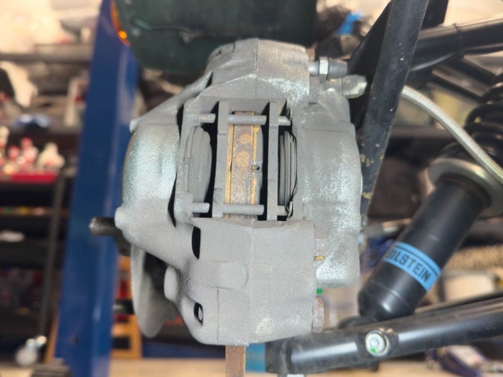

  10. I have owned the car since new so this did not happen. No problem with the brakes til now. I have 13K miles on the pads with about 8 track days and maybe a similar number of autocross. Not sure how fast this wear happened. I probably have about 1500 street miles (no track and maybe one autocross) since I last bled the brakes and would have looked at them. Don't recall it being uneven at that time (but I may have just confirmed I had adequate pad thickness and not noticed the uneven wear).

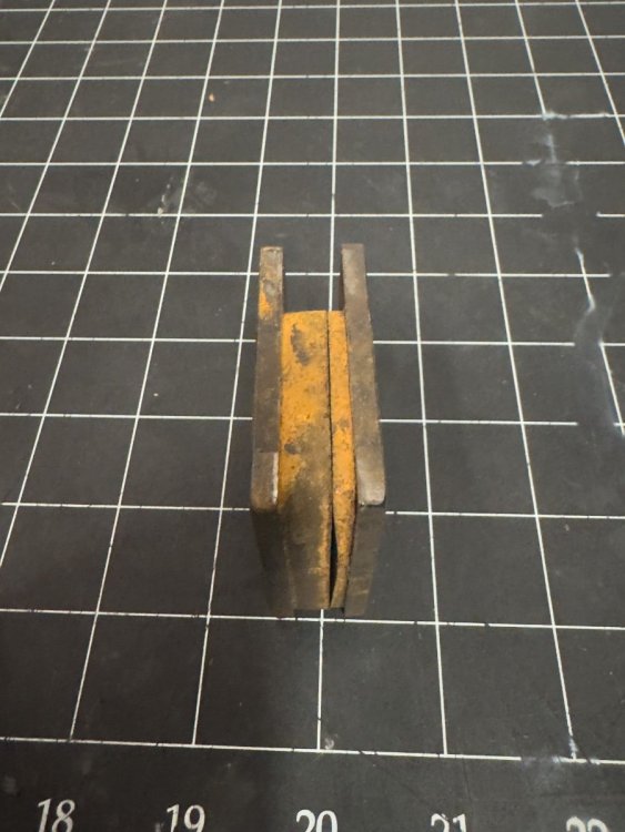

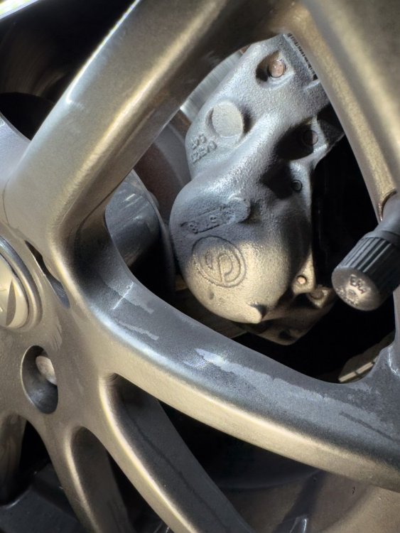

  13. My front left brake has experienced very uneven brake pad wear. I would suspect this is a sticky caliper that needs a rebuild. My car is a 2009 SV with the standard brakes. Can I confirm these are Girling type 14 brakes as used on Spitfire MKIII (and perhaps some Elan and Europa?) I don't see any obvious leakage, I plan to order a rebuild kit from Moss Any recommendations on brake pads. Car is primarily street driven with some AutoX and occasional track day. Moss Motors sells a pad made by Classic Gold and is listed as ceramic for the Spitfire. What are the pads Beachem sells (they areabout twice the price) Any comment on the cupping of the thin pad as shown in the picture
