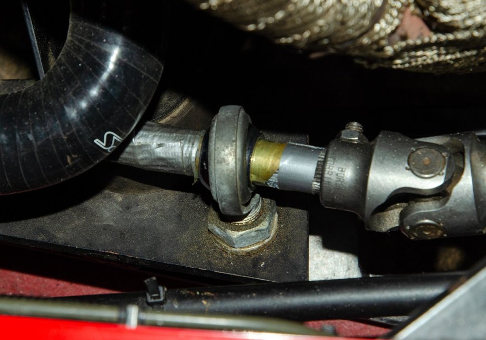

That's basically what I did. Here's a bad picture: The heim joint is bolted to a 1/4" steel plate that's under the rubber isolator in the motor mount. Not exactly "add lightness", but I figured overbuilt was good here, and the extra 6mm of ground clearance couldn't hurt! The brass and duct tape junk is an attempt from last summer to get rid of some play because the shaft doesn't fit perfectly into the heim joint. It didn't really seem to make any difference. I've always felt like there was a tiny bit of play in the steering. But at this point I think that's just an artifact of all of the U-joints to get around the exhaust and convert from Japanese splines to US splines to British splines. I'm pretty sure the plate is stiff enough, and I don't feel any motion from the engine.
