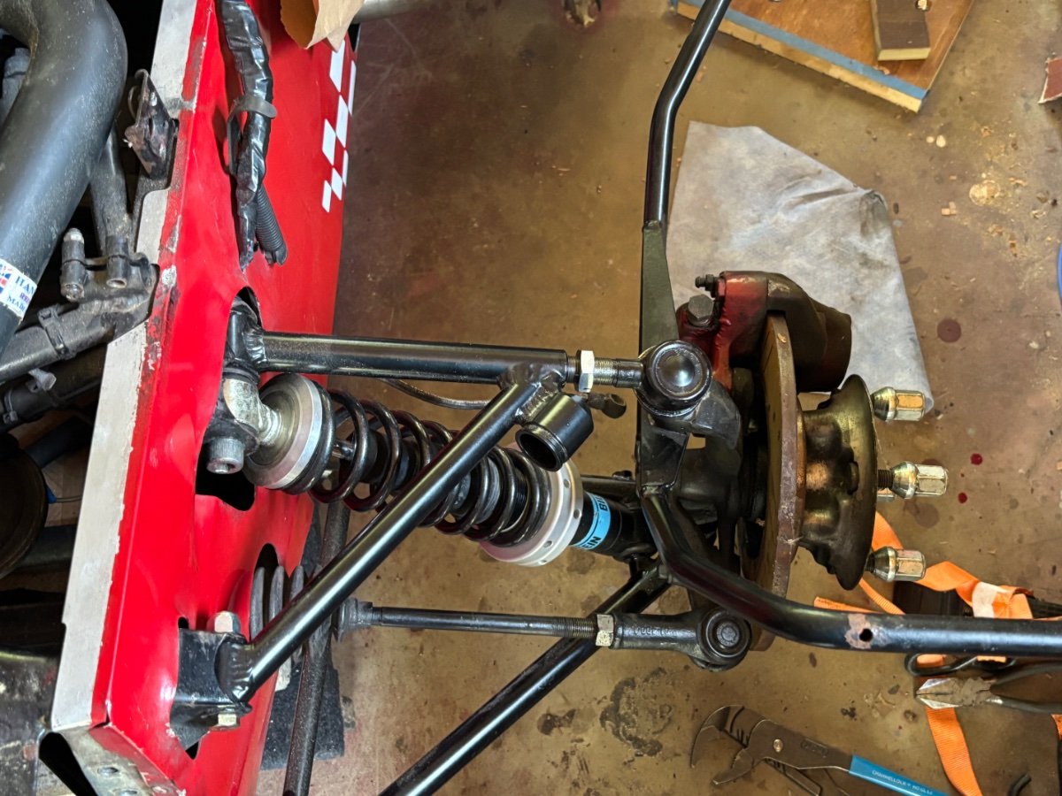

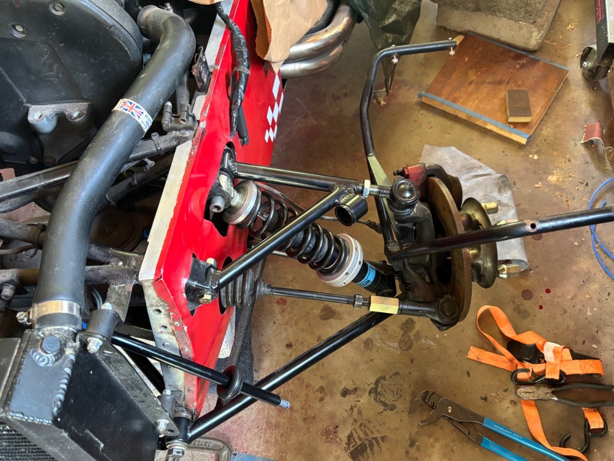

The sleeve that’s inside the frame upright. The originals are 1/2” ID and 11/16” OD. I can only find steel sleeves that are either 5/8” or 3/4” OD. I can reuse the old ones but I’d like to replace if I can given the inside is slightly oblong due to wear. Edit: I just discovered that the inside bushing sleeves in the wishbones are exactly the same, and since I’m upgrading to a wide track kit I’ll be able to use one from the old lowers.
Thats what I’ve been calling them, maybe it’s not the right term in this context. I’m talking about the mounting sleeves for the lower wishbones. They are brazed in place, and while they still seem fine as far as play, they are worn slightly oblong, like just barely noticeable to the eye. I haven’t measured it exactly. I don’t know if there is a spec for what’s acceptable wear. This is on a 1992 Supersprint Originals are 1/2” ID, 11/16 OD and 1 1/4” long. I can only find 5/8 and 3/4 OD in steel. Im afraid the smaller won’t be strong enough and the latter would weaken the 1” tube frame at that point by reducing the material in the tube. I could use bronze but that might wear faster, plus I have zero experience working with bronze.
Making some repairs to the lower frame, I have the opportunity to replace the trunnion sleeves. Originals aren’t bad but are 30 years old. They are steel, 11/16 OD 5/8 ID and 1 1/4” length. Closest I can find are either 5/8 or 3/4 OD. Any issues using either one or would I be better off just using the originals?
