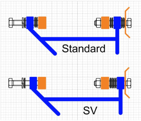

Hey Bruce, thanks for the reply, interesting article. I am changing my S3 narrow track to wide track and got the parts from Meteor, they buy them from Arch so genuine parts but came with plastic washers, an no chamfered washers. I am going to try the 0-4-0 setup, its pretty easy to change so I can do that then see how it performs. Bart.
Hi, I am just fitting the front suspension to my S3 with a wide track setup, it came with a selection of plastic and metal washers. I have read that there should be metal washers only so Hmmmm. I discovered that Caterham used to say put metal chamfered washers in the 0-4-0 arrangement for the lower wishbones but now suggest 2-2-2, in addition there was a difference between standard s3 and SV, as I have an S3 but with the wide track I am wondering if there is some knowledge out there I can benefit from. So two questions:- 1. Should I use the plastic washers or just use some plain washers I already have that are the right size but not chamfered 2. What arrangement would work best on a track oriented car Thanks as usual Bart
