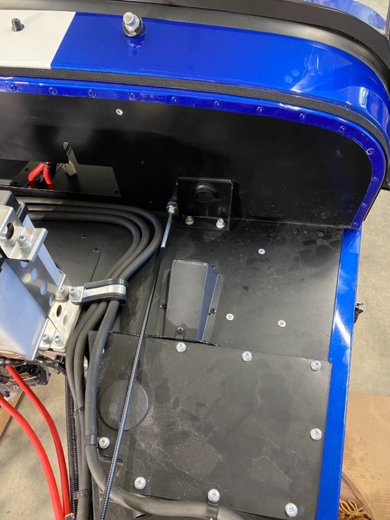

  8. Got the airbox trim done, throttle cable, rear fenders and rear lights today. I am confused as to why people resorted to bending the throttle pedal- plenty of room to adjust cable and set throttle stop in footwell. Plenty of progress this week

  22. Sadly, Jeremy Clarkson is my spirit animal, not James May. So, I just jumped in to drilling a new hole through the firewall in more or less the same orientation as my existing hole (just the mirror image)- no measuring, just a quick check under the dash to avoid drilling through the fuse box. I also used a foam brush to guide my height (coincidentally it was about the right height to set the bottom edge of the washer). Before: During: After: I should also note: the predrilled holes for the heater box bolts were way too small- drilled those out too. Added a bit of Rustoleum black to all holes after filling them down a bit- again, sadly being closer to Clarkson I used my finger as the paint brush (but there is hope for me as I used a disposable glove = partial credit. Not to mention I will find something to plug the factory hole, not just leave it open). Plan to do the expansion tank next. Why not? I’m now drilling holes hither and yon, might as well keep it up.
