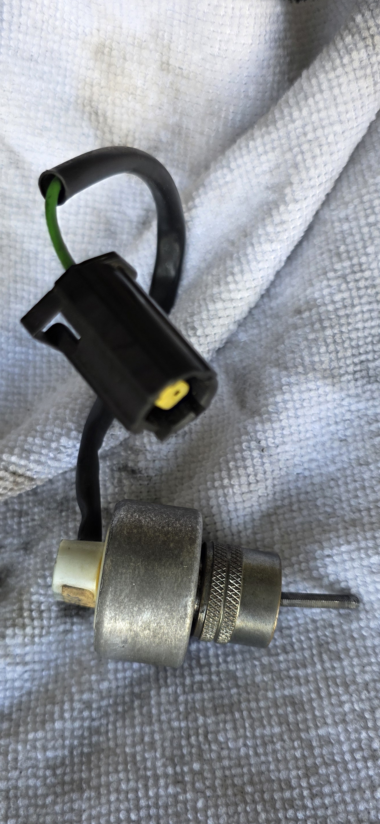

  4. There's nothing wrong with that one in the picture because it doesn't belong to my car and engine. My engine got rebuilt and came back without that stud. The guy who rebuilt my engine told me any stud will do, but so far, none did.
  5. First off, don't buy a Seven with a Zetec! Parts are for most of it discontinued and it became a nightmare! Next time something happens to mine I swap another engine in it! I'm looking for a knock sensor stud (see attach), the original part number is w707046-s309. Google search gave no results, only stores saying it's in stock, while it's not. If anyone knows a replacement/substitute part and have a clue where to get it, I'd be super grateful!
