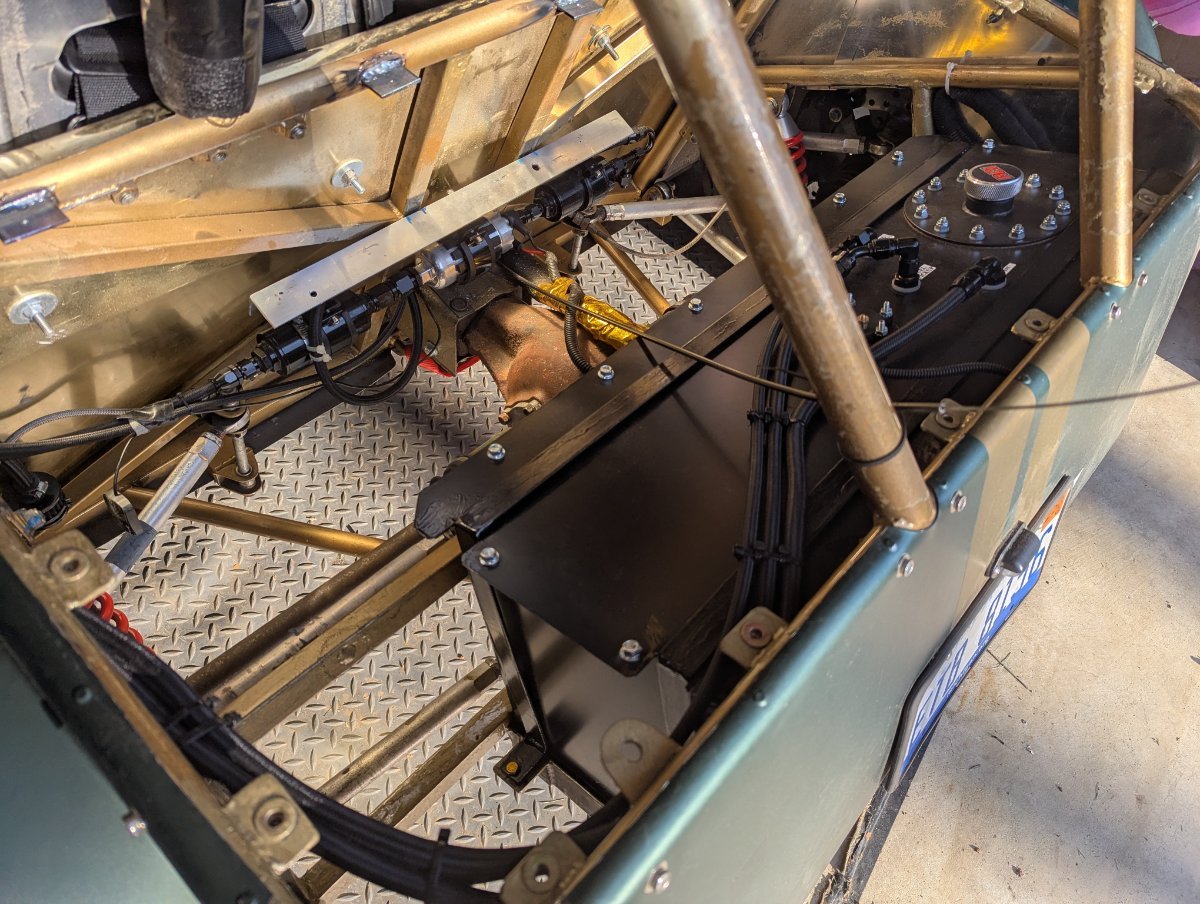

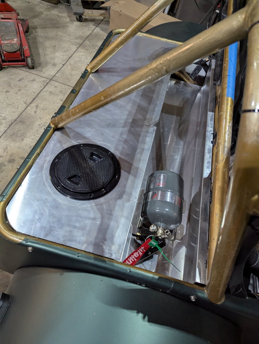

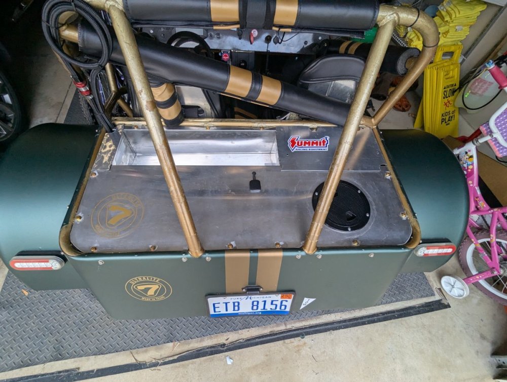

  8. Couple updates on this I had racer choice inc make an SFI fuel cell that fit in the back space. It got a holly hydramat which should solve the fuel starvation situation without extra transfer pumps etc. Welded some tabs on and covered everything with sheet metal per our tech inspector at Waterford. This car is now approved for door to door action in SPU

  12. Seriously. I am getting priced out on this deal. Might make more sense to do SCCA spec racer Ford from a money standpoint. But the WCM has come this far, its getting pushed over the finish line for tech. Hopefully the next company that is quoting it comes back much lower.... or else it gets a pre-made option.
  13. Looking like this might be the way. First quote I got back was $6000 for a retrofit of the original WCM tank.
  14. Thank you, I already have a call an email in to Pyrotect. Let's see how much this is going to cost!!! Exciting!
