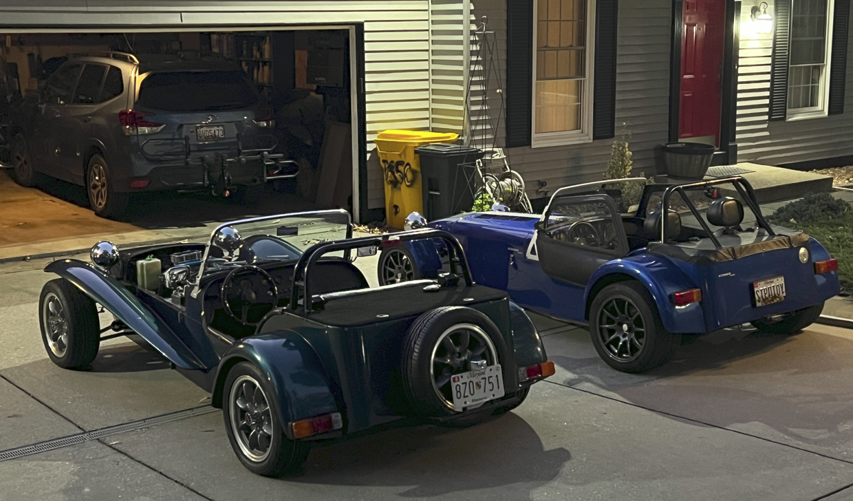

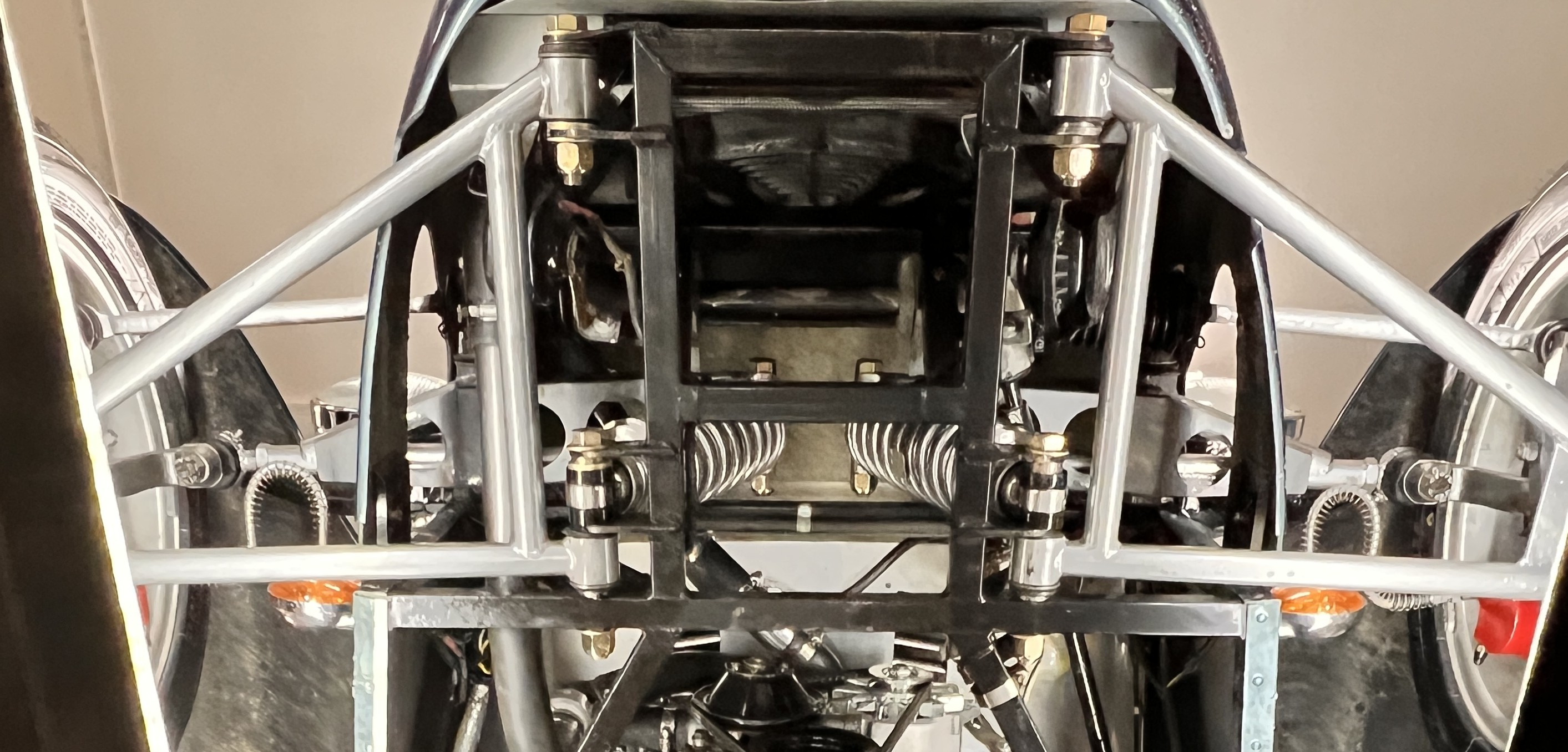

  7. @demoray made my evening... nice chat Stunned to find the CSR is nearly identical to the Rotus dimensions. Wheelbases within 1" dash cowl edge to seat back top (cabin fore aft) and even their rakes, are nearly identical.The Rotus nose is 1" further forward. But the CSR bonnet is nearly 9" shorter than the Rotus. ( test fitted the CSR on the Rotus). Rotus is longer outback with it's full depth boot. Both run inboard shock configurations. We found the CSR is 17" wide across the seat base as well. The CSR seats will fit a Rotus ...fun night.
  8. Would love the in person comparison, even if just side by side looking over both vehicles. I'd restored this Rotus to as original condition as possible, being it was still mostly still all as built, and bringing it home back to MD. But that mind set is now changing. Seat wise, and considering what I've already spent, the Miata seats on the shelf were simply a super cheap alternative to full up Cat seats. Hmm..... Wednesday, the wife is tied up so my day is free. (Retired here so all day every day really)
  9. MY Rotus anyway, is spot on 17" Miata seat base pan is 16.25" +/- .2"
