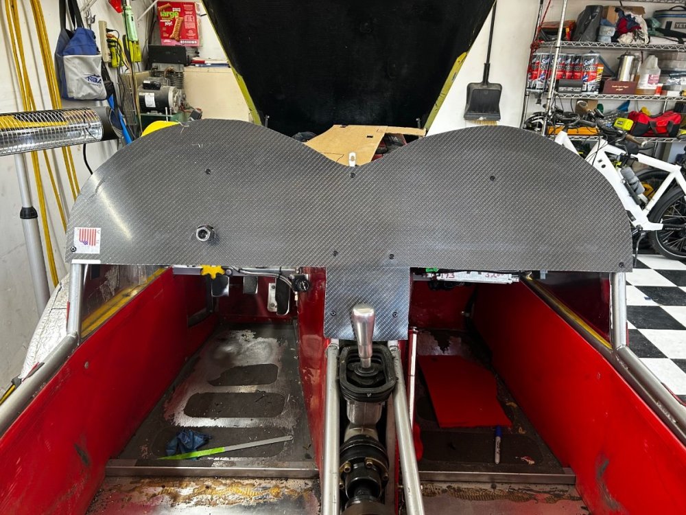

  1. Now I just need to install a shift boot. Going to make the surround out of the left over CF from the dash.

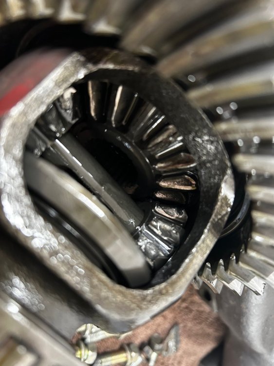

  2. Yes it is a R160. Searching around this looks like a common failure of this diff.

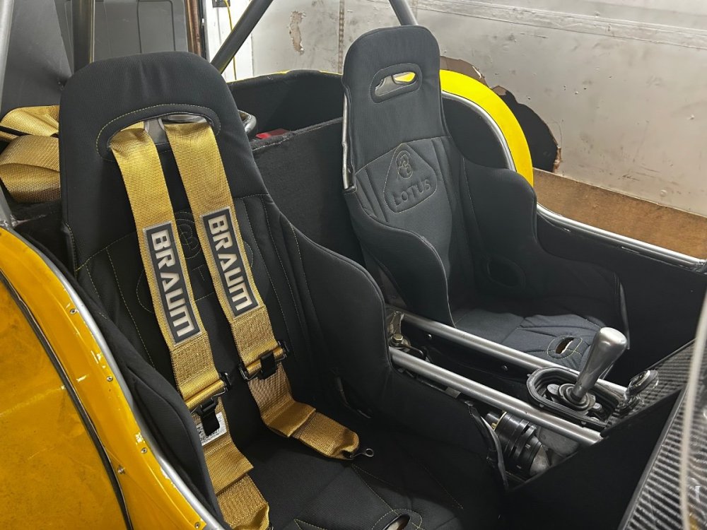

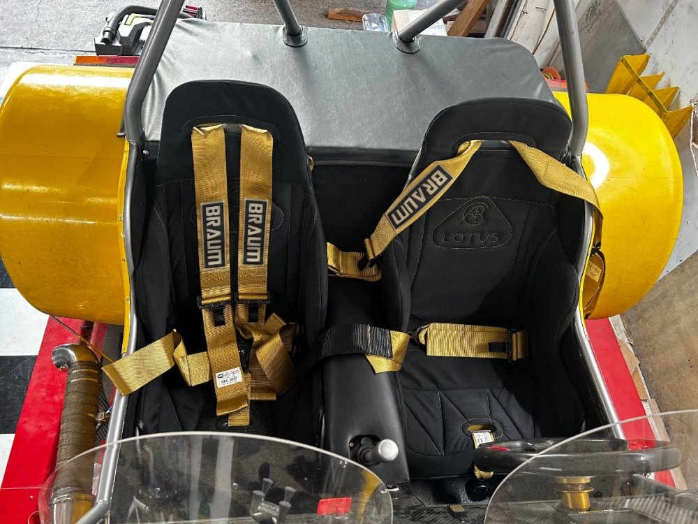

  3. Some more progress. Since the stock rear diff was spitting teeth I have replace the LSD with an MFactory one. The seats and center console are done. I have covered the back sides in carpet. The floor I have done in truck bed coating. Placed the seats and seatbelts in to see the look. I am happy with the colors I have picked out. Need to get the center cover installed, seats permanently installed and rear end alignment. Then it will be ready to drive agin.

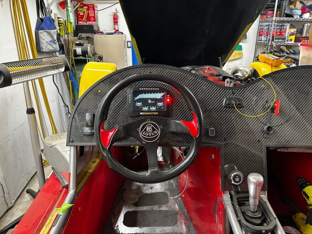

  7. Have the mounting done of the ADU5. Basic power and ground hooked up. Running wires for oil pressure, coolant temp. Need to get all the sensors installed and wired in. But working on the basic programming/layout of the display. Here is what I have so far.
  8. Got the rough cut done and the attachment screws drilled. Now a lot of sanding to get a good fit.

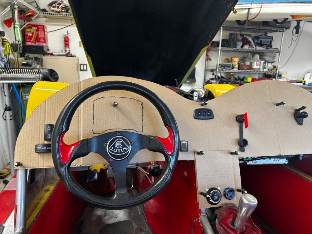

  10. I have the CF on order so I went ahead and utilized my masters I have in CAD design this weekend. This way I can get my layout figured out prior to doing the cutting on the CF sheet. I found some different switches for the lights that will simplify the layout. In removing all the breakers this is going to make the right side empty. This will be a good place to mount the holder for the Garmin Catalyst. Tried to take the picture from where my eyes will be.
  11. I did some measurements below the dash and where I have my seat I think it will be too low for me. Will do some more measuring after the seat is redone and prior to cutting a hold in a $800 piece of CF. Also thinking with it below it may not work with the placement needed for the ADU. This project will be measure a dozen times or more and cut once.
  12. No ECU upgrade plan at this time. When/if I do will probably go with the EMU Black. I really like the MoTec I have in my Evora but probably will not go that route for this car.
  13. Starting off the new year with the dash project. I was able to disable the key anti theft so I got rid of the key it had installed just for that. With that going to redo the electrical and install a key fob, push button start and stop. Get rid of all the mechanical gauges and go with a ADU5 display. Change out the dash to a CF sheet.

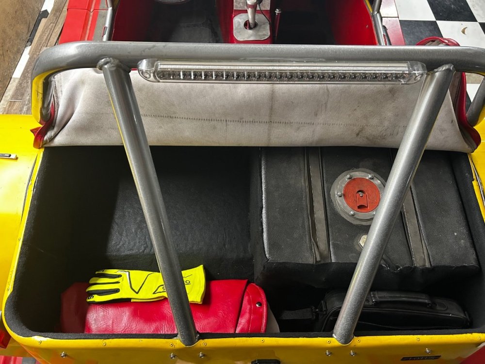

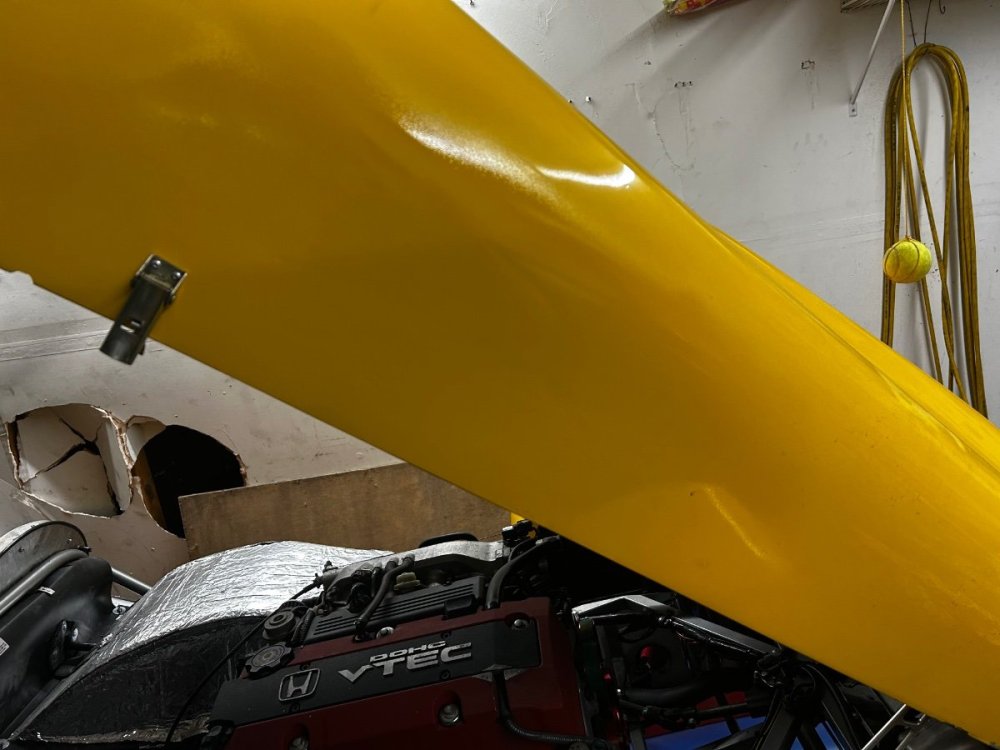

  14. The trunk area was just a tank, bare aluminum and the fuel pump/filter. I moved the pump and filter back to underneath and finished out the trunk with some black interior carpet.

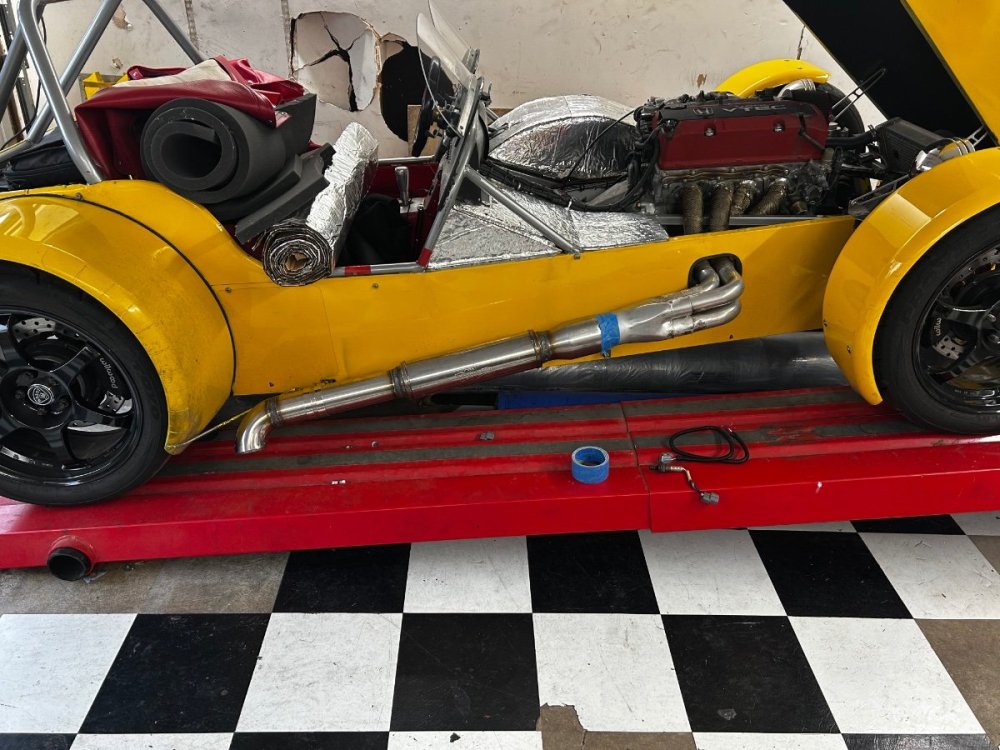

  15. Planned right now is, finish welding up exhaust. After that installing a Digital Guard Dawg PBS1 for keyless and pushbutton start. looking int a CF dash and replacing the instrumentation with a ECUMaster ADU5.

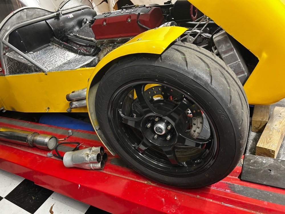

  16. Exhaust is a Holly flow master cat into a Holly flow monster muffler, basically glass pack. No tracks around here have noise limits.

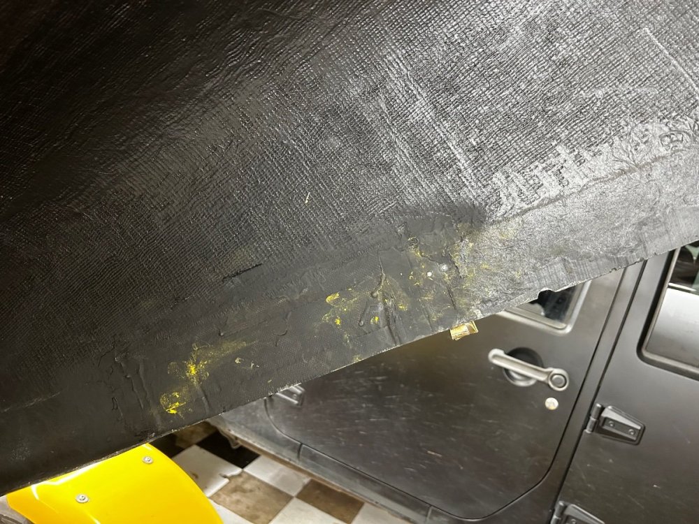

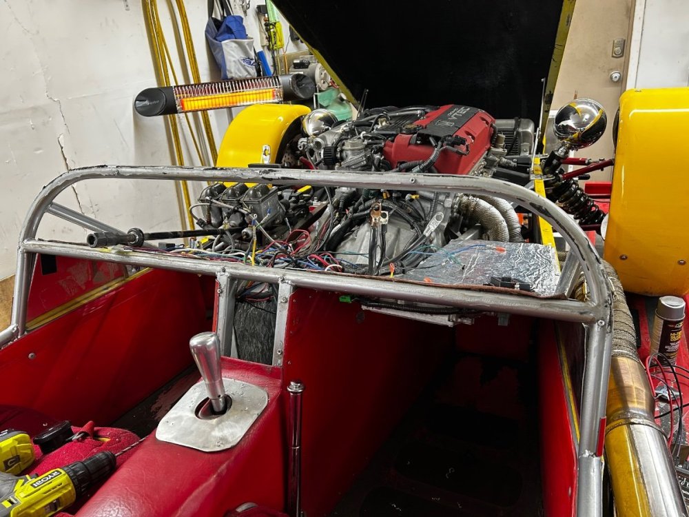

  17. The previous owner did put a heat vent over the exhaust. I am sure this was great for getting heat out of the engine bay but it did dump heat out of the right side that swirled into the passenger compartment. I removed the vent and did a fiberglass repair and paint touch up for now. My plan is to respray the entire car so this will have to do for now.
  18. While I had the exhaust mocked up had to try it out even though it was taped together at the collector. Apologize for the feet in the video.
  19. Also gettin closer on the exhaust replacement. Have the major part welded up. Have remove the collector and cut to fit the cat. Mocked the system up to verify fitment and alignment.

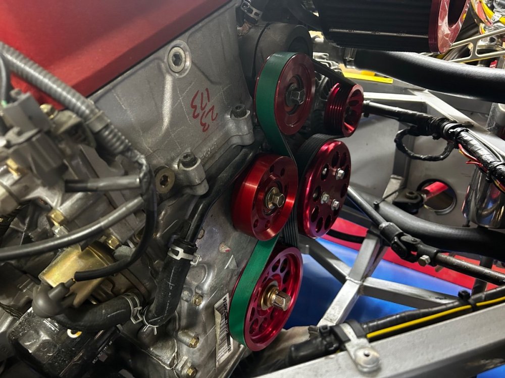

  20. Next project is I purchased a set of pulleys from Non Stop Tuning. Also put a gator back belt on.

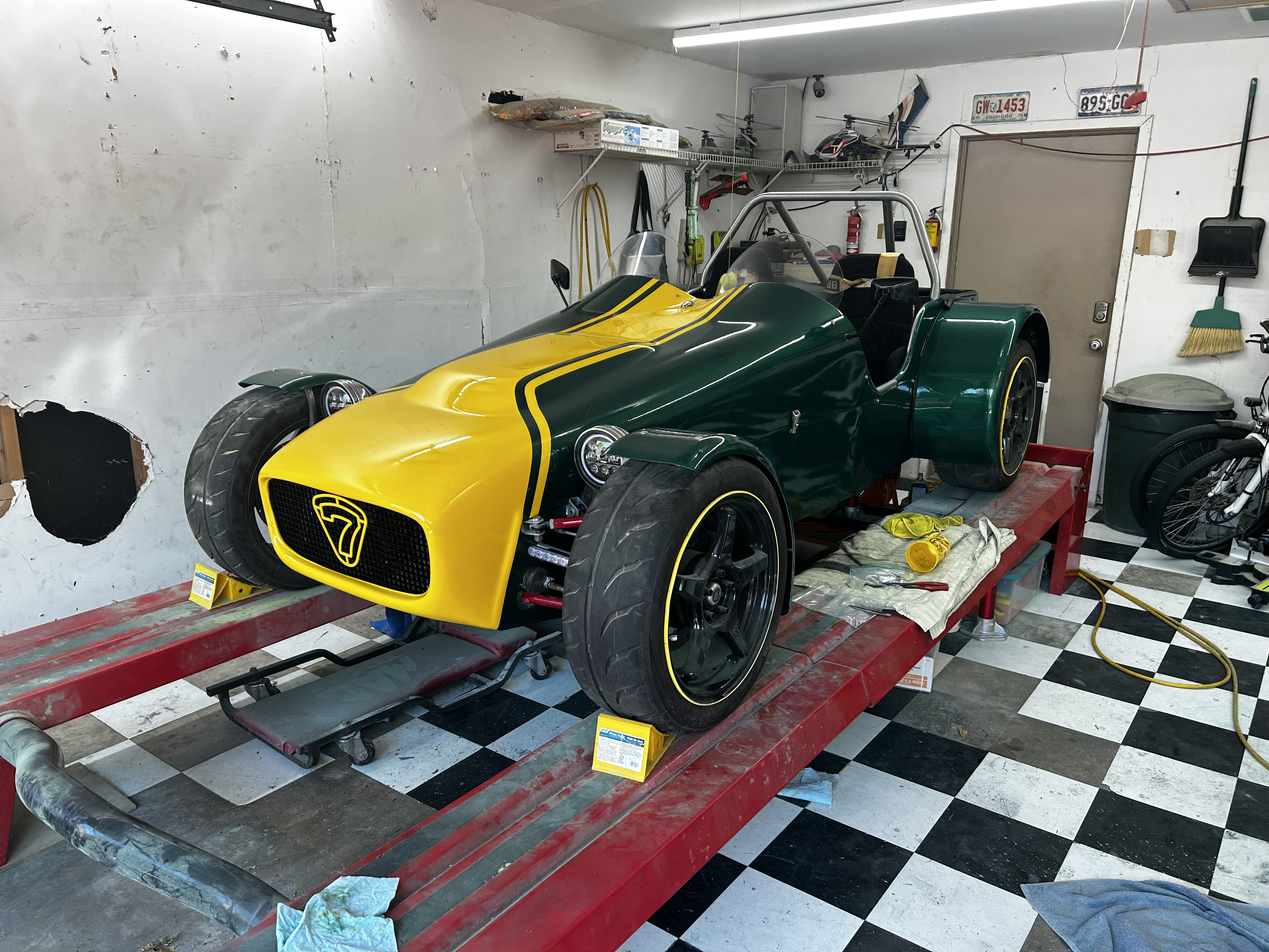

  23. I am not sure what spring rates were on mine. The manual calls out for 400 or 500# springs on the front. When I got mine it has a motorcycle type rear shock that rode terrible. It had a front sway bar that I took off. I took all the shocks off and replaced with new double adjustable QA1’a DD401’s with those I had to reduce spring rates a lot. I ended up with 220# rear, and 300# front. The fronts fit fine just installing upside down. The rears I had to install upside down and move to the inside of the upper mount to clear the driveshafts.
