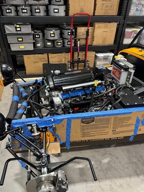

Thanks for the advice on cooling. Got it figured out. My car did not come with any heater so no need to cap, just run line that includes temp sensor from oil cooler through a routing behind the head where you create a route for the submarine to the normal entry point of the submarine line. Photo below of engine installed. We were concerned about difficulty and time, but we did some test lifts playing with angles and distances and were able to get the install done in three hours. I think the key for us was having some high jack stands and an engine hoist that had good reach. I had seen a a lot of discussion about protecting the heat shielding in the tunnel and difficulties removing whatever was used. We ordered some flexible plastic sheeting just a few mils thick. Think of the type of office chair mat, but much thinner. We wrapped it over the top of the transmission tunnel in a u shape and just taped to hold. It did not impede entry and once we got things in position it was easy to pull out right before we installed the transmission brace. We still haven't received our roll cage. It has been a comedy of errors with Caterham not sending, then due to confusion giving ours to a car being built in the factory and then a supposed difficulty getting another from the fabricator. As of this moment we are waiting on confirmation that they are sending. They have told Josh they are going to air freight directly to me. I remain skeptical. Josh has been great through the whole thing, but we are very close to hitting a point where we can't go further without redoing things later so that is a bit frustrating.
