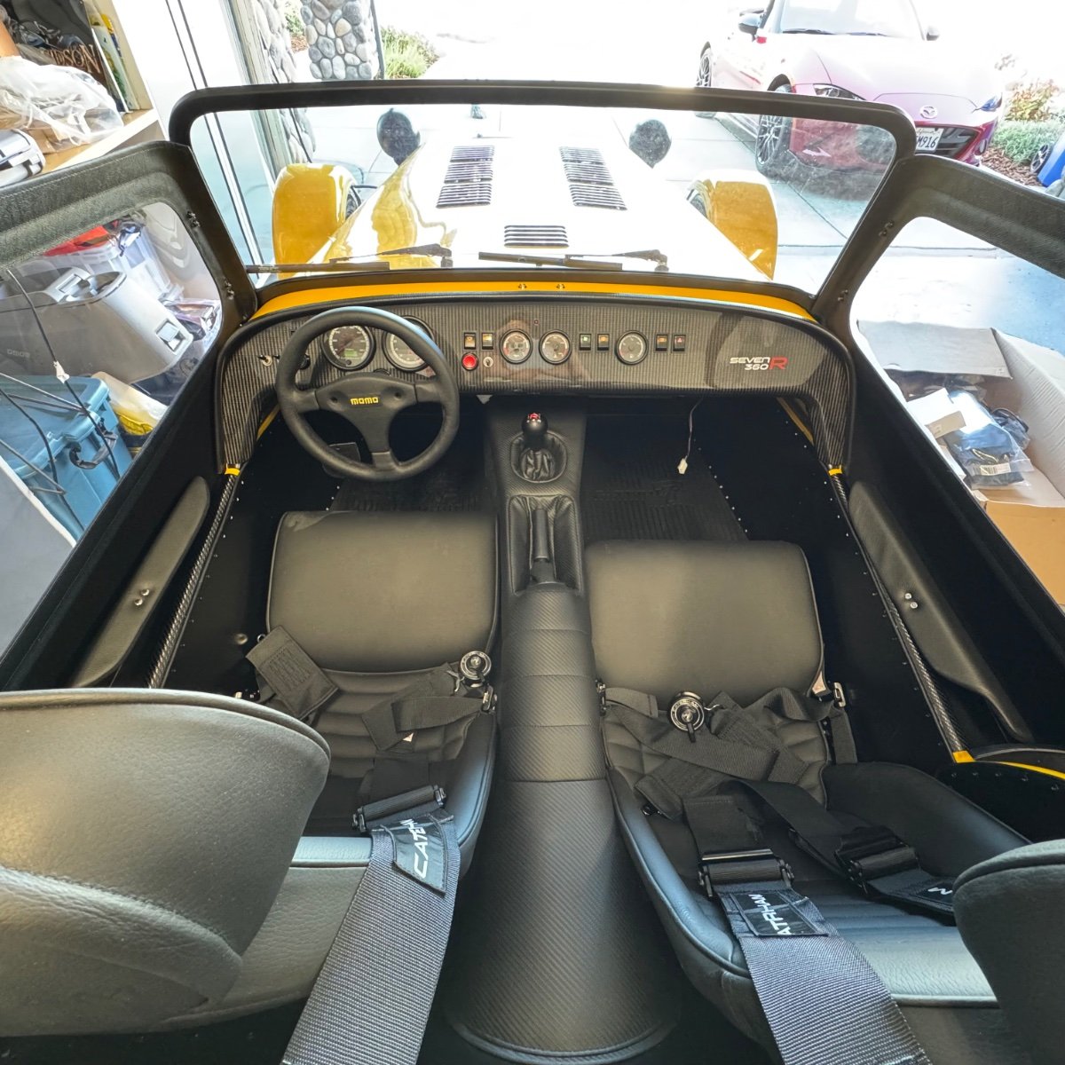

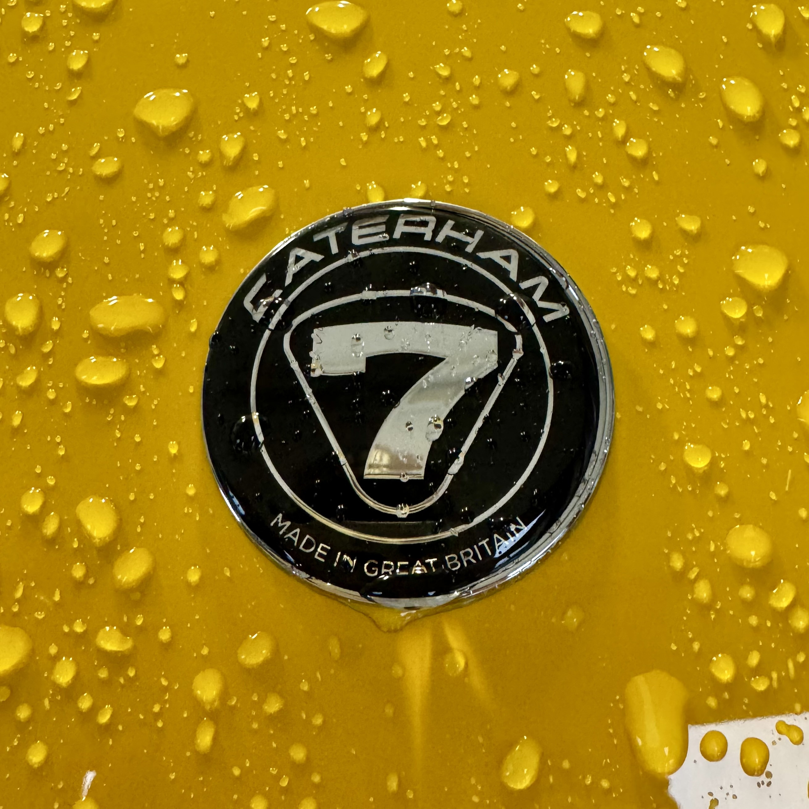

  1. Am now enjoying my fully registered Seven and working on some final touches. This build plaque is one of my favorites.

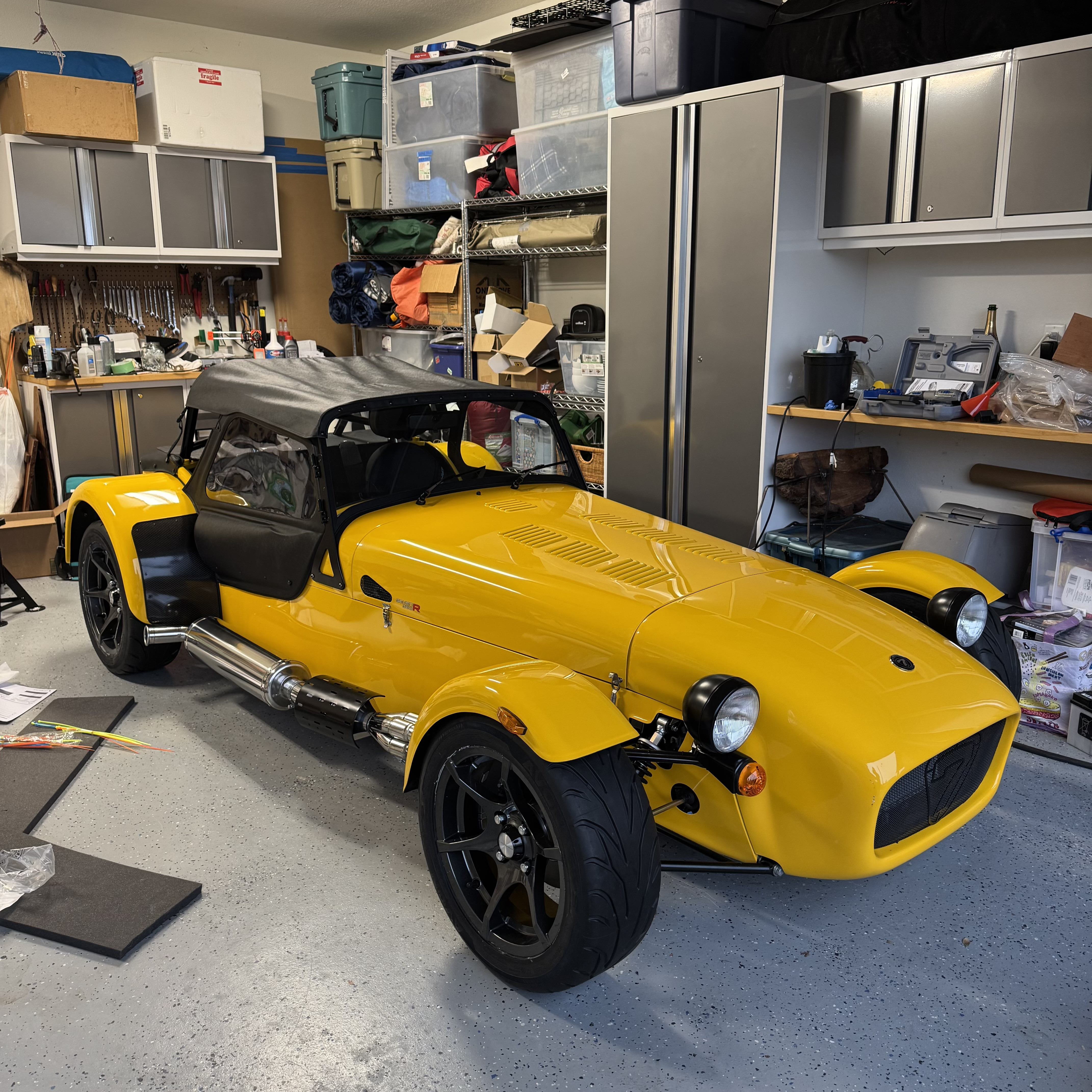

  5. Plates obtained! Finished the last of the SB100/SPCNS process today, with the in-person referee inspection following the virtual BAR inspection. I've got a wet sump duratec, and the car as assembled does not have a closed-loop PCV. Most documented SB100 cars here have a dry sump, which requires a different solution. The wet sump has a PCV valve on the block (unlike the dry-sump motor, which has a blanking plate there). What was needed was to route the valve cover vent bank to the air intake (new hose and new hole drilled into the intake cover). Photos attached. Car passed both inspections, and the referee placed the coveted SPCNS sticker in the engine bay this morning. Following my final trip to the DMV, plates were issued! This forum was invaluable, as were the many detailed build blogs. See you on the road!

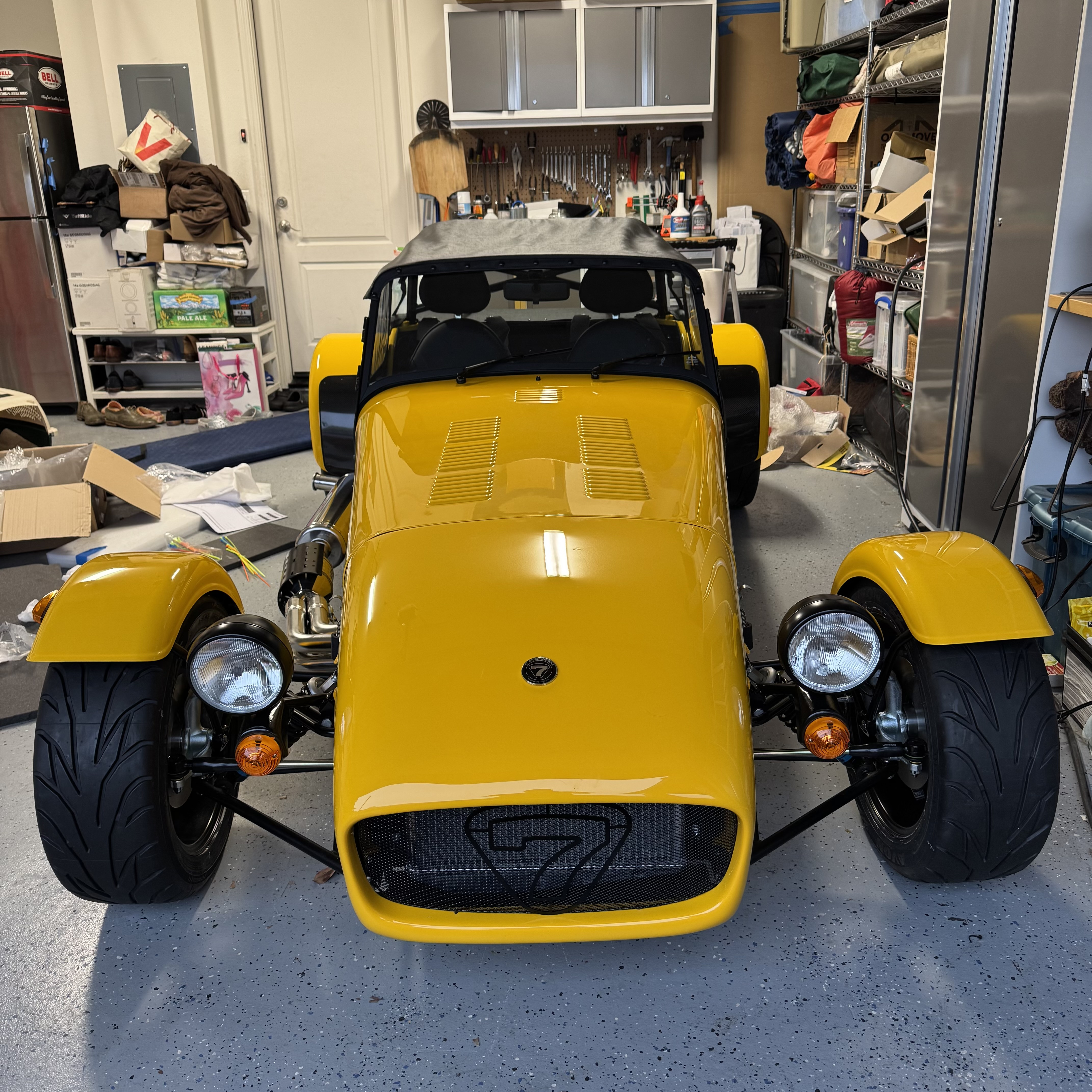

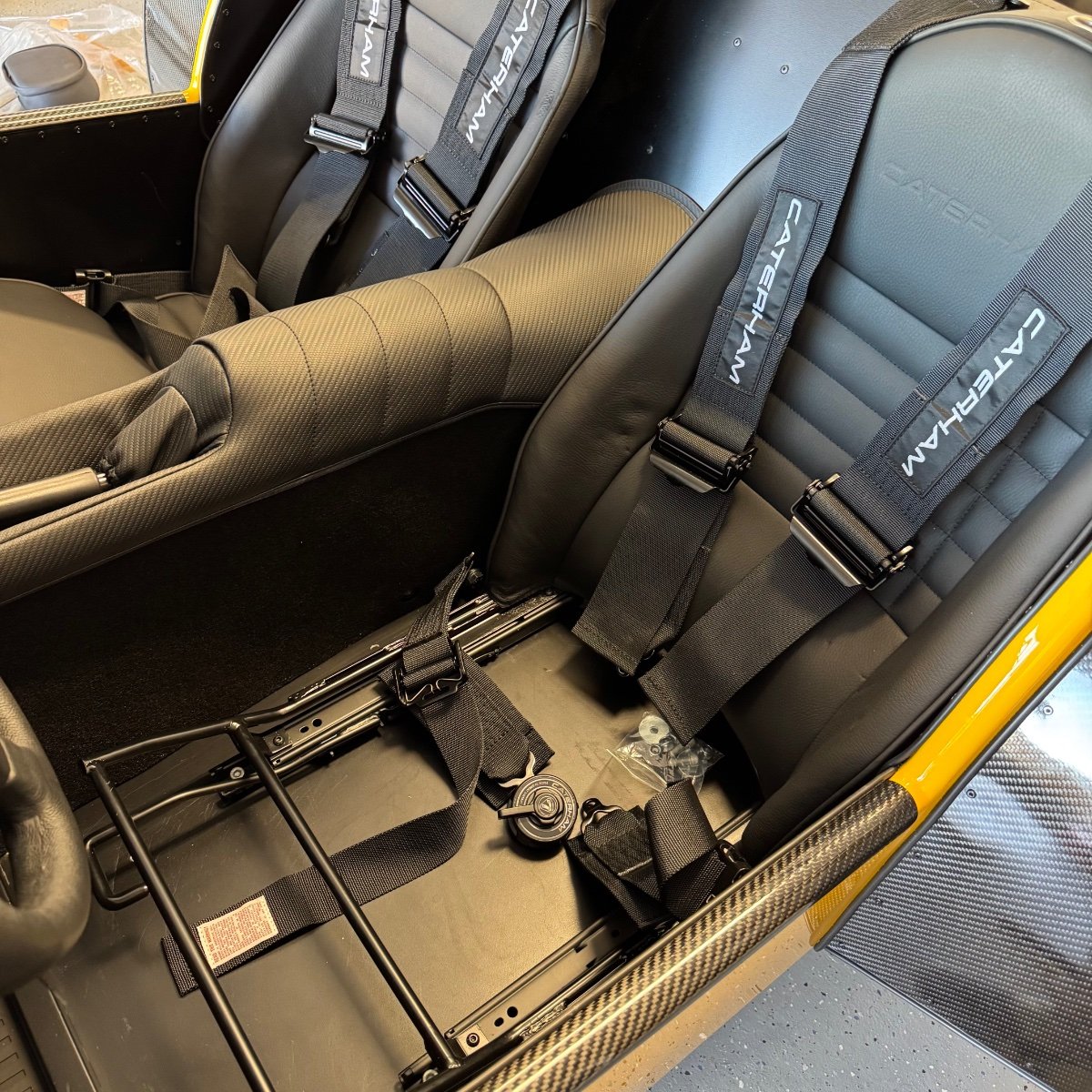

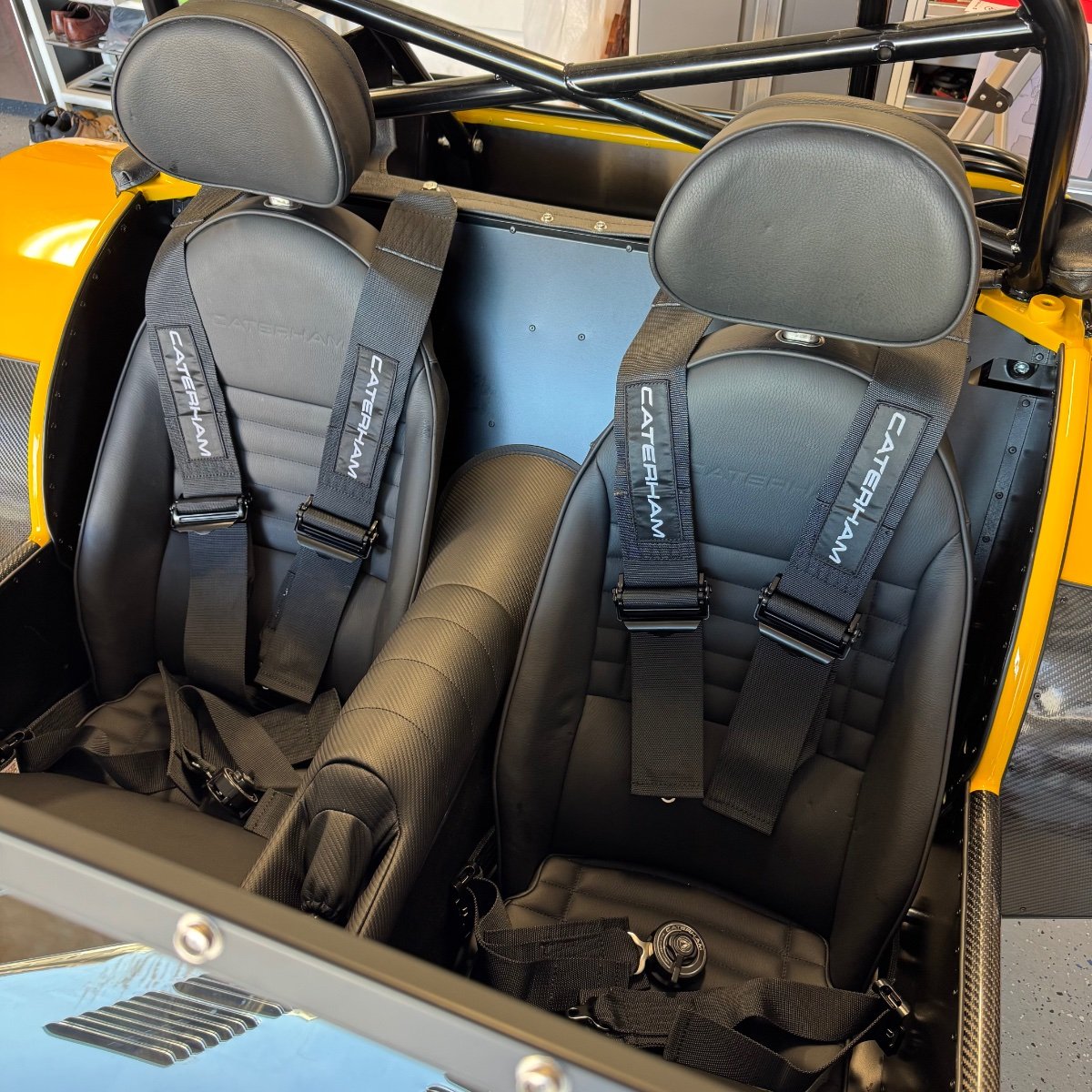

  12. Working my way through the SB100 process and getting some good miles on the car. Got the car aligned and she drives wonderfully! Now down to the last few small items (anti-submarine belts, snaps for floor mats, remaining interior rivers, etc). Plan to replace all fluids at 500 miles.
