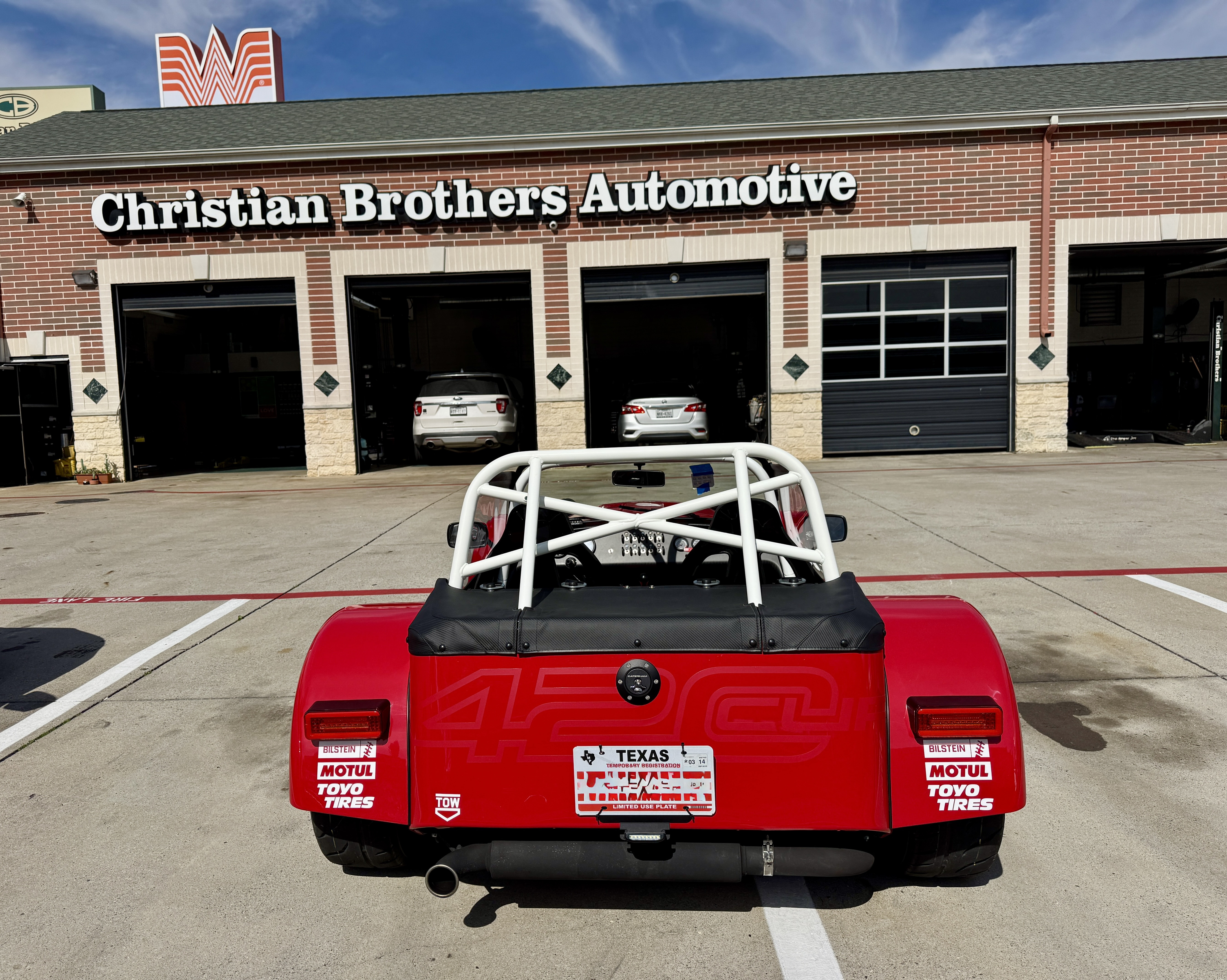

3. Filled out the Master tech VTR-82 form, then got the inspection done at Christian Bros Auto off HWY 75 near Forest Lane, only charged me 100 bucks. Really easy two work with (others Master Tech's I called, from Pep boys to dedicated race prep shop, wanted nothing to do it). Got the Master Tech to sign each box on the form, and took a picture of his Master Tech "diploma" showing everything current.

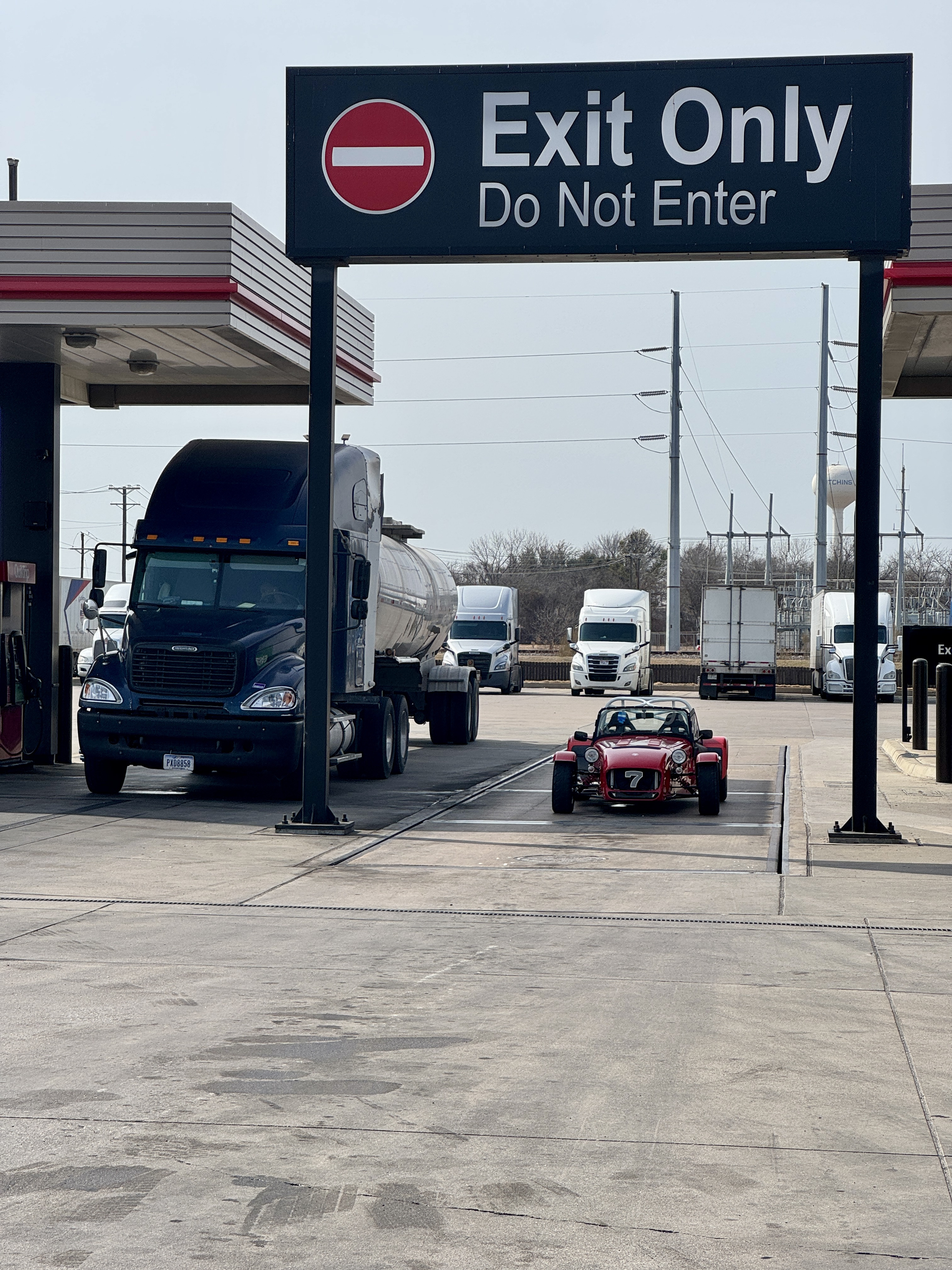

Went to the Quick Stop truck stop in Hutchins, got the SV fat boy weighed and issued a certificate showing 1340Lbs with 3/4 tank of gas. All the truckers came by to chat.
