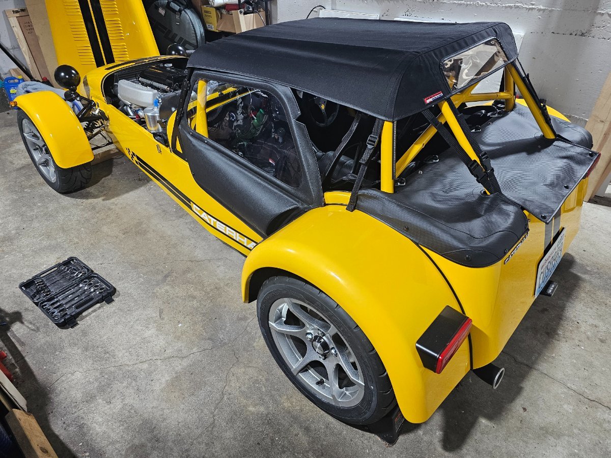

  13. Car is now PPF'd on the front cone and hood and sides (thanks Seattle Clear Bra!). Since then, it has been raining, and raining, and more raining, but finally found a day to do a little low speed drive around Lake Washington and sit behind slow drivers. The amount of public support for this car is hilarious. I had more than 10 people come talk to me about it. A car with three little kids U-turned and they all came running out staring haha. The mild dampness showed the supreme capability of these wider tires. Tons of traction. I also tried out the roll bar Spa mirror mounts I Macgyvered together with the extra DPR fixings they graciously sent me when I ordered their door brackets. The distance they are away from the car on the normal doors with the DPR mounts I find it very hard to back up in a straight line into a parking spot, and hard to judge rear fender distance to things next to me. In normal cars, the mirrors stick out to the same width as the car or further, and so you get great perspective for backing up. Not so in the 7. So, for the roll bar mount contraptions I made up, I flipped around the L bracket to get more distance. Much easier now! To minimize time spent converting between rain-mode full doors with DPR mounts and sunny day half-doors with cage mounts, I ordered a second set of Spa mirrors, the GT / Le Mans style this time which are a little taller by about 3/4 inch and wider by about 1-1/2 I believe. I also have a set of coilovers being custom designed for the car by MCS. To-do is measure the motion ratios and then remove the bilsteins to find the un-sprung weights.

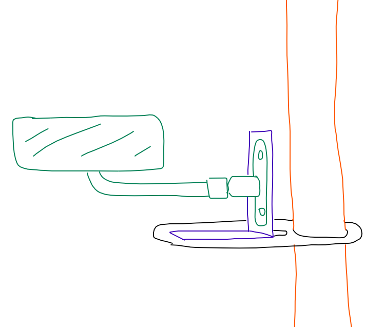

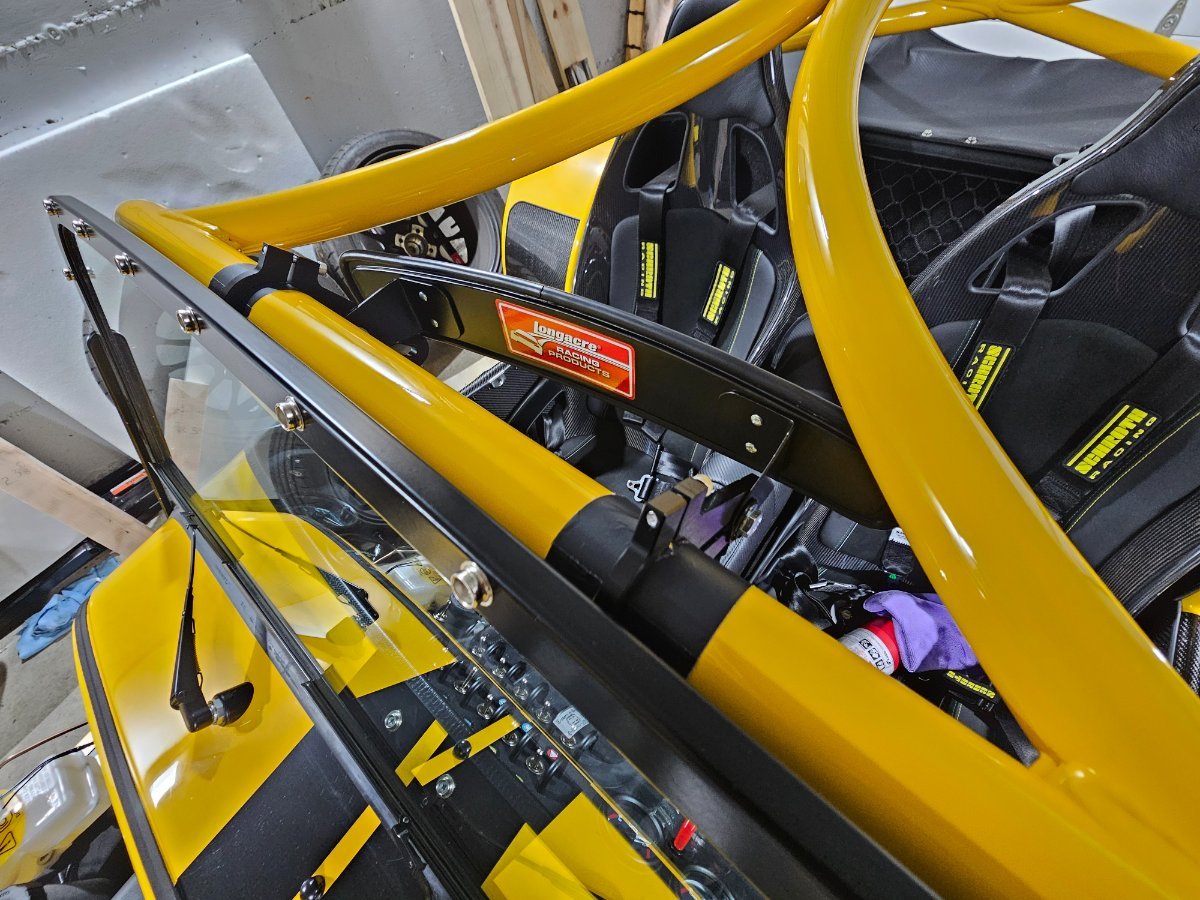

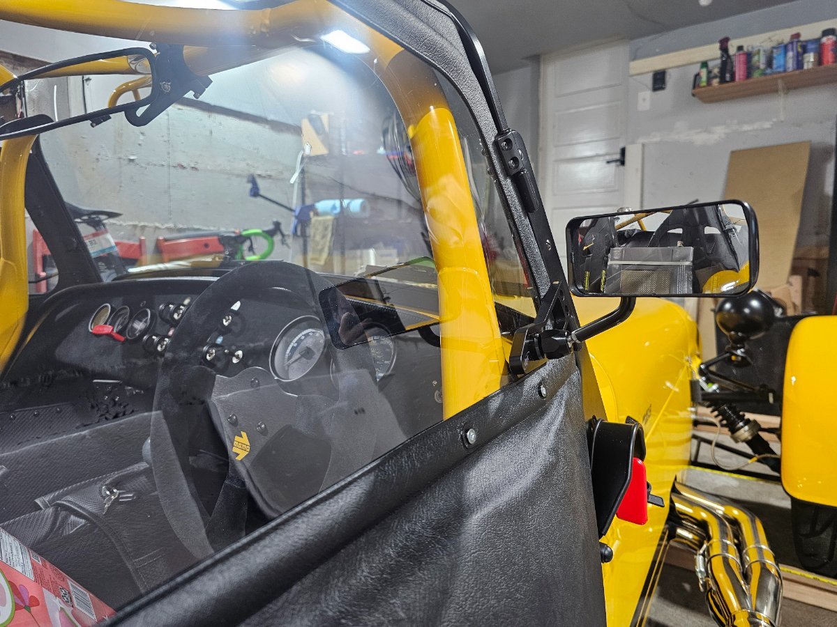

  14. Dash cam mount for my viofo a229 pro installed. Used a quad lock system on the bar so that it can remain there when running the aero screen. https://www.quadlockcase.com/collections/build-your-own?selected=eyJoZWFkIjoiUUxQLTM2MC1MSCIsImJhc2UiOiJRTFAtMzYwLUhDQiJ9 plus a standard quad lock flat face mount. Also have the 1.5" roll cage mount mirror brackets put together with some DPR block nut conversion mounts. The L bracket can be 180 turned to have the mirrors stick out quite far if need be. Also got a phone mount: https://amzn.to/4rHrL0E Next up is applying the ppf from Premier Paint Guard.

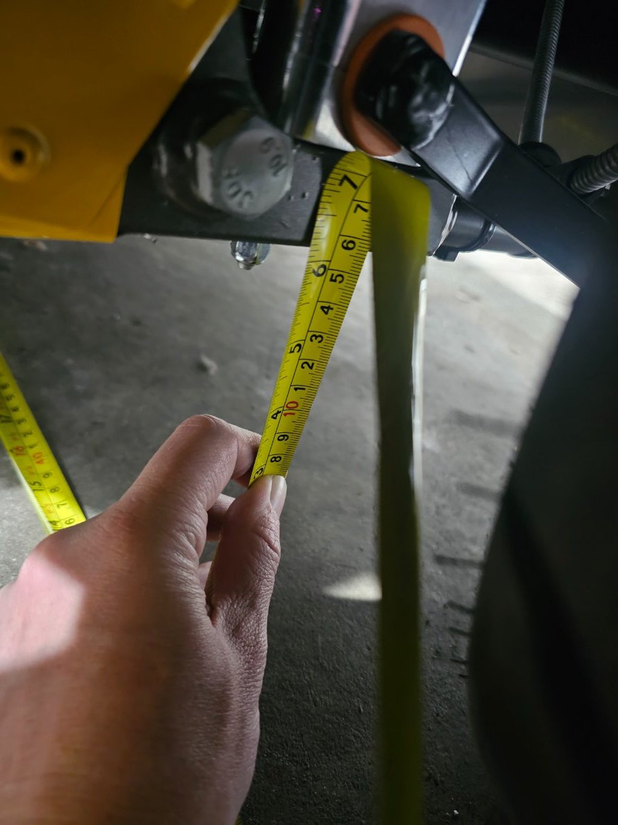

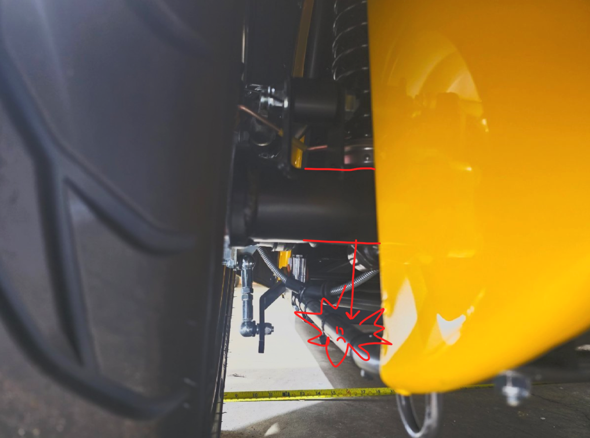

  16. Had no fishing wire, razor wire, nor 007 watch-wire on hand. Tried a variety of tools, in the end this puddy knife made short work of the rubber adhesive from the factory. 5 minutes a side pushing / rocking side to side half a width of the puddy knife at a time to get under the adhesive. No knife required. Lots of contact Other side too Time to bend, didn't need more leverage than a thick screwdriver. Bend back down with a spacer, hit it with a hammer while pushing if needed for the rear stays since it's hard to lean on it. Bingo Do for the other 3 Added two bead layers extra Sikaflex 291 on top to make the stays a tad taller to clear the inside of the wing. Thought about cutting some holes to get it lower, but I think it's fine. Once those dried, I added another layer to adhere to the wings and slapped them on. Bing bango Bob's your cousin? I'll add a bunch more from the underside once this dries in place I made the wings slightly more inboard to help reduce side of car debris /things going into my face since the sidewall will stick out just a tad when perfectly centered. Still covers outer tread
  17. I think that is the way to go, adding a washer/spacer on the knuckle connections doesn't seem like the greatest idea. Elongating the upper mount hole might work but then isn't centered. 15" I'll keep an eye on that for sure. I thought about this and decided bending would be faster, cheaper, and closer to the OEM scrub radius.
  18. Maybe I finally get to buy a welder?? Or does someone sell wing stays for taller tires? I think it's the 50 profile that's killing me, 205/50 circumference is larger than 195/50 oops.
  19. Lol thank you! I see I am not very observant, shimming up is not really a thing. Elongate via splicing in additional bar? Looks like 7 mm clearance on the horizontal side

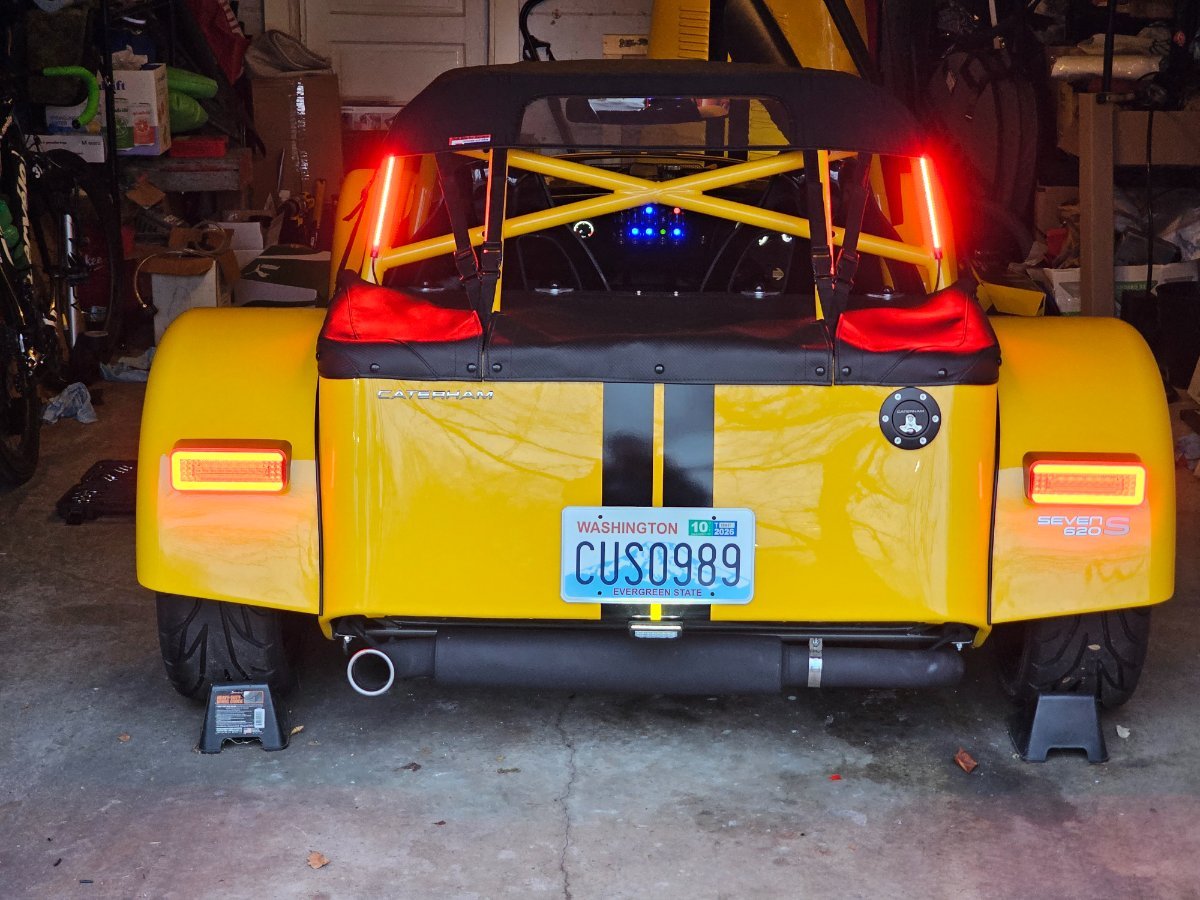

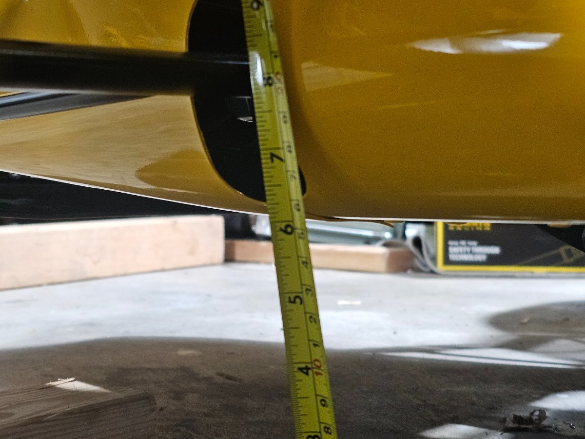

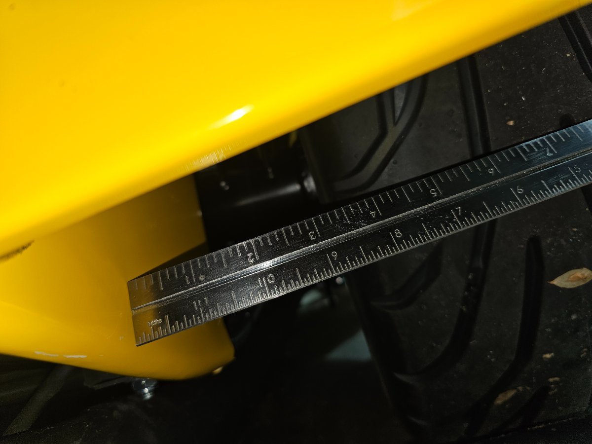

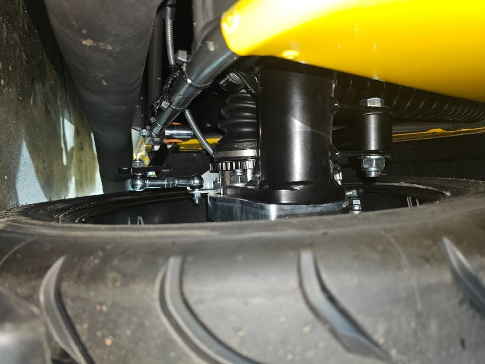

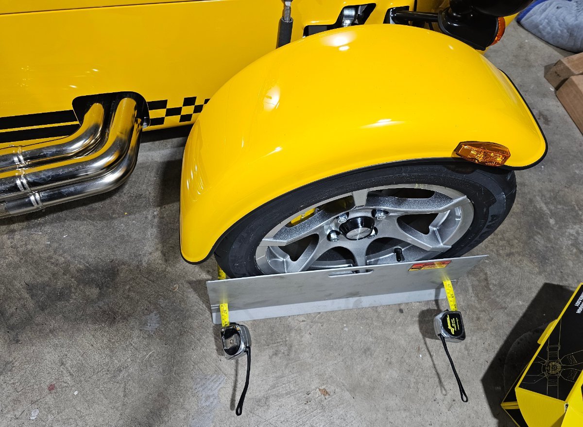

  20. My 10 mm wider tires are 15 mm wider 😂 Contacts cycle stay lightly. Otherwise fits great, easy to mount. Should I: 1) shim the cycle stay towards center of car? 2) shim cycle stays up? 3) shim both directions? 4) bend the cycle stay? I'm not sure what the cycle stay holes look like since these were installed already when I received the car. Rears fit as anticipated, slightly more than a 1 finger gap between trailing arm and tire. No the stands are not under the exhaust although it really appears as such! Vs Old
  21. Front hub bore is 58.3 mm Orcus wheels are around 63 ish, caliper didn't really fit in there. Will take a center cap off at some point. Amazon link to calipers

  23. Based on tire section width differences of the conti extreme contact force in 205/50 and avon zzs in 195/50, the 10 mm clearance should change to ~5 mm clearance to the inside stay. MCS are motion control suspension out of Atlanta: https://www.motioncontrolsuspension.com/buyers-guide/3-way/
