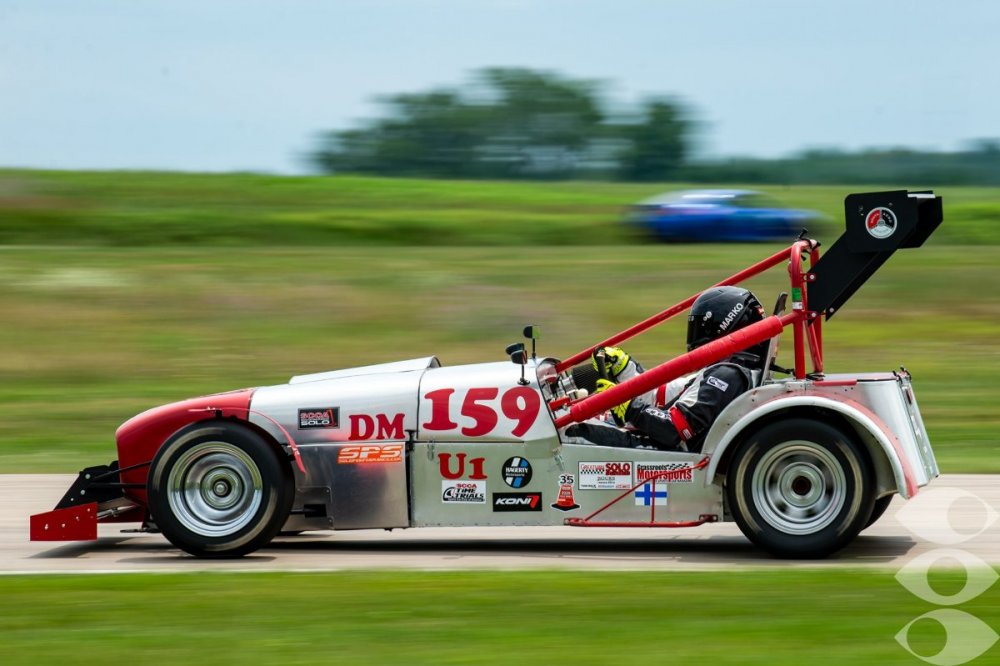

  3. Getting too old to run at 10/10th in this car on road circuits. Time to let it go. Car has no title. This is purpose built race car and not a show car. It would be difficult to convert for street use. It is a single-seater with the ATL fuel cell in the passenger side. Very well balanced and easy to setup for cross weight. I never put it on a dyno it but it is quick for a 1.4 liter car and handles well at the limit. The car can run in SCCA D Modified autocross or Time Trials Unlimited 1 (or Unlimited 2 with adding 200lbs of lead weight) Car weighs around 1370 lbs without driver. Stock GM Ecotec 1.4 Turbo motor, E-85 stand alone race tune with matched 60lb injectors by Jerry at Bad News Racing using HP Tuners (software licenses and HP Tuners OBD II computer interface cable comes with the car). Car has potential to go faster with some minor engine mods like better valve springs to rev to 7K+? rpm. Limiter is 6,200 rpm now. Very reliable drive train for a weekend of fun. It has fixed seating for a 5'10" driver weighing 200 lbs. Very low cost on consumables to run a season. Just add fuel, fresh tires then go have fun. Hagerty insured the car for off-track at $25K declared for value for less than $180/year. Easy to tow with mid size SUV. Located near South Bend, IN. Asking $17,800.00. and includes trailer and everything listed below. Chassis · Custom scratch built “Locost Book” sized Mig welded · 1” 16ga mild steel square and round tube with 16ga stitch welded floor and various extra strengthening tubes. · 1½” .095 wall DOM Seamless Roll hoop front and rear integrated into frame per SCCA Solo rules and SCCA GCR rules · Two 2” x ¼” steel drive shaft hoops (required for Modified SCCA rules) · Completed bare frame is 240 lbs and pretty stiff. · Total Weight with Fuel (less driver) about 1,370 lbs. Body · Handmade .040 half hard aluminum sheet panels · Nose cone fiberglass S2 reproduction · 10” Front cycle fenders · Rear Impact resistant plastic with aluminum radius lip · Dash Gauge Plate 1/8” 5052 aluminum plate · Single element adjustable aluminum rear wing Suspension · Front lower strut type with spherical bearing mounts to chassis and upright (Asphalt stock car type design) · Front upper wishbone swedge tubes with spherical bearing mounts to chassis and std ball joint to upright. (Asphalt stock car type design) · Forged Aluminum Legends Race Car uprights · Front coilover aluminum single adjustable shocks · Rear custom 3 link trailing arm live axle with swedge tubes, panhard bar and spherical bearing mounts to chassis · Rear coilover aluminum single adjustable shocks · Aluminum Real 2 piece race wheels custom offset 13” x 10” rear and 13” x 9” front · Race slick tires rear 22” x 10” x 13”, front 20.5” x 8” x 13” Driveline · 2013 GM Ecotec 1.4 Liter Turbo stock internals motor with less than 12,000 miles on original motor. · Bad News Racing stand-alone E-85 fuel tune with factory ECM · 60lb matched BNR fuel injectors. · Custom wiring harness by Engine Wiring · MSD coil pack · Stainless Cat-less down pipe with straight through 2-1/2” exhaust. · Cooling Honda Civic 3 core radiator with manual electric Spal fan · VW Intercooler with electric fan · Cold air Intake · Tremec T5-Z 5spd transmission purchased new in 2022 with modified Sebring .81 ratio 5th Gear. · 5.0 Short throw shifter. · Aluminum flywheel with custom 4 puck solid disk racing clutch and pressure plate by South Bend Clutch · Custom driveshaft fabricated by Action Machine, South Bend, IN · 1982 Mazda RX-7 GSL live axle with LSD, 3.90 ratio Steering · Coleman 2.5 quick ratio manual rack & pinion and spherical bearing tie rods. · Speedway Collapsible steering column · OMP racing steering wheel with quick mount. Brakes · Front: Wilwood Legends stock car type vented scalloped solid disc with forged aluminum INEX Wilwood calipers. · Rear: Mazda RX-7 stock disc · Dual Wilwood master cylinders with remote cockpit adjustable balance bar. · Neal CNC pedals · Combined Nylon and braided steel lines · Hawk Pads Ignition/Fuel · MSD Coil Pack · AEM high capacity electric fuel pump with high capacity filters and fuel pressure regulator · 8-gallon ATI steel can racing SFI rated SCCA approved fuel cell · Battery mounted in boot · Factory GM ECM and 8 circuit basic electrical harness and fusebox Safety/Interior · Kirkey aluminum race seat with fixed welded mounts (non adjustable for 5’-10”, 200lb driver) · 5-point SFI harness with camlock · Pro Comp mechanical boost gauge and mechanical oil pressure gauge and water-resistant switches & Master safety switch · BC type 2.5lb Fire extinguisher and mount · Two .25” x2” steel driveline hoops & SFI Flexible safety blanket/scattersheild · Passed SCCA Tech for Time Trials 2021 to 2024. Other Goodies · Open deck single axle tilt trailer with removable tire rack, aluminum ramps, wireless winch and battery case. HP Tuners licensed software and MPVI OBD II computer cable interface included · Additional set of Diamond Racing steel racing wheels with Continental Race Rain compound tires with good tread. · Full 4 volume set of GM Service Manuals for 2013 Ecotec (priceless) · Boost Pressure leak testing kit, two 5-gallon race fuel cans

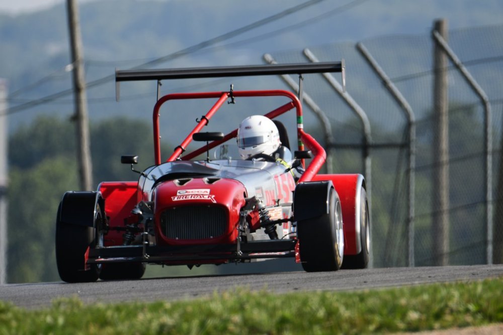

  4. Ready to run TT again this year. Minor updates. Pic from Mid Ohio last year.

  11. Time for an update. I made a MkII version with a Chevy Ecotec Turbo 1.4L mated to a Borg Warner T-5R. Still using the Mazda LSD from the original RX-7. Pretty quick. The aero helps. http://www.usa7s.net/vb/attachment.php?attachmentid=15566&stc=1http://www.usa7s.net/vb/attachment.php?attachmentid=15567&stc=1
