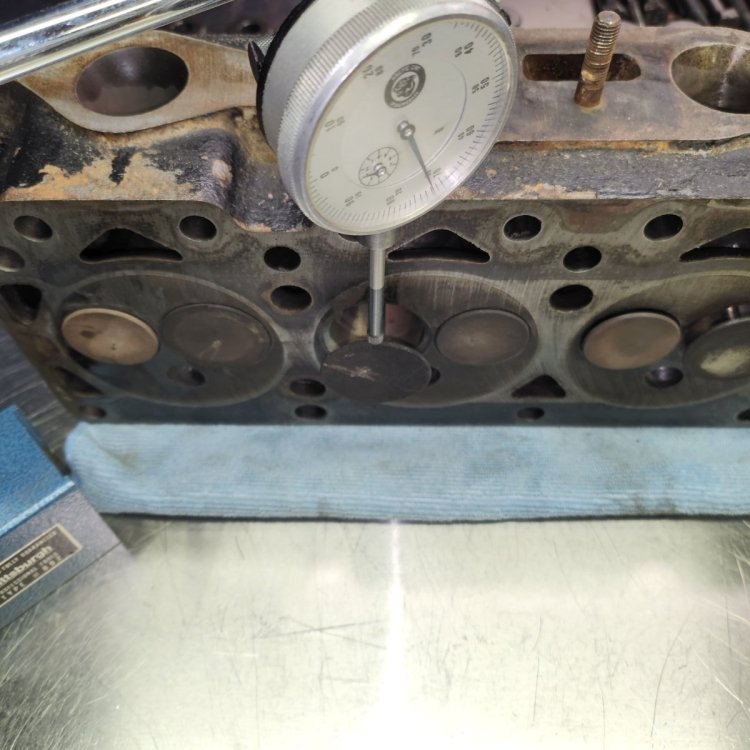

rdhunt1 Posted March 4, 2023 Author Posted March 4, 2023 After a few crappy years I am back at the 7 and loving every second. It started with what I thought was a valve tick that was too loud. Clearances fine cold. Fine hot. Knowing full well I wouldn't be satisfied till I knew what it was, the head came off. #3 valve guide had way to much clearance. Roughly .073" at the head of the valve as shown in the pic. Everything else... about .003".

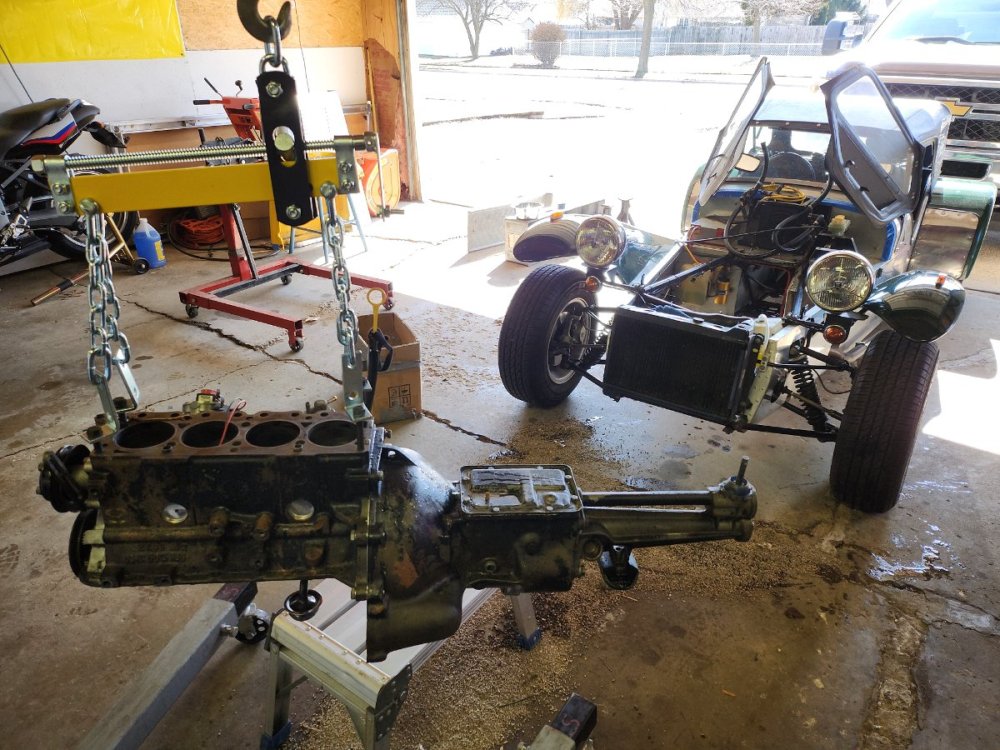

rdhunt1 Posted March 4, 2023 Author Posted March 4, 2023 New guides arrived, head at the machine shop. Since the head was going to be stripped and painted.....

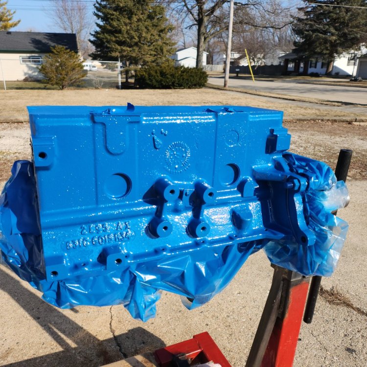

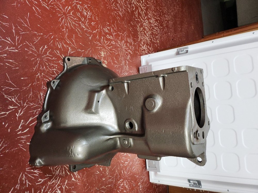

rdhunt1 Posted March 4, 2023 Author Posted March 4, 2023 So here we are a week later!! Really glad I pulled and disassembled the trans. The amount of play in the input bearing was excessive! The races look fine but side to side play is bordering on extreme. The output shaft bearing is garbage! The inner race is badly galled all the way around. Likely been this way since I got it. Can't wait to hear the difference in sound! New u joints since I am in this far, as well as all seals and gaskets. 'Old Ford blue' for the engine. 'Cast iron' for the trans housing. Huge improvement!!

rdhunt1 Posted March 5, 2023 Author Posted March 5, 2023 23 hours ago, IamScotticus said: AX block, lucky you! Love project threads. Exactly! At 16k miles the bores are excellent. Crosshatch still very visible as I would expect. Pulled a piston to check wear and any ringland issues but they still look new. Thought about aftermarket pistons just because but didn't. Lots of parts from burtons. They have gotten them to my door here in Wisconsin in about 5 days each order. Extremely fast service. Stripped the oil pan last night as it will be going ford blue as well. New main seals installed, and i like seeing that they both have been upgraded to dual lip seals. Cometic front and rear gaskets appear to be very nice rubber over aluminum. I did make a new bellhousing to tailshaft gasket. The burton part is just like oem and is like a thin brown paper bag. While I know this is common ( my 67 Enfield has some) I am going for reliably leak free. The oem gasket is .006" and my thinnest good quality material is .018". I can't find any instance where the additional .012" will be an issue. The tolerances of the whole trans just aren't that tight! ARP bolts on the rods...just cuz i can, and when I did the diff years back I found the carrier bolts were stretching and wouldn't torque properly. ARP studs also replacing the head bolts. 1
