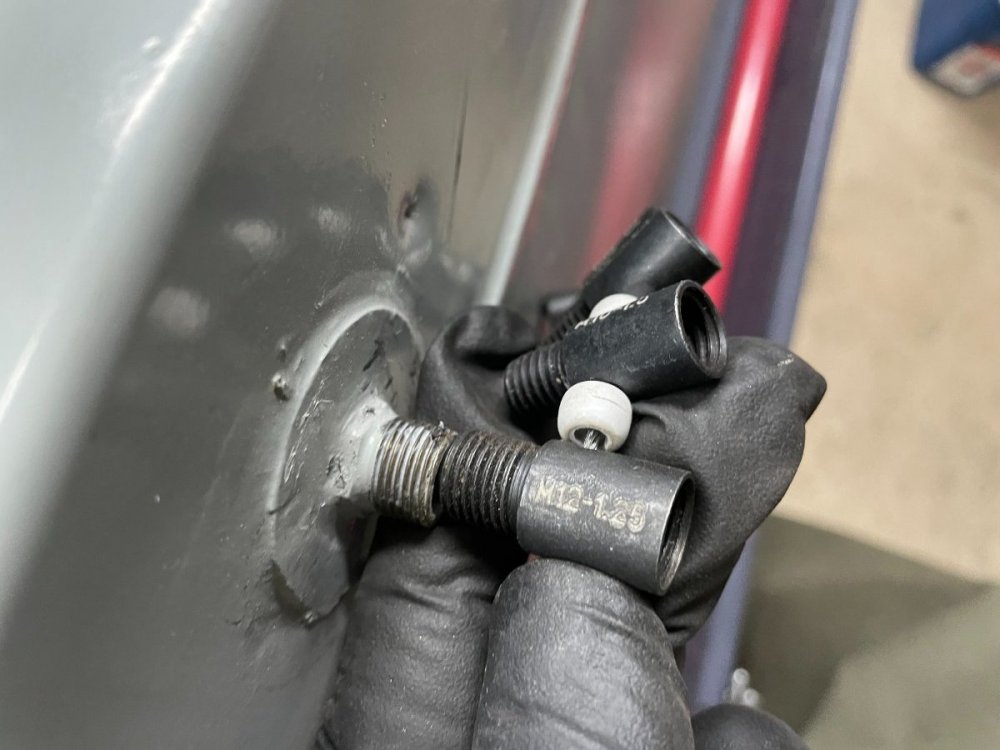

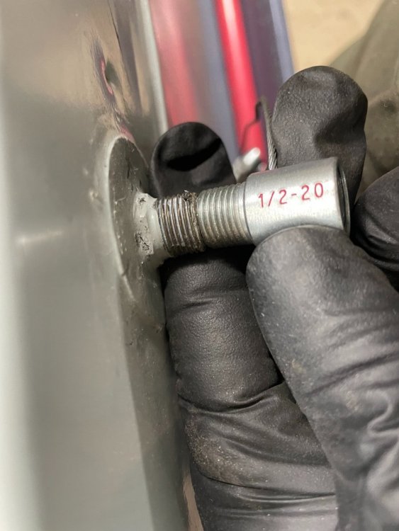

Does anyone know the thread spec for the Series 2 gas tank vent?  I checked with Ken at Dave Bean and his research indicated it was not BSP or Whitworth and I confirmed that it was not SAE or Metric. What else could it be? We are stumped!

Comparing it to the 1/2-20 in the photo, it looks like it could be 1/2-28 which is a UNEF size.  Do you have a thread pitch tool for that thread size you could compare? Perhaps a 1/4-28?

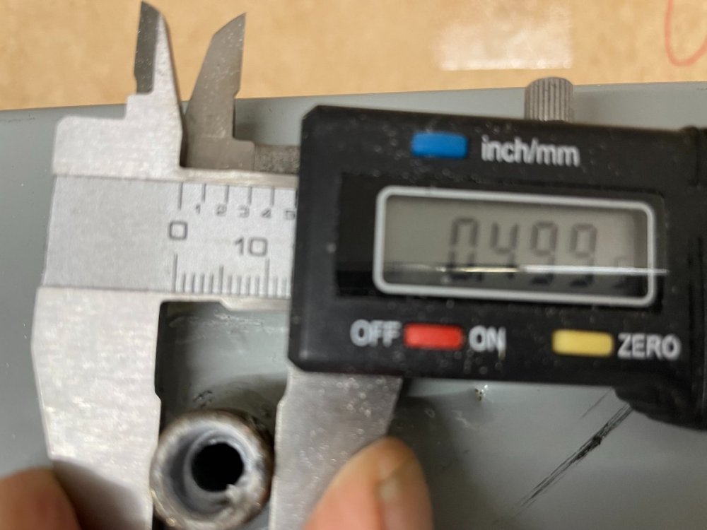

As John said, it appears to be a finer thread pitch than the 1/2-20.  You should be able to calculate tpi with measurements - and if you can measure the angle of the thread event better as there are several resources for identifying fittings with this information.  www.britishfasteners.com is one I use.  British Standard Brass is 1/2-26, so that is a possibility if this is an original Serck fuel tank.

Thank you, guys! We are getting closer to an answer! I don't have a tread pitch gage but here is a 1/4"-28 for comparison. the fitting could very well be a 1/2 x 26.

I now have a thread gage and the threads do measure 26 TPI.  The fitting matches the British Standard Brass (BSB) 1/2-26 size. Fitting of this size are apparently no longer available. Taps and dies are still available but under the circumstances I think that I will just use 7/16" ID gas hose with a hose clamp.   Incidentally www.britishfasteners.com is an excellent source of info. Thanks for all the help!
