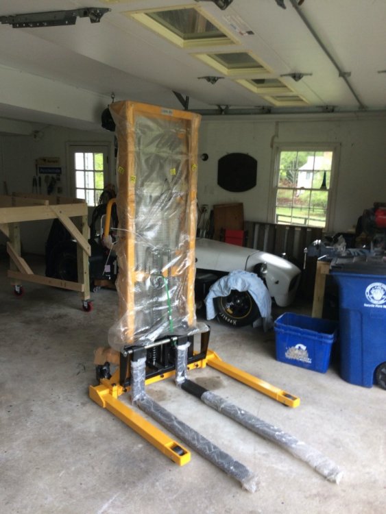

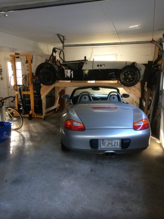

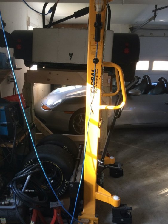

fmorser Posted March 2, 2022 Posted March 2, 2022 After I became so discouraged with rules and regulations and you can't do this and can't do that w/r/t adding a shed/garage to free up space in my current garage and then on top of it I had to do a land survey to get necessary permits and that would cost over $2,000 I built a rack out of 2x8 lumber with 4x4 posts on wheels too and then bought a 2,500 lb rated pallet jack and that solved my limited space issue. Very low ceilings and so had to measure and measure again, but it all fits. Opened up a lot of space for my next car build, and I got a new compound sliding mitre saw out of it too. Been away so long I hardly knew the place.......from the forum that is and saw this thread so added my 2 cents. Pallet jack takes about 50 pumps......good for the abs.......to get the car up high enough and everything rolls around so I can customize my set up. Car only weighs 1,050 lbs. (bike engine for those who remember) so my jack/rack requirements were less than many of you I suspect. Anyway that was my solution.
